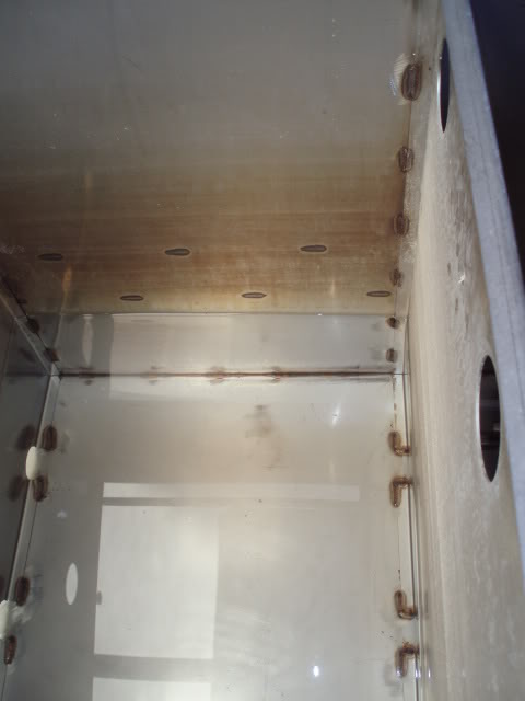

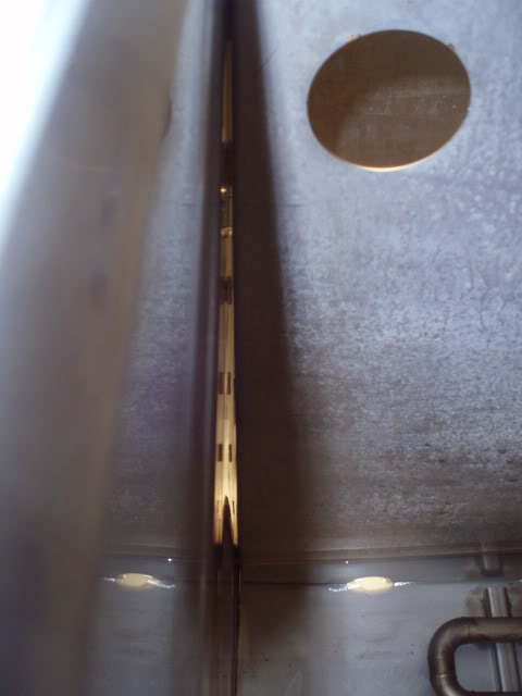

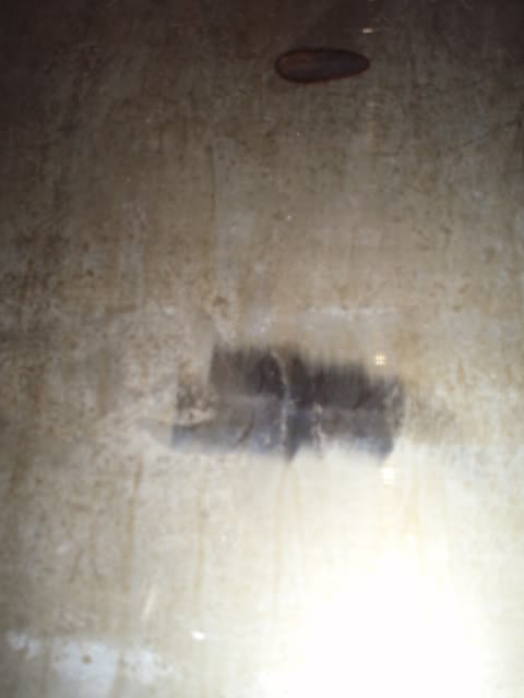

After 4 years It developed a fresh tank drip.
See the crack?
I can't either, but its there
Both my baffle walls fell over in the first year on my Aero Tech built tank. I had a local welder re tack them in. the sides worked loose but the top and bottom welds are holding. AT had nothing on the bottom holding the walls down. :shock:

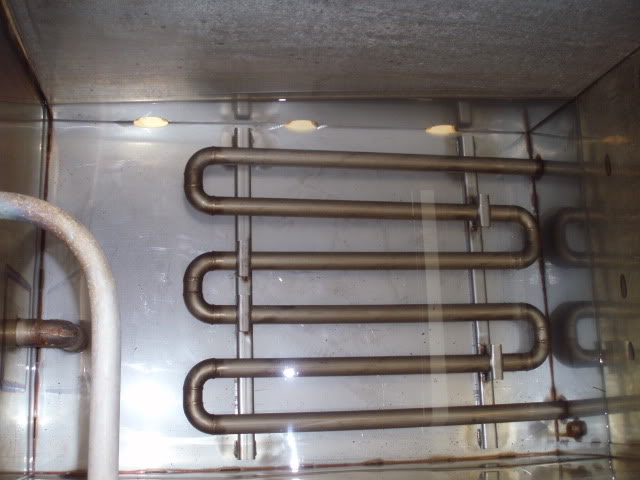

HX pipe from the radiator

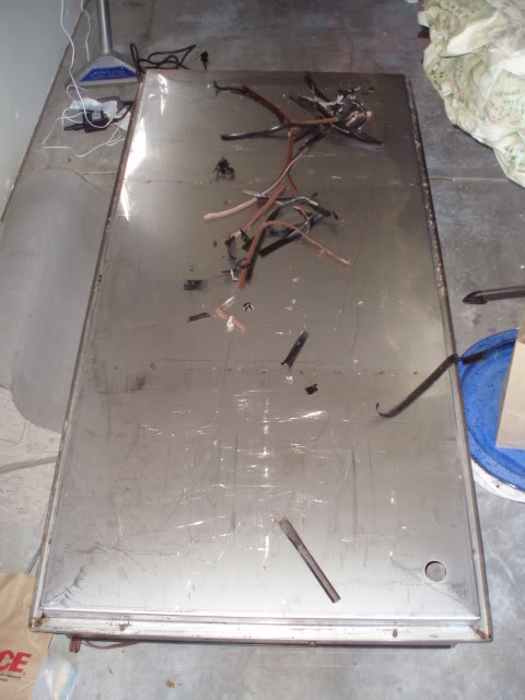

Redoing the lid gasket while I'm in there.

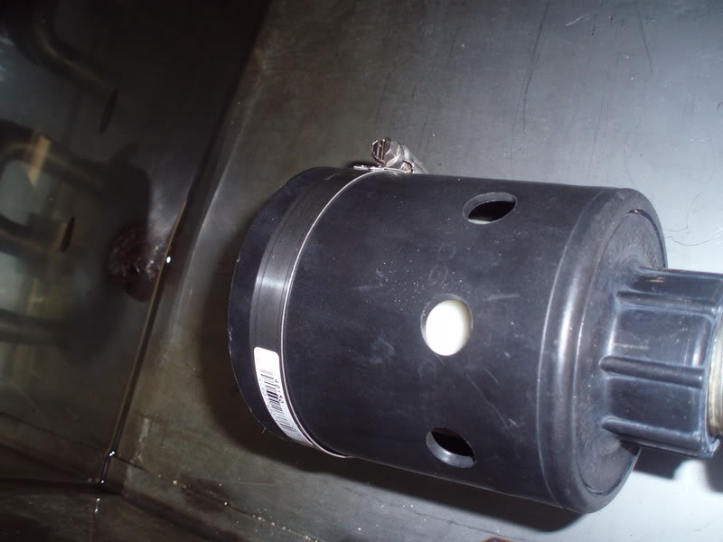

The plastic Hudson looks like a winner from a stability point. Mike, what causes them to "oblong"? Just the hot water in general?
116,370
Yep, the outer black shell cant take it for more than a few months.
Even the stock pvc pipe that attached to it oblonged like mad.
