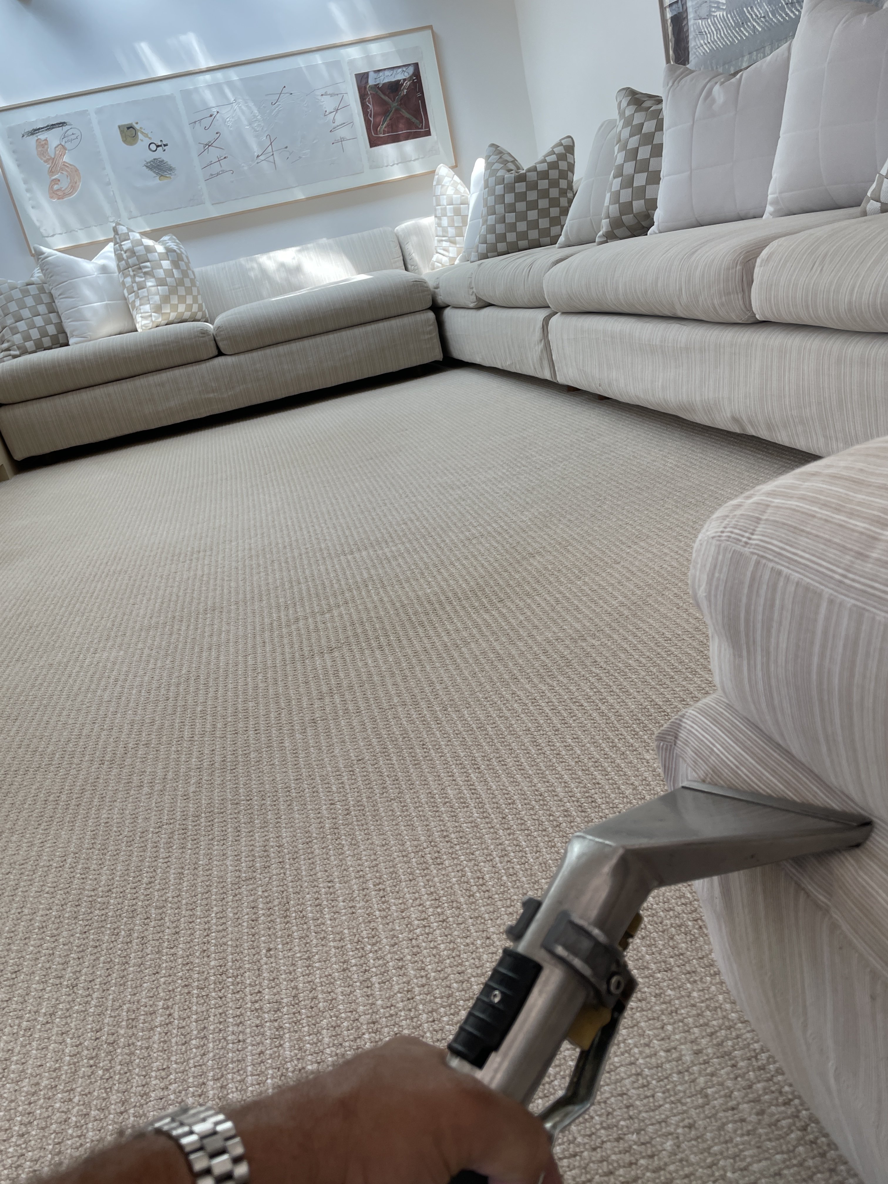

Wall to wall isn't persian or oriental rug. It's tough. No need to turn the heat off, but there's no need for max heat also, so turn the heat to medium. If it's wall to wall wool, it's probably not in bad shape, so a ph of 8-10 is ok. I don't see a need for high ph traffic lane treatments, unless it's neglected.
You know how to rinse, so just wand it out.

I always prepare the cusomer for the worst (stains that would come out on nylon, may not with wool warning), and hope for the best. If the customer rolls with that its a go. If they are asking things like " its not gonna make it worse right?", then I start talking my way out of the job. Greenglide for sure, and I will use 3 or 4 fans in one room to dry as I go.

PCQJ w/ Glide was the ticket. Tried the Mach 15 but the "tank" got to stay in that game. Super EZ.
