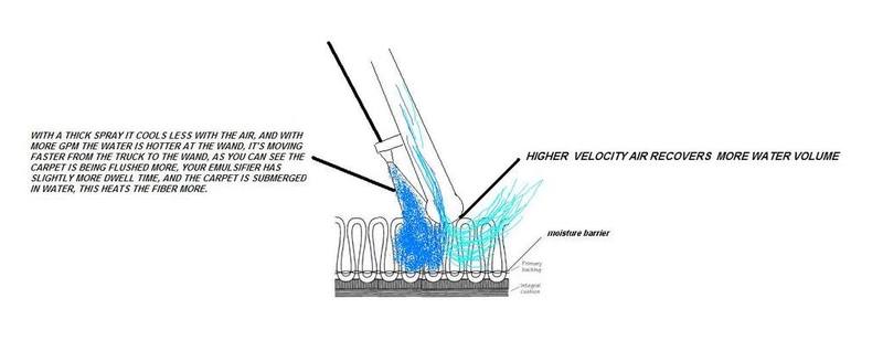

48 flow @2,000psi!!!! No, seriously...the idea is to have the spray point toward the lips of the wand. On CGD it should strike ideally at 60% on the carpet 40% on the glide. On a cut pile it would be striking fully on the carpet. This is an area with a lot of misunderstanding and misconceptions.
Some wands cannot be adjusted and, as much as possible, the glides on these wands are modified to allow for and correct flaws of wand design.
The old-fashioned notion of jets pointing straight down at the carpet is counter to efficiency of cleaning and extraction. Pushing the dirt and water deeper into the carpet (or even the backing) is placing them where it is more difficult for the wand to remove them, though it "looks" better for the time being. It is much more efficient to push the dirt and water to the lips of the wand where they can be more easily extracted.
HOWEVER there are limits to this. A horizontal spray pattern, though easy to extract, would not penetrate the fibers to remove deeply embedded soils efficiently, so there is an ideal angle. 60-40 on the wand lips or glide on commercial pile seems to be the most efficient spot, and this angle, though appearing different on cut piles works for them as well...spraying through the fibers toward the lips of the wand.

The water only touches the glide/lips on CGD, on cut pile it strikes behind the glide/lips. Any water hitting the glide/lips is still flowing through the carpet before sucking into the slot/glide because the wand is in full contact with the carpet. It cannot flow around the glide and into the slot without going through the carpet first.
Some wands cannot be adjusted, so on these wands, we must do the best we can to come as close to that as possible.
By moving the angle of the jets, you can now safely flow more water and higher pressures without fear of under-drying the carpets, leaving pressure distortion marks, or wetting the backing, getting a better one pass clean.

Yes, because the water is being directed where it needs to go (the wand lips) not deeper into the carpet and possibly the backing where removal is more difficult and less efficient.
I would also argue your assumption that direct impact from above, at the same flow and pressure is cleaning better than at an angle to the fiber. Direct impact from above is simply pushing the water and soil deeper (where you might not see them as well), not removing them better. ALSO impact directly on the tip of the fiber makes the fiber much more susceptible to damage from pressure marking/tip blooming, and also greatly increases your chances of wetting the backing.

Jets at a 90 degree angle will penetrate the backing at a ridiculously low psi. Not only that, as Lisa said more of the soil load is available to be forced into the backing with jets at 90 deg.
