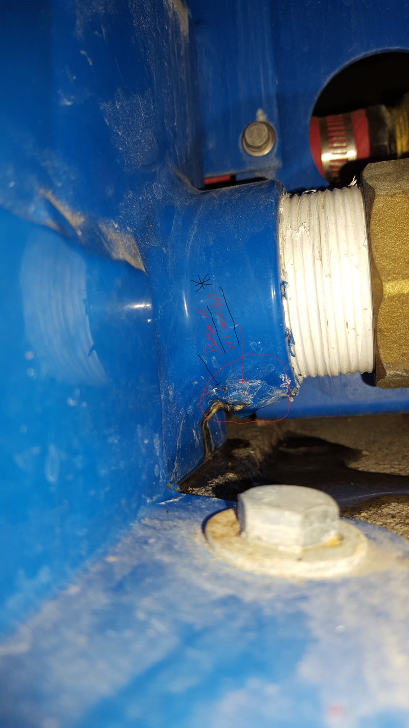

Our 2013 Hydramaster CDS unit began leaking from the "bung hole" under the waste tank discharge area. Our local service shop claims it is from corrosion in the aluminum. Seems a little odd a 4 year old unit that is well taken care of, dumped daily, and rinsed out weekly would have this kind of issue in such a short amount of time.
Anyone had this happen? We have an '08 CDS that runs day and night and never has had an issue like this. We bought 2 CDS units in 2013 and the other unit shows no sign of any corrosion. We are currently seeking to create a warranty claim, so we'll see how that goes. Sani-Bright Unit #14 Waste Tank  Bung Hole Port 072417 1 of 2.jpg
I agree 4 years on a tank I wouldn't think you'd have an issue. We've had aluminum tanks last nearly 20 years with a lot less care.
Could it be the pipe thread that goes into the tank cracked and caused corrosion? :headscratch:

Had that happen with my CDS. Not so fast. Exact same place.
Seems like a problem in design or manufacturing with their tanks to me.

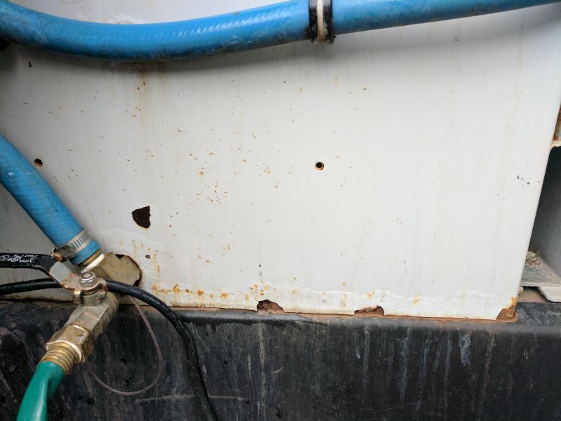

Mine started getting the first pinhole leaks around year 5, now at 9 years old there's a half dozen or so small holes that I've goobed up with jb weld

Grass ain't always greener though, this is the front of the water pond on my 18 month old pro1200. Like you it's cleaned fairly often but looks like shit for a unit less than two years old

Same thing happened to the finish on my prochem chemical rack . after 6 months was corroding wherever the slightest bit of moisture hit it. Same finish u have on that tank. Its a shame. You spend a ton of money on these things and should be able to hold up under any condition. A few months after buying, looks like crap.

In the CDS tank, its sounds more like an isolated problem with the drain outlet weld. ???

No right on the front of the water pond, my new rig with 160 hours is showing rust at the bottom also. It's very visible and looks like crap. My local interlink is looking into it
