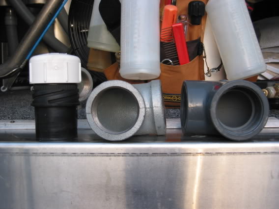

Also I noticed that you are running the plastic 90º elbows at your tank. I switched to Galvy ones due to the larger opening.

I removed the plastic elbow off the waste tank and inspected it and the pipe
nothing clean and clear............
I also noticed today that there was more water build up at the end of the wand.......
any ideas ??????
also do you think it would benefit running more ridged pipe from the waste tank to the outside hook up instead of the 2' hose and get rid of the 90's and use 45's so that it is not an abrupt turn but more of a flow./
That would also open it up more like Mikes galv fitting..
Maybe pipe it in a 2 or 2 1/2 inch ABS then drop it back to the 2' outside the truck like it is now....... ?????????????
