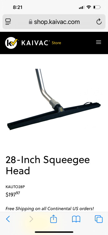

This with a Rigid wet vac is the cats ass for stripping small floors. I wouldn’t even want to get a good Mikey floor tool in that. It will swivel to even get behind toilets beloit or not.
It’s gone up a hundred since the last I bought, but it’s so worth it.

Yukon, Oklahoma
Most of the floor guys use a Tennent or Nobles or something with the squeegee on the front and push it around. When Diana was on the #truck with me, I wanted to buy one for her.😂 She nixed that real fast. She said, I don’t want to push a tank full of water around. She just used the Kiavac Squeege wand and 50’ of hose. Actually it was effortless. (says me😏)
