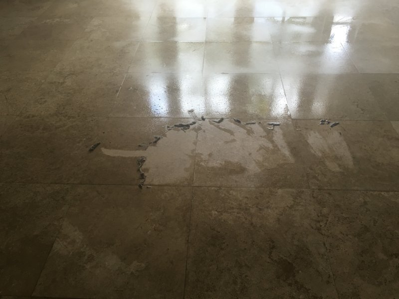

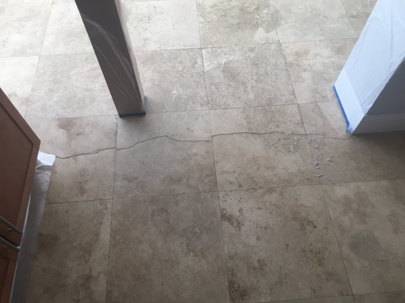

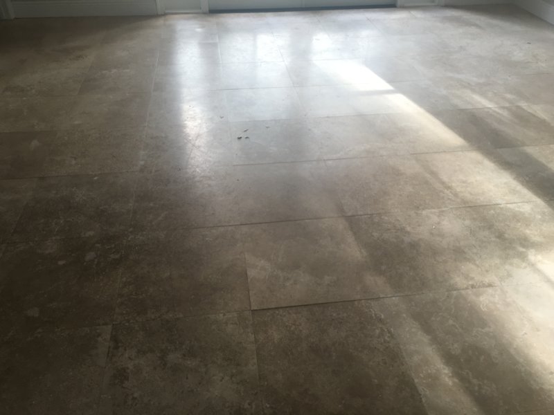

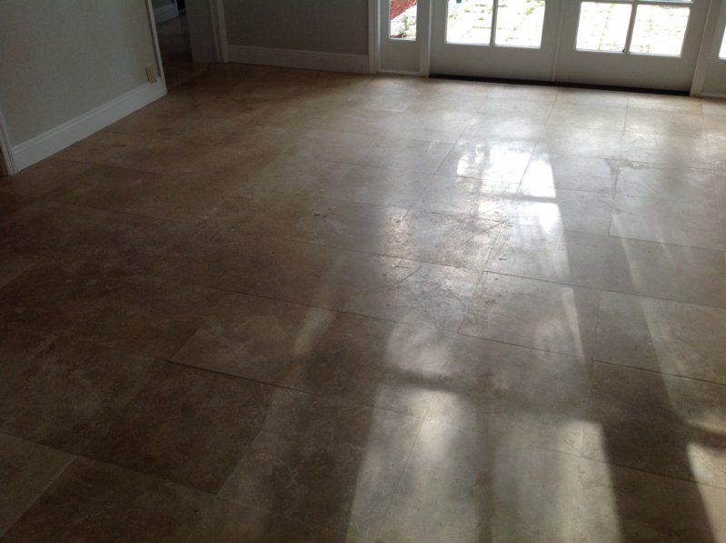

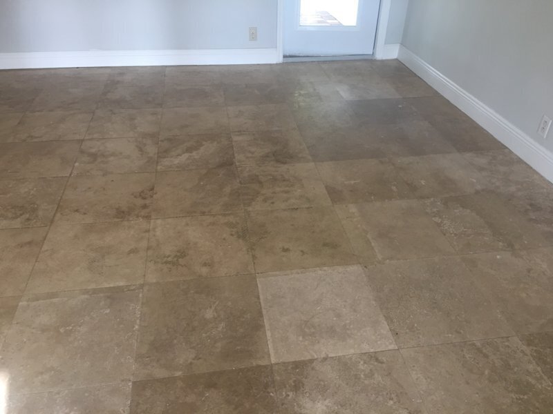

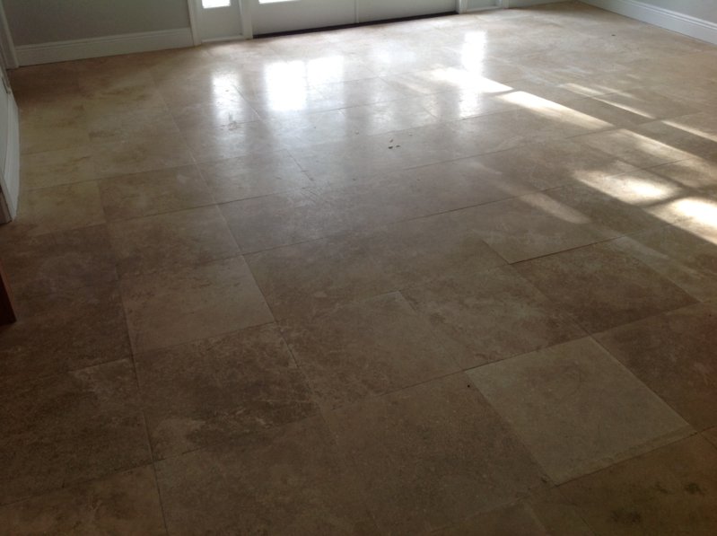

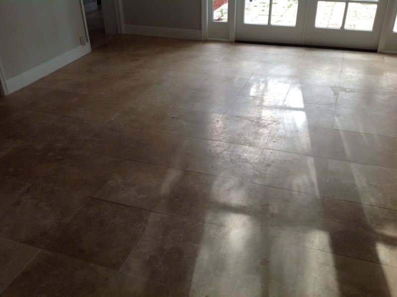

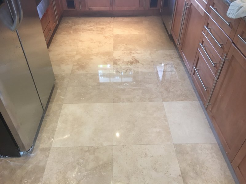

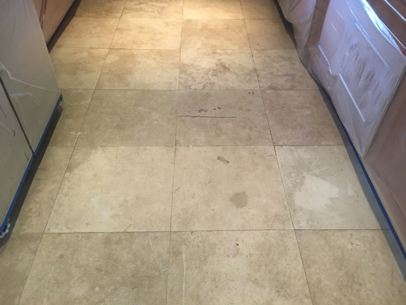

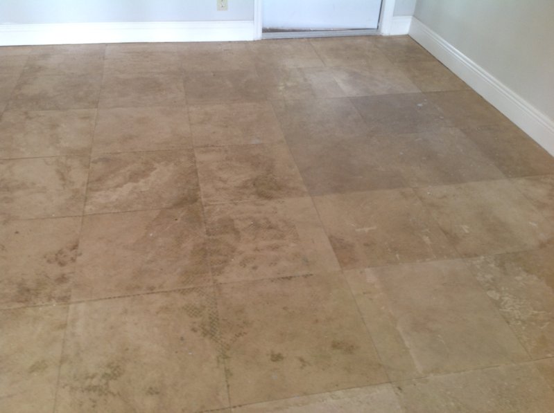

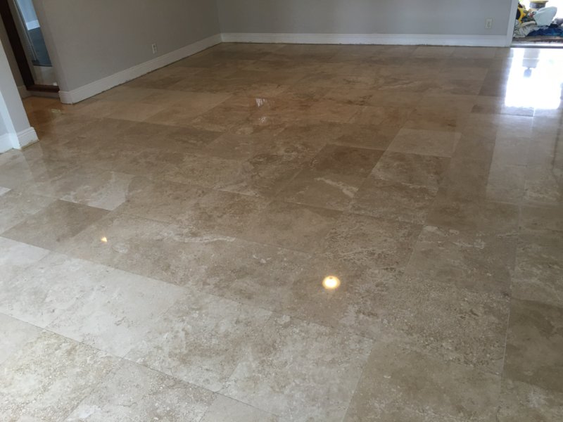

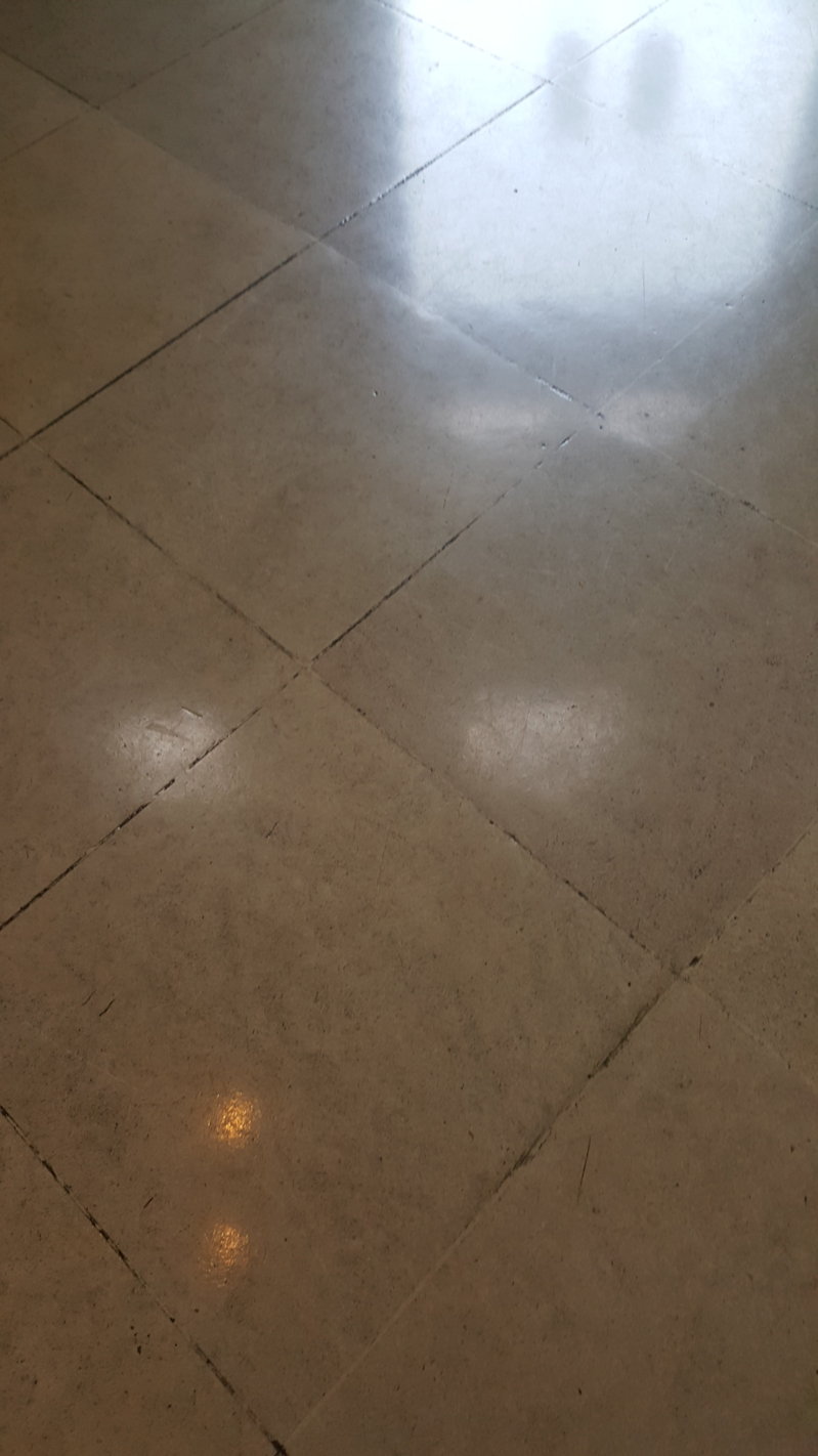

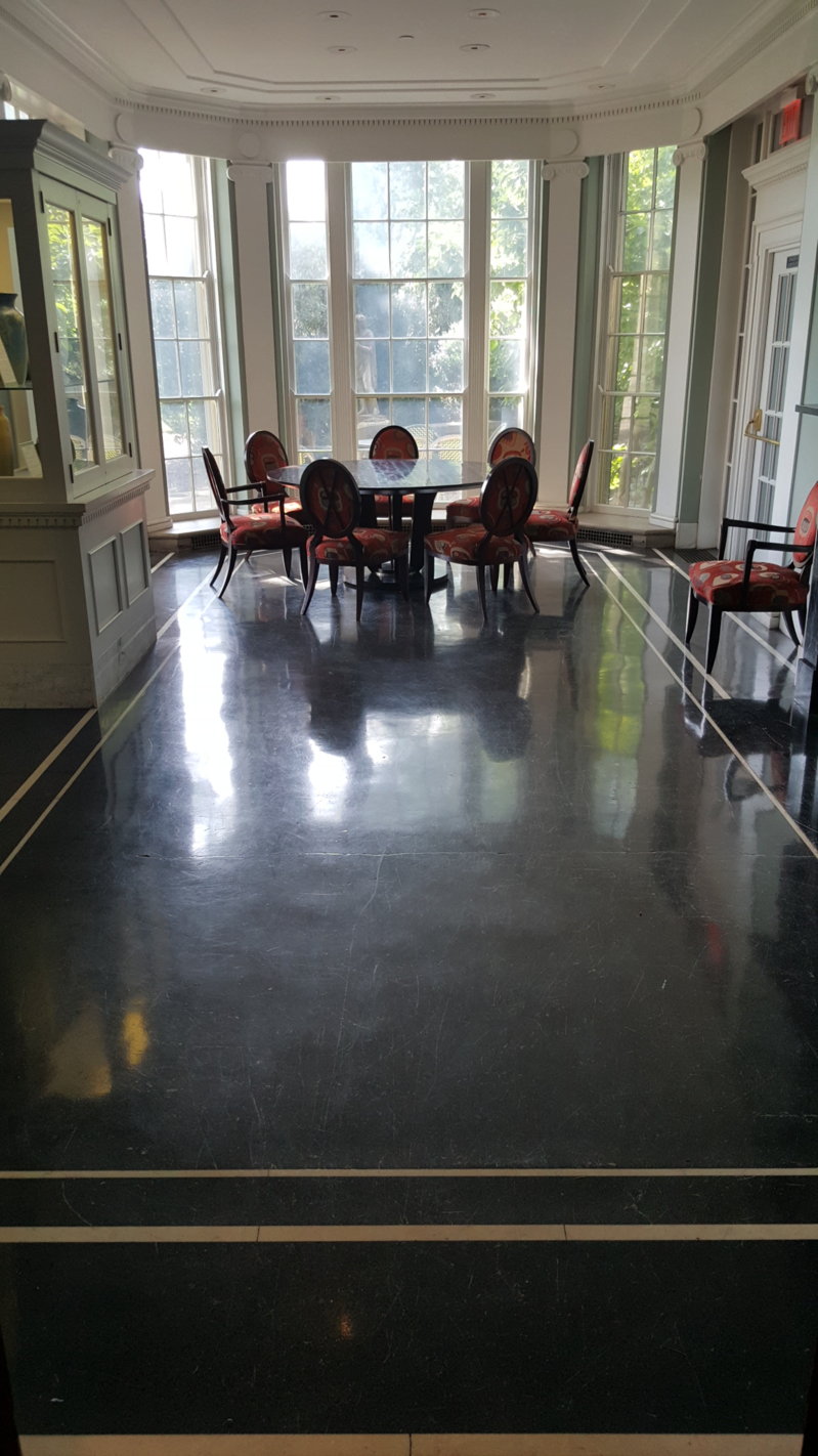

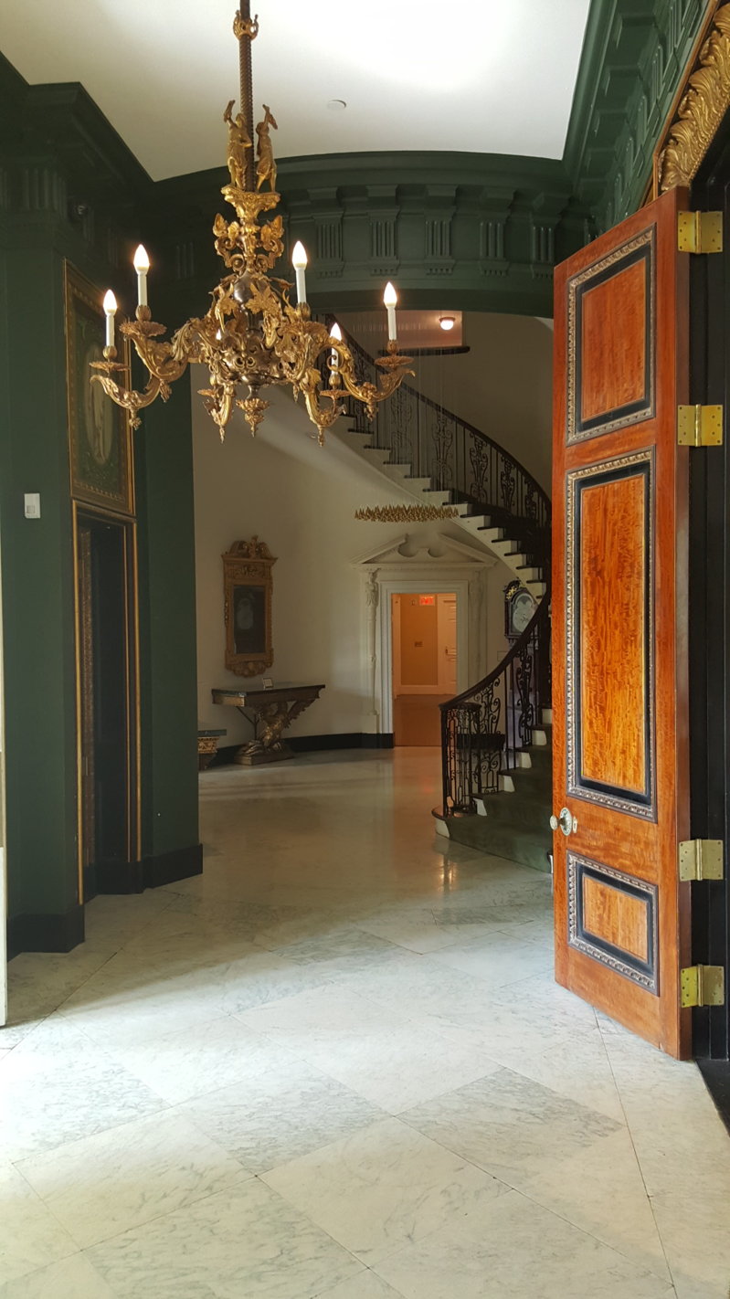

Had a floor with multiple coats of wax that had been on for years....pre soaked with stripper, used 3m pad, had to cut with 120 resin to get all the coatings off...when you're bidding a wax job double what u normally charge
