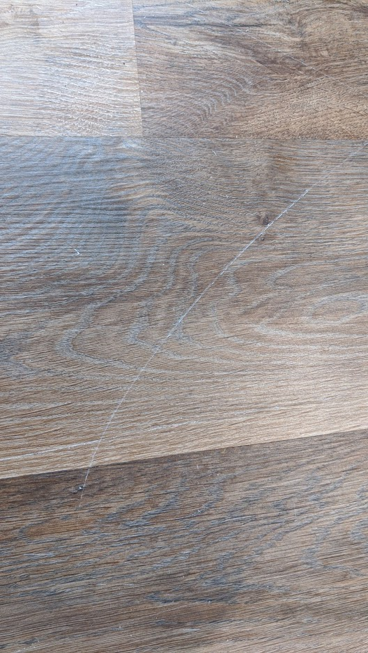

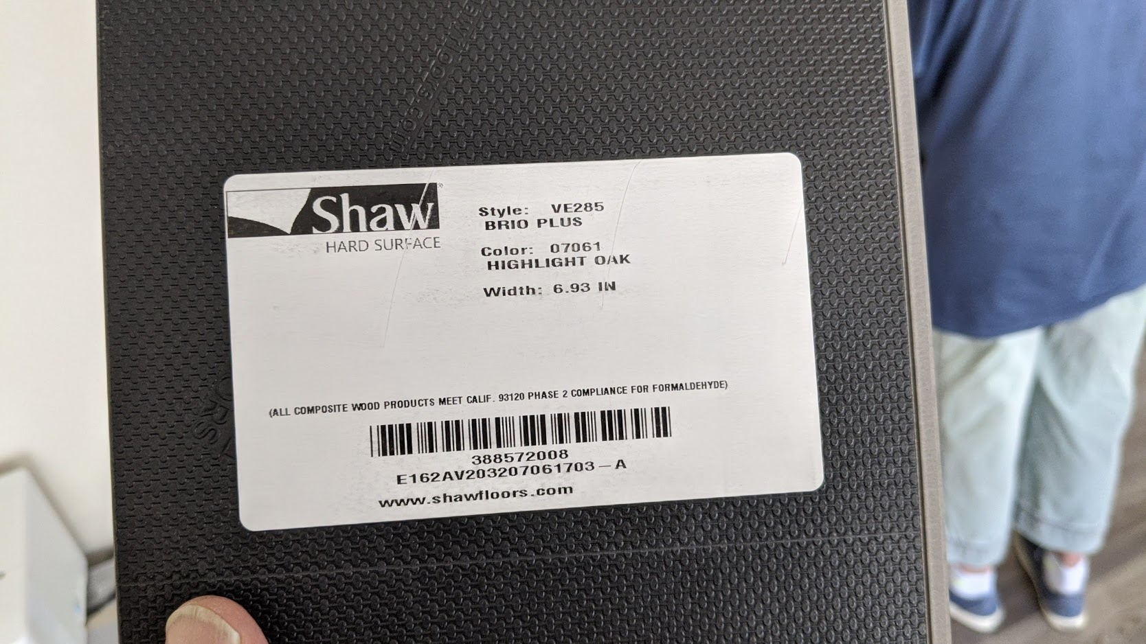

Well the day was coming...
the trackless "spurs" on my Teflon glide scratched the heck out of a brand new Vinyl Plank floor today.
I wont call it Luxury because this Shaw product is complete garbage.
I noticed the scratching going on when I went against the grain almost right away so I switched to my WP HS wand to finish the project.
Luckily I caught it quick and even luckier I was able to use 0000 steel wool to make the damage virtually invisible..
As I worked deeper into the home I discovered over a dozen scratches that the home owner says the movers caused.
Some of the scratches that made sense, others I think could be the dog's toenails or maybe a Flea Circus skidding on their roller skates....
I went next door to the model home show room to test a plank and found that it took almost no effort to create a (against the grain) scratch with the screw driver on my pocket knife. She's only been in the home for a few weeks and has a six week warranty on all surfaces. I STRONGLY suggested that she get them to change out the floor ASAP. One year from now it'll be a sight to see.
TEST TEST TEST folks!!!!
and her builders grade poly carpet already looked 6 years old.....
$340k Town House.

You get what you pay for.

100% waterproof for a beautiful, high-performing floor and features Soft Silence™ acoustical pad for noise reduction and added comfort.

CONSUMER ALERT!
Considering Luxury Vinyl Plank for your next flooring project?
Do yourself a HUGE favor and test a plank or two before you purchase it by scraping it with a key or a screwdriver across the grain to see how durable it is.
I clean a LOT of this stuff and today I ran across a product from Shaw that a Teacup Poodle could damage by chasing it's tail..
*This product has a 6 mil wear layer, if you own a large dog, a teenager, a husband, furniture with legs or have small rocks in your yard, (so virtually everyone in earth) buy a LVP product that has a 20 mil wear area...

I agree that their property shouldn’t be damaged.
We use samples for scratch tests.
Good vinyl when scratched you’ll see the material curl and pop off. Then you wipe it down you can’t see the scratch. Those are nice.

This is why I clean with the grain whenever possible and why most apartment complexes and rentals switch back to carpet.
And why I don't wand anything but carpet. Brushes on everything else.
