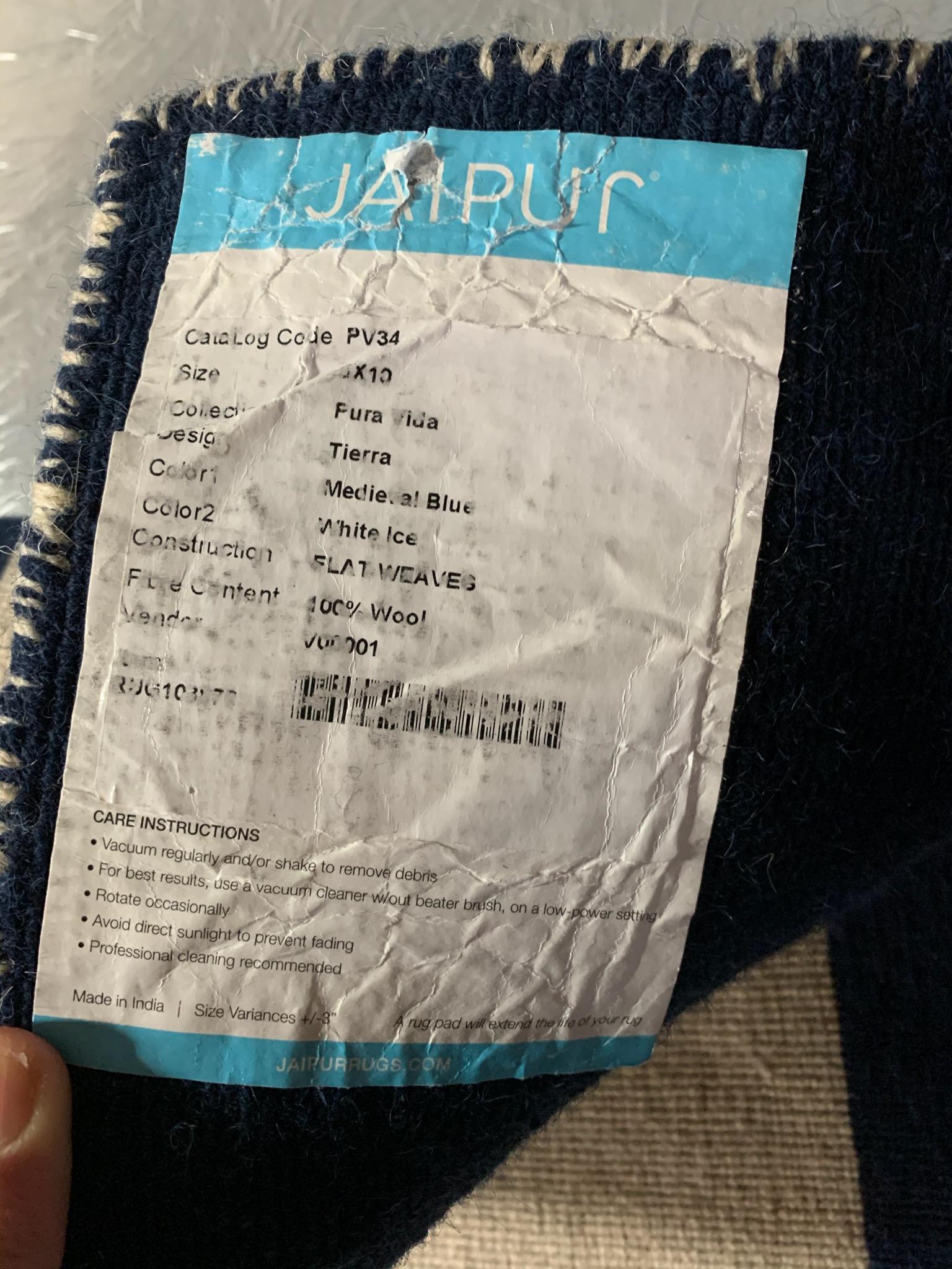

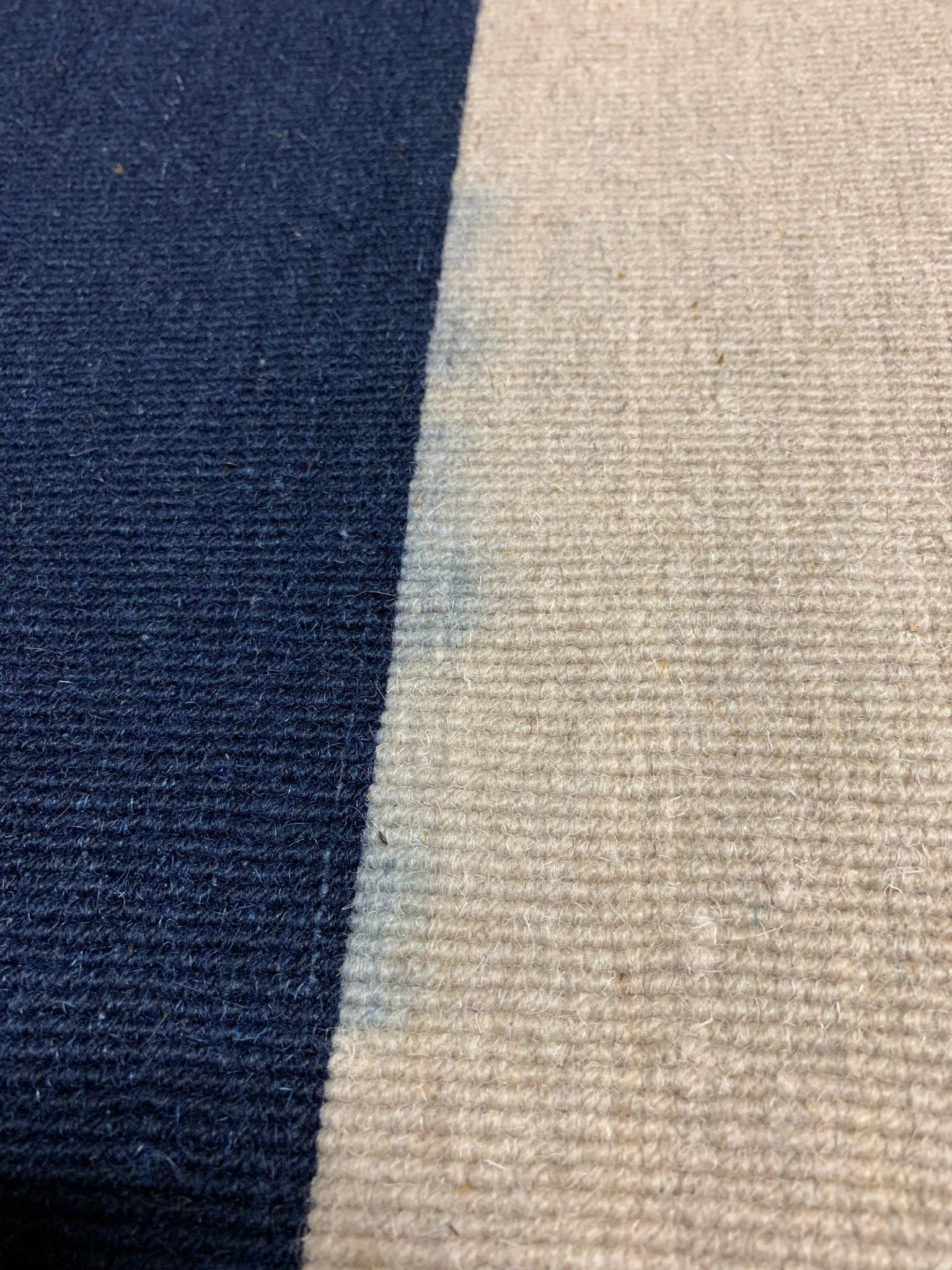

Top cleaned with Chemsepc One Earth, dried flat...
Suggestions besides sending to Lisa Wagner?
sodium bisulfite, talcum powder and patience![]()
For $58, buy them a new one and say it came out great.Striped Pura Vida Wool Rug Blue White Pura Vida Tierra
Striped Rug Flat Weave 100% Wool Medieval Blue and White Ice. Bold color is the name of the game with Pura Vida. This beautiful collection of durable, reversiblcharlotteandivy.com
whats the talcum powder for, an absorbant for fugitive dye?sodium bisulfite, talcum powder and patience![]()
A new one is $498..Send it to us. We can easily correct that.
Just return to the customer and cross fingers5 different recommendations so far.
Waiting on Hanna's
Too bad they did not follow # 5 under the care instructions!!!
yes the mix has a bit of acetic acid in it with hot water- usually takes about 3 days waiting till it dries out completely -then brush off and cool rinse - and repeat if necessary. Another option which we used with some success on fabrics, was to wet stain using a carrier such as Trich111 and then blow back with compressor into where the dye had migrated fromwhats the talcum powder for, an absorbant for fugitive dye?
