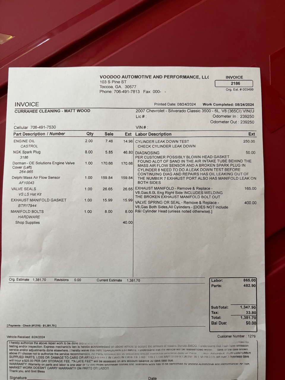

Well, I was mistaken. It's not antifreeze I'm seeing, it's motor oil being blown out the #7 cylinder showing it wet around the head. They did a test on everything and it shows that it's either coming from piston rings or a bad valve seal. The mass air flow sensor was covered in junk as well. I have no clue why, because I was religious on changing the air filter. I probably should've cleaned it when I bought the truck at 125k miles already on it.
So if it's bad piston rings, I"ll be replacing the engine. And they'll fix the valve seals if it's just that and replace the heads as well. They're doing what they call a leak down test , I think, today to get the final diagnosis. Either way, it's gonna hit my wallet hard.

A bunch of stuff was done, but replacing the engine was not needed. Only about $1300 in repairs was the cost. I’m so relieved.

nah, I knew that what they did was worth the $1381. I kept in touch with them during the diagnosis and repairs.
I'm really glad I didn't take it the first mechanic that normally does the work on this truck. Because he wouldn't have did the full diagnosis and would've just taken my inaccurate assumption of the heads leaking and I would've been
$screwed$
after the problem was sill there.
