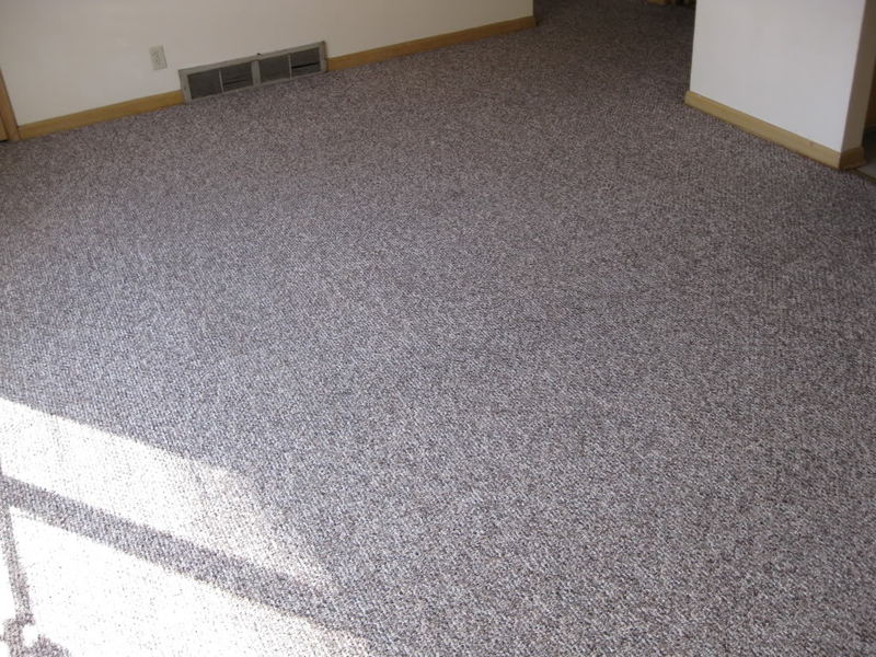

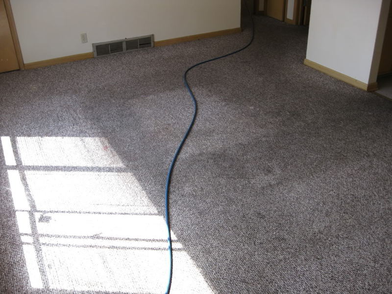

I moved my brother up here from Vegas last month. To help him start making some cash I put together a trailer with a 2100 in it that we rent out (him included if needed) He has been using it to help a local guy out with his apartments. I went out with him on Tuesday and we knocked out 21 3 bedroom apts in 6 hours (from the time the prespray went down until we turned the machine off)
I had been wanting to compare Powerstrike to Extreme Clean and boy did I get my chance. Now I will say I still love extreme clean and prefer the smell but at 12oz of powerstrike to 18 of extreme clean there was no comparrison (both had 4oz of energy added) We sprayed and sucked no pre-vac no scrub. Ran Steam Way formual A+ Set at 2gph Wand was a Prochem 4 Jet with 95015's and Slot Glide with the Steam Way breathing fire.
Here are pics (taken with my phone)of just one apartment (Just the living room) only 2 where not this bad

Powerstrike mixes easy. WAY EASY. I still love extreme clean it is my best selling powder but after this week I have to say powerstrike whooped it and thats saying alot.
George if these had been residential or at least good paying apartments I would have pre-vac'ed and scrubbed but these where student housing apartments that where bid cheap. We were helping out a customer who had to have them done and done now. He has 300+ apartments in 3 different locations that he have a 2 week turn around window. They don't want nor will pay for much more then a spray and suck. They will be expecting a bit more from him now that we performed magic on the ones we did :mrgreen: Actually he does a really good Job he runs a Steam Way 4100 and uses extreme clean and energy and runs prochem's heat wave as his emulsifier. We ran A+ Because I had a bucket that was sent on mistake and ended up with it at no charge. He has used both and really likes the heat wave. Next semester when he needs help again i'll give the heat wave a good go myself.
