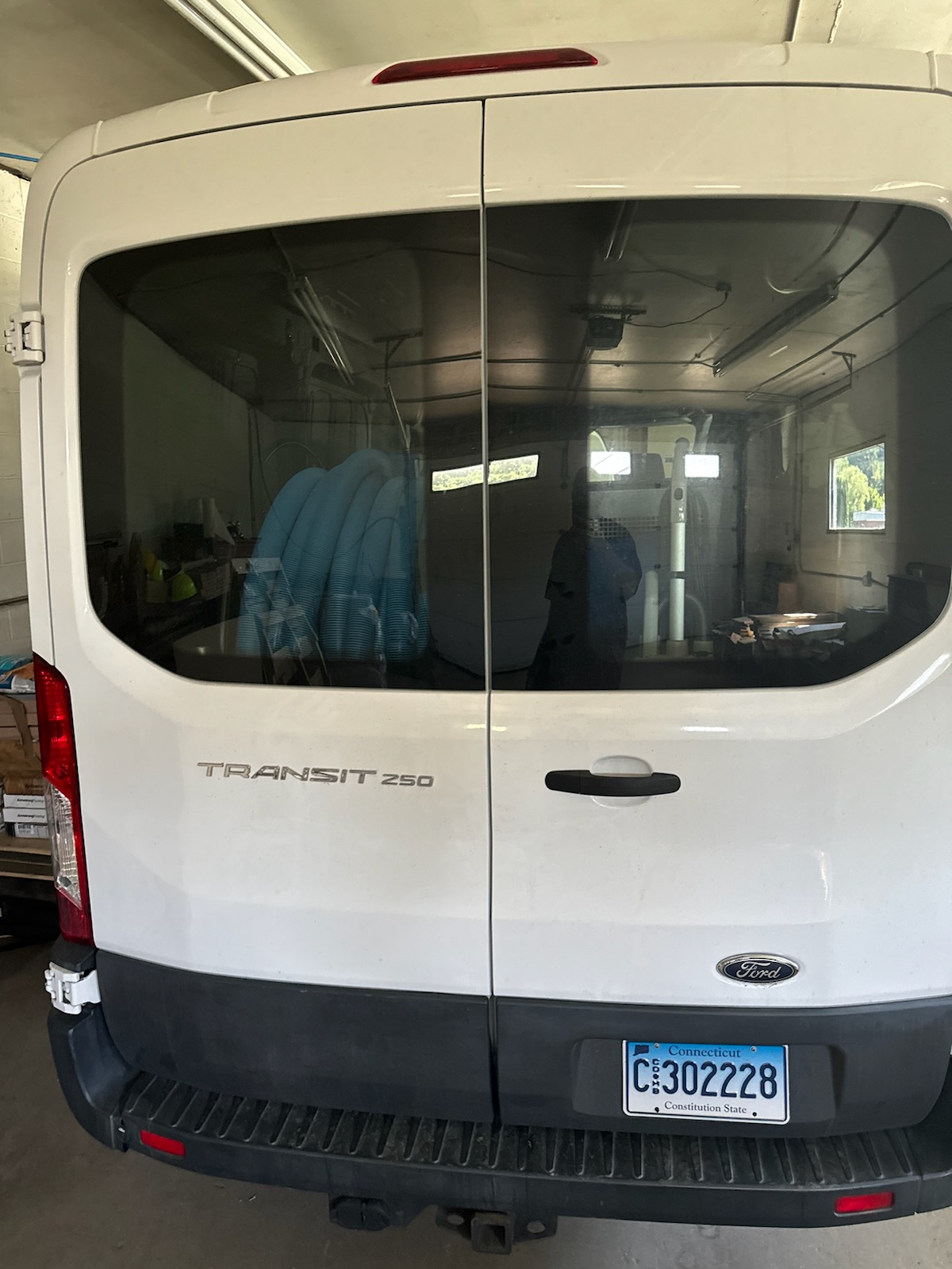

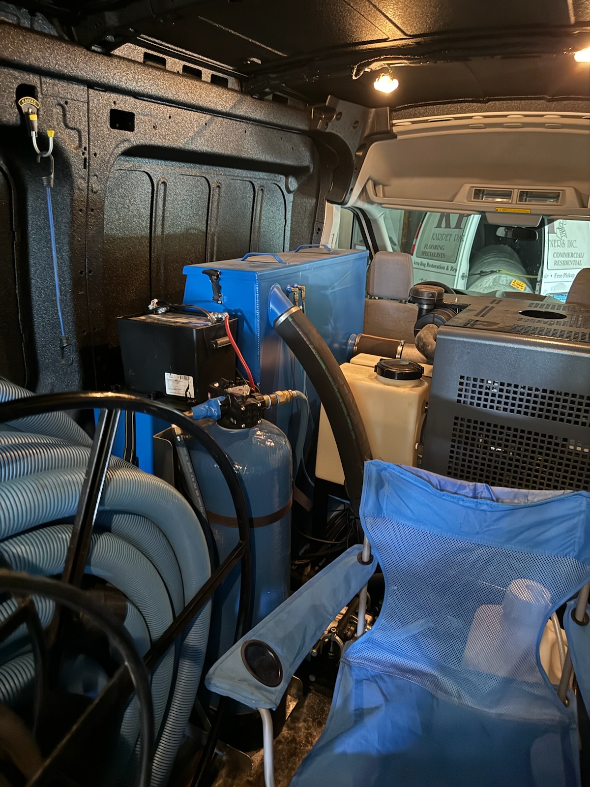

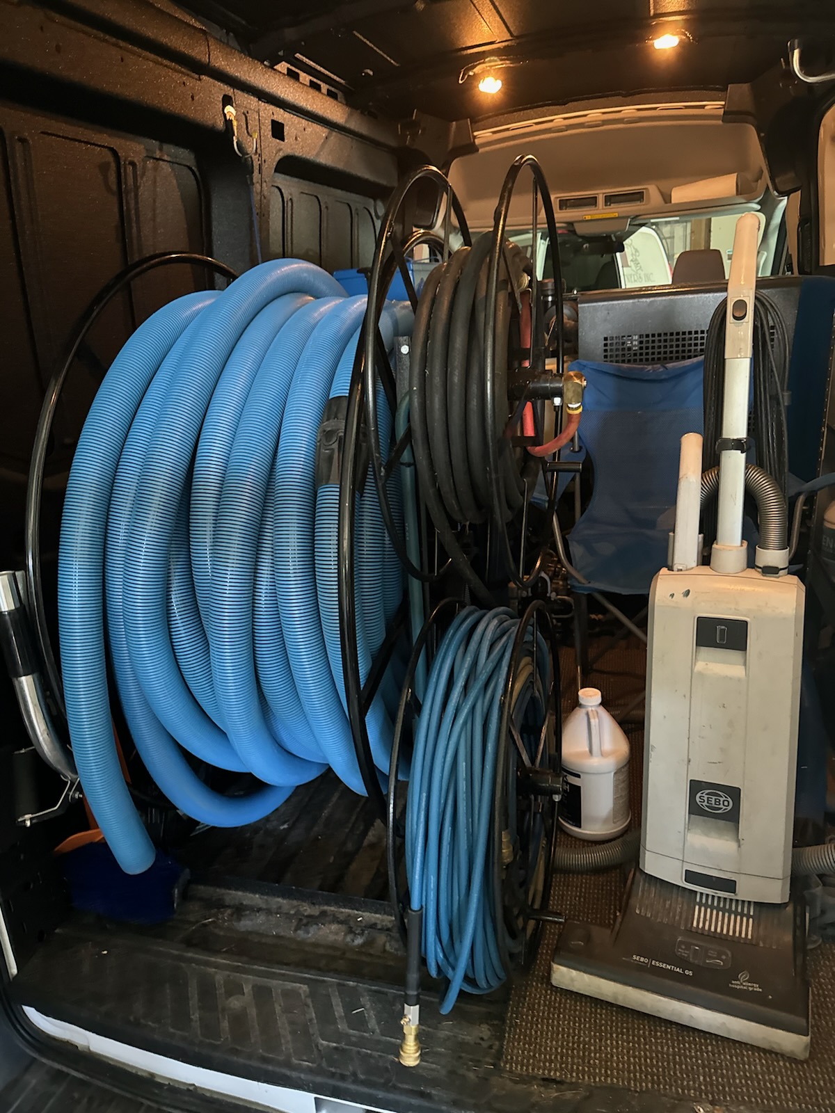

For that setup above, I would look for a tank that can be installed under the hose reels. A bunch of wasted space is in that area
6,527
Bc
I’ll bet by the time you add the tank weight, hoses, fittings etc, you’d be tipping the scale at 900 plus…
Depending on the total weight of ALL equipment, chems and passengers, what is the maximum amount the van can carry?
Load it NOW, less the fresh tank, go to a weight scale, do the math…
That will determine what size of tank they can install.

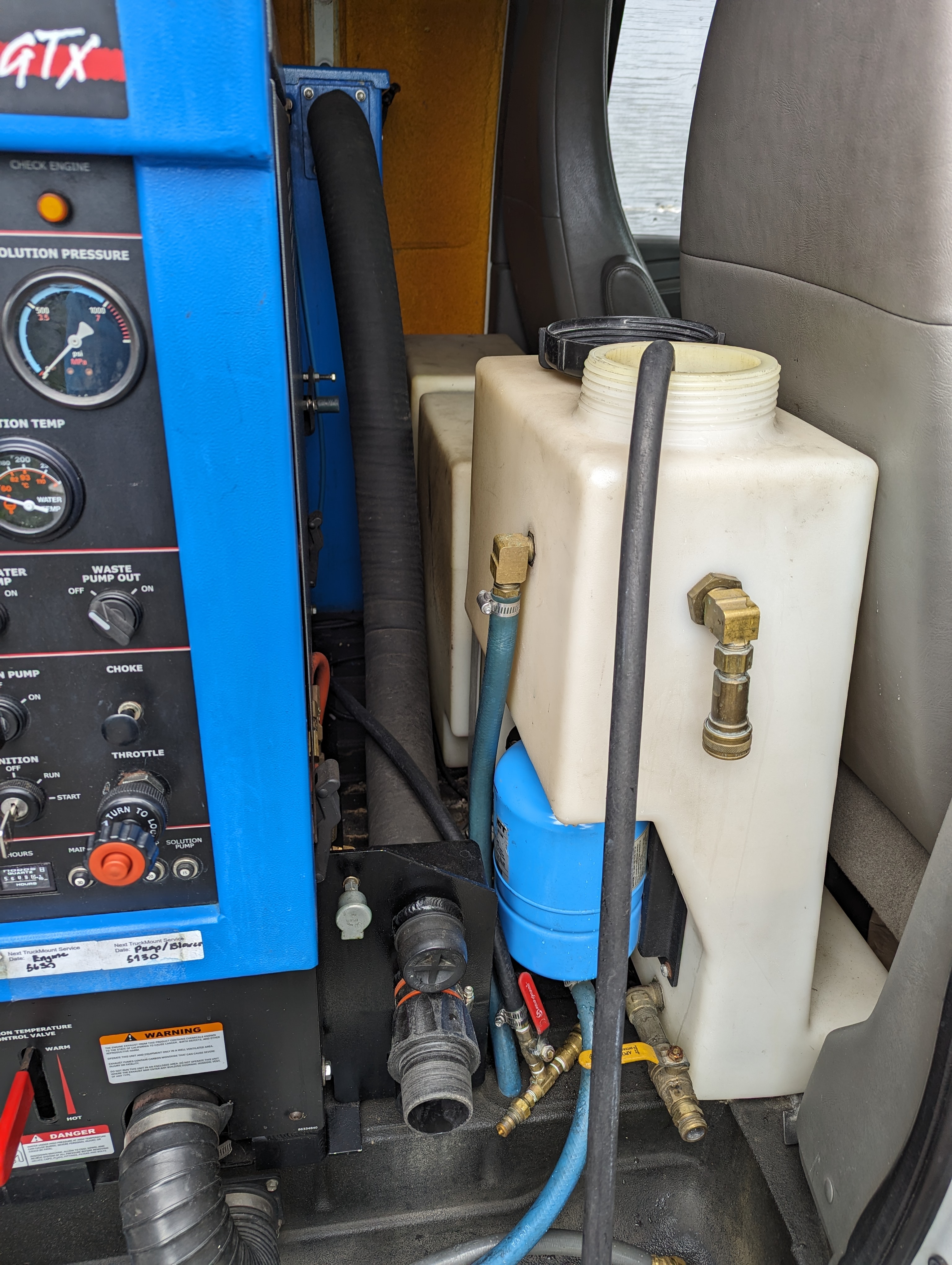

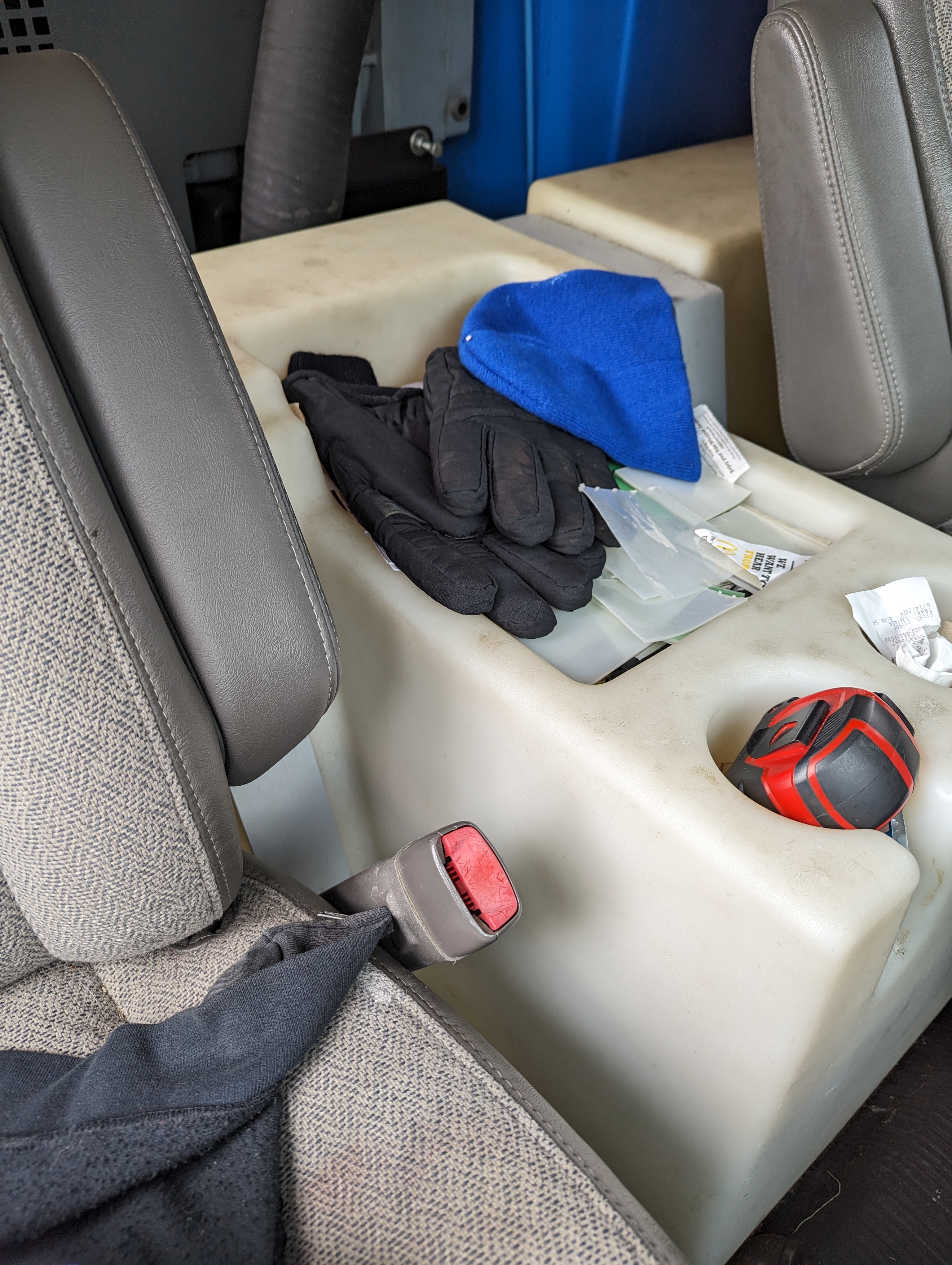

I have a 65 gallon rain barrel from tractor supply. Its pear shaped with a flat back so its not top heavy.
