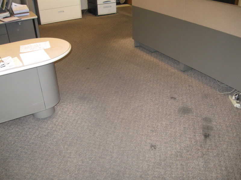

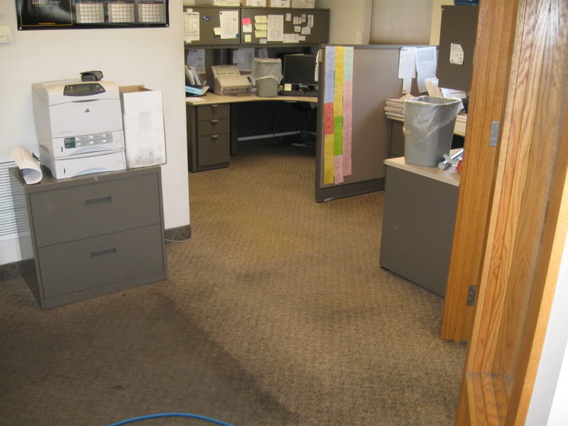

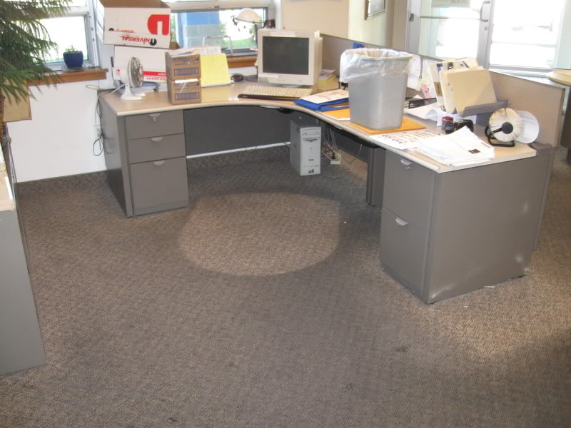

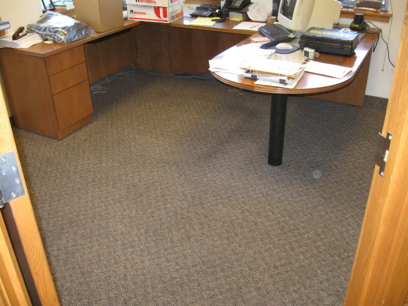

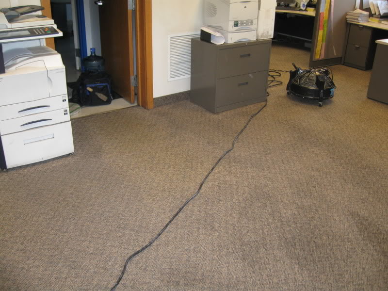

I cleaned a freight company office today. HWE with 220-240 ATM... Greenhorn wand ten flow, bumped the pressure up to 500 PSI. Used a strong solution of bridgepoint Zone perfect mixed with citrus solve. I used Power-Point in my head-cap jug metered around 4 or 6 gal/hour.

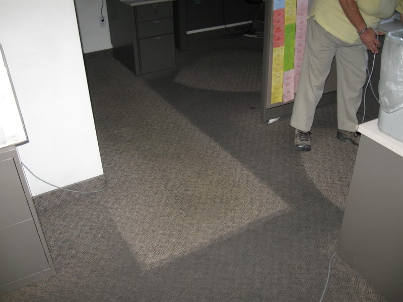

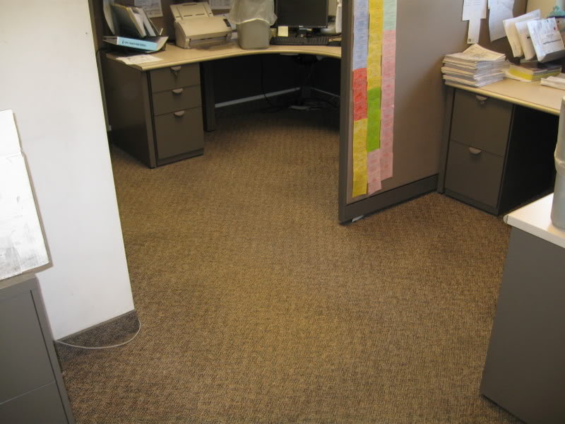

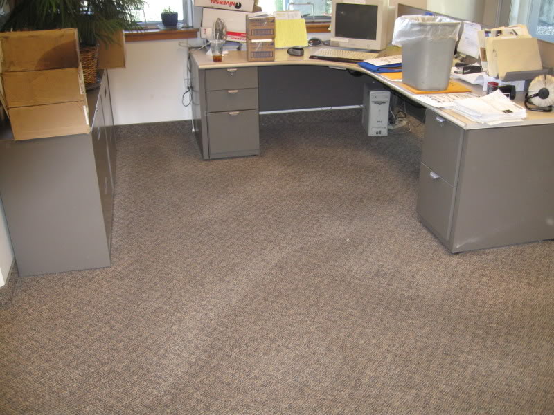

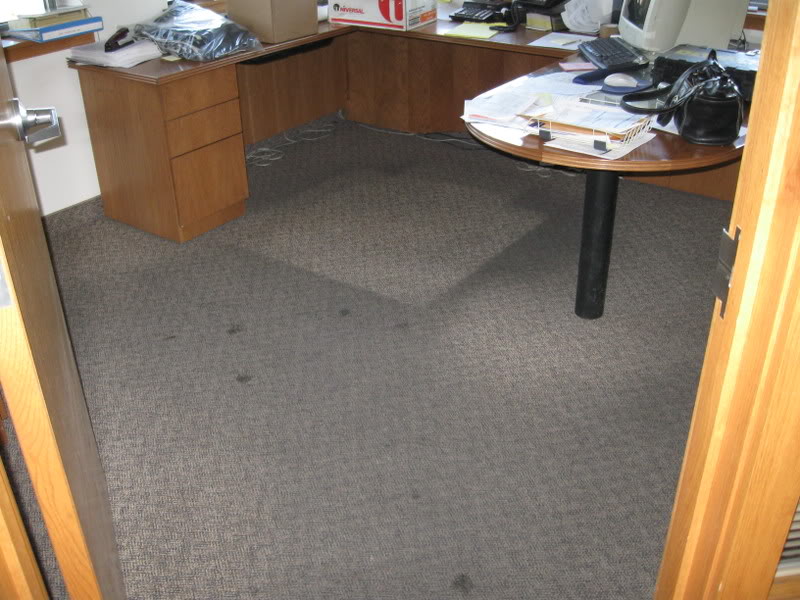

I pre-scrubbed with an adsorbent pad and post padded with cotton. You can still see where the mats were. Is there something I am missing?
And yes, that's my helper in the before pic...
I don't really know what I was thinking with the last two pics. I didn't keep track of my before and afters too well...
Anyway, lemmenowhachathinkin...
116,122
Try pre scrubbing with a Red pad next time and trigger spraying some Encap and 30 vol along with your post padding, but once a carpet is that bad it will never be 100% again.
They should be thrilled with what you did.
