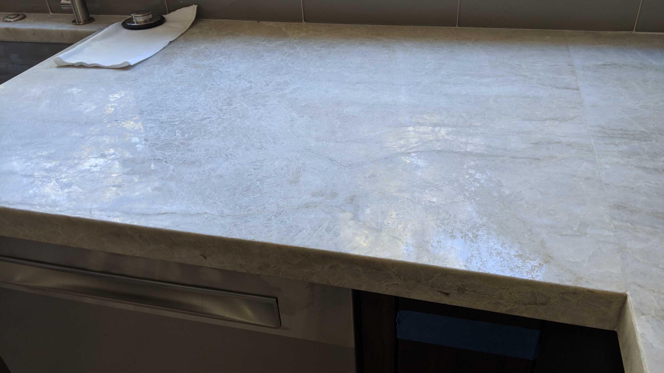

What do you see?

Yeah, that explains the looks of deterioration if that what i am looking at. Very reactive with lots of chems.
24,126
Redding
Holy crap, is that countertop limestone also? If so, is that all really bad acid etching from cutting up lemons for the annual Gardnerville Lemon festival?
24,126
Redding
Whatever that gypsum silica looking countertop is, it looks disgusting. A breeding ground for bacteria and botulism.
DAT
Apr 3, 2017
6,486
Nevada
Bill Cheryl
No it doesn't explain it as Onyx is not acid sensitive
I thought it was, its not a form of marble? I thought certain types of stone are very reactive to chems to various range of ph cleaners and thus bad idea to use as countertops for that reason. They just fall apart.
116,351

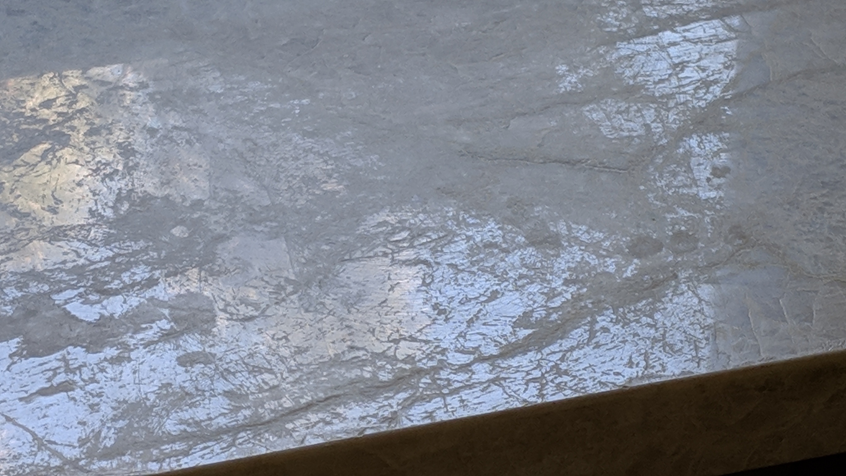

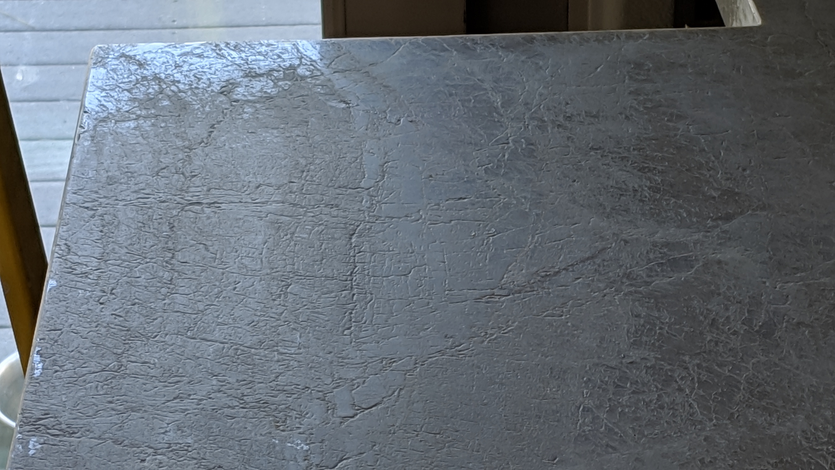

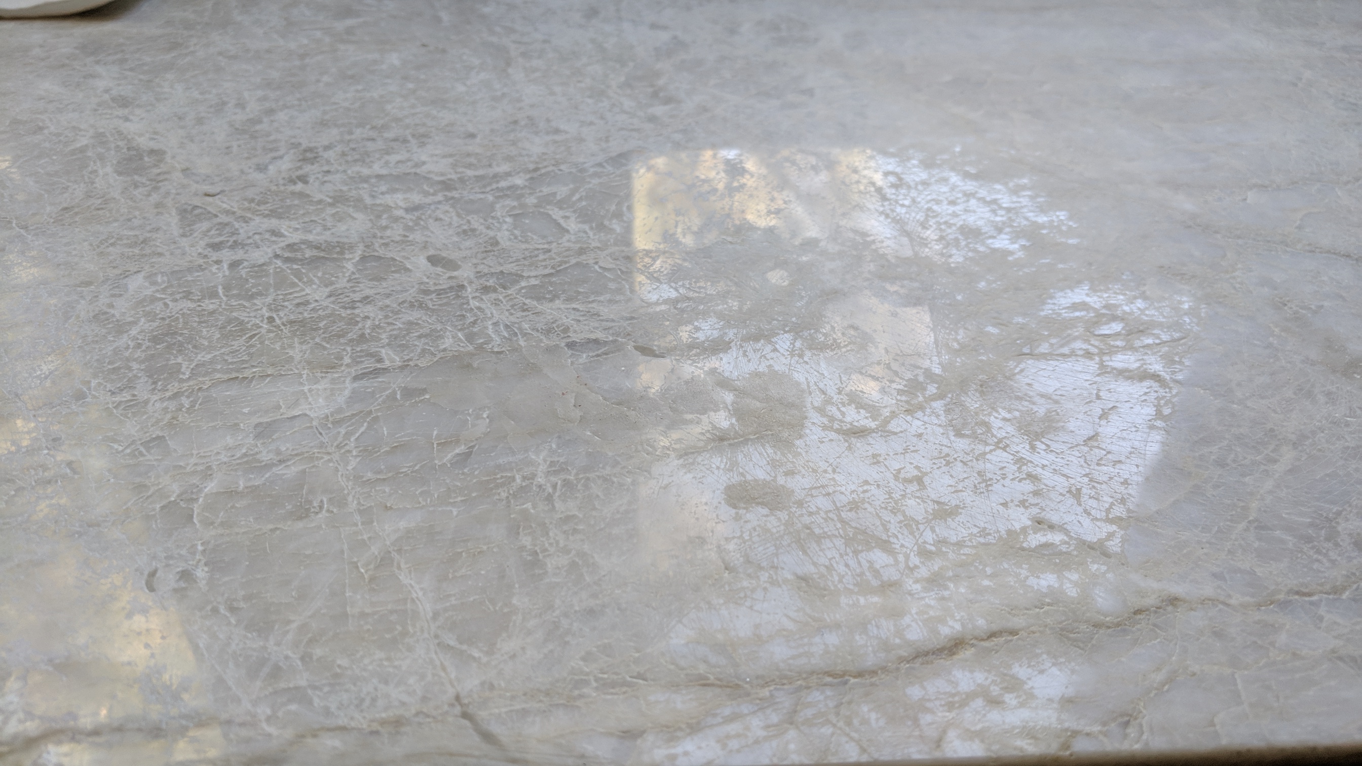

Leathered Finish on the countertop
Boink!
but it started off as a polished Onyx countertop that the homeowner requested to be leathered with the tile fabricator company promising them something that can't be done. They used a "three brush orbiter machine" of some sorts that they couldn't fully describe to the point where I understood what it was, but basically tried to do it by hand and obviously missed all sorts of areas and Onyx being a smooth stone shouldn't be leathered,unlike granite that is very grainy and takes to a lettering type finish beautifully
