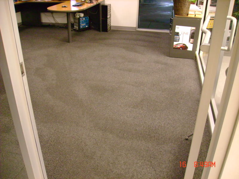

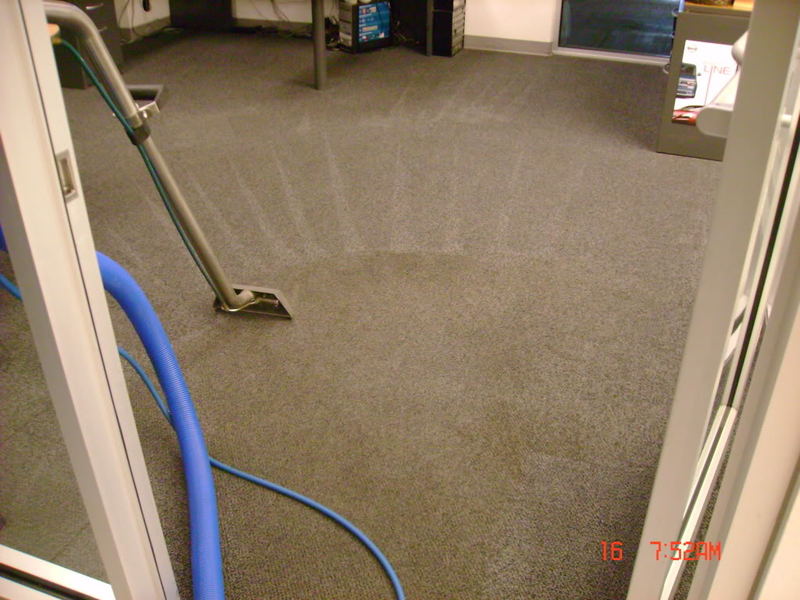

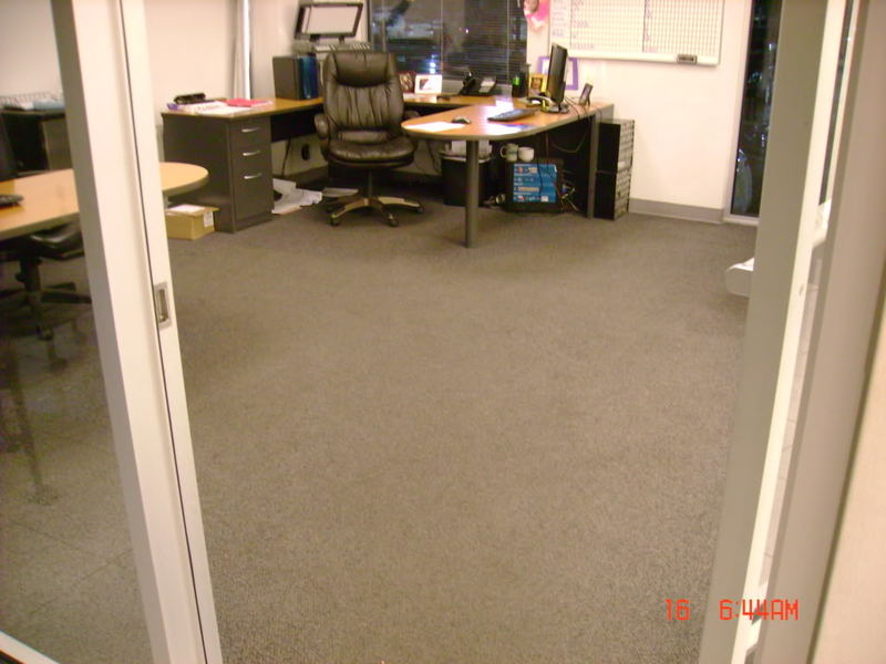

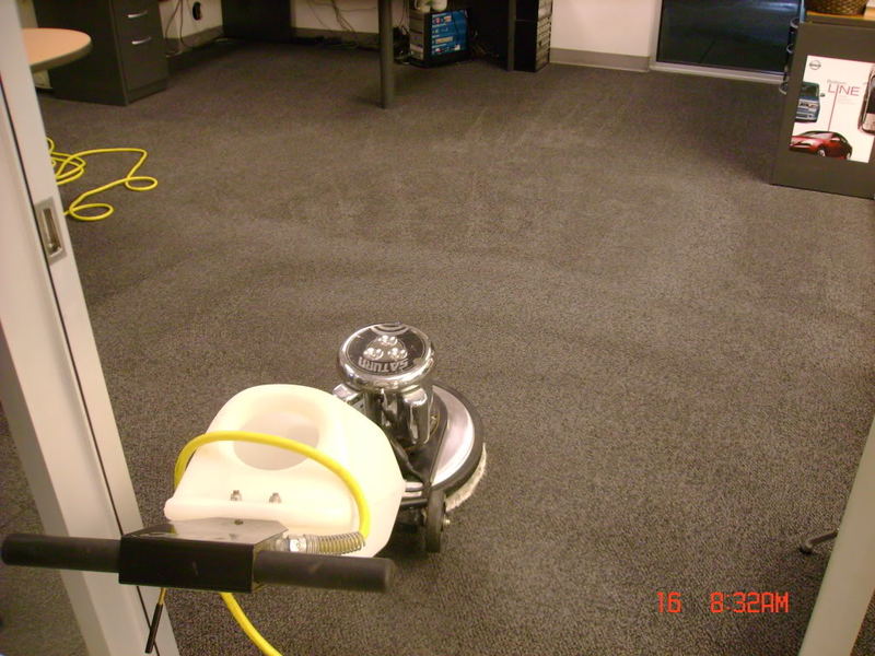

Well here are some photos. I learned a few things about scrubbing with a green pad. I tripped a breaker and the pad was wet and the carpet also plenty wet. I had to flip the pad over to the used side. The unused side was too rough. I guess the pad needs to be smoothed out over concrete. Anyways I am going back to using my brush. When the sales manager comes in tommorow and his computer doesn't work he is going to be po.
Before
A good precrub does wonders.
Look at the difference
Wow padding makes a huge difference. I used three pads for best results.
All finished and no grooming cause the cleaning ladies were coming after me to empty trash cans etc.

Ok couple of problems I see: Number 1: Use a pile lifter or CRB prior to vaccing to dig the crap out of the fibers and make sure you use a vac that will dig into the fibers as well. I noticed alot of commercial vacs are great for residential but can't even get the brushes down far enough to agitate the facefiber or a commercial Also if the carpet is that impacted you are doing yourself a great injustice for not using glides on that wand. Basically the carpet plus soil makes a very hard surface and the prescrub is like sanding off the top layer. You need mucho flow and a glide to allow airflow instead of locking that wand down on the fibers. You won't much up from that pile with a wand locked on the carpet. The brush would have been perfect for this job as well instead of the pads.

well 1st....them are some fugly pictures...hard to pick out whats what in the carpet
2nd where is your glide???
3rd hell yes encap that bitch and be called good.....sometimes you just cant fix it :cry:

Uh you might want to check the photos out there slim. I did pad the carpet after I steam cleaned it with 3 pads. If you mean to only buff the carpet without extracting it then heck no I would never do that especially on a carpet loaded with soil. By the way I went back today to pick up some blowers and the carpet was sparkling and it never looked that good. The manager was all smiles.
