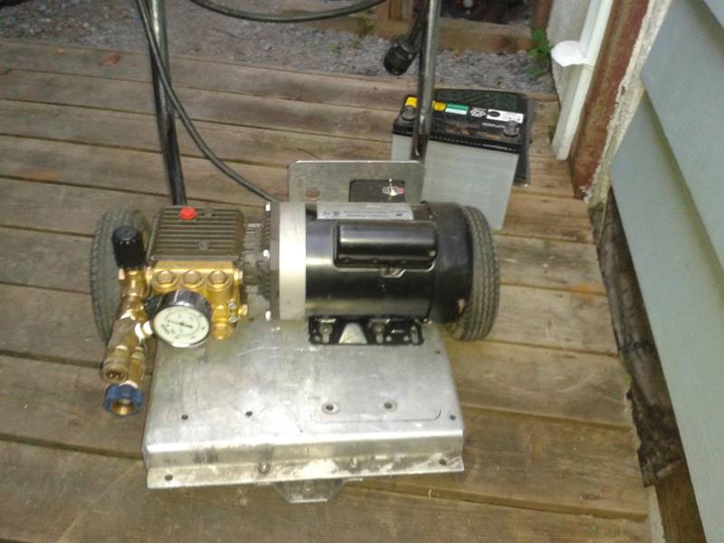

This is a direct hook up pump ( You might remember this one Mr C- ya sold ot to me), plenty of oomph for tile, can also be used for carpets.
pimp on a cart. I can just drop a hose in my tank to suck water for the pump or directly to a faucet. -

And for all purposes the General (cart) pump is superior to both the pumptec and the cat- except for amp draw.

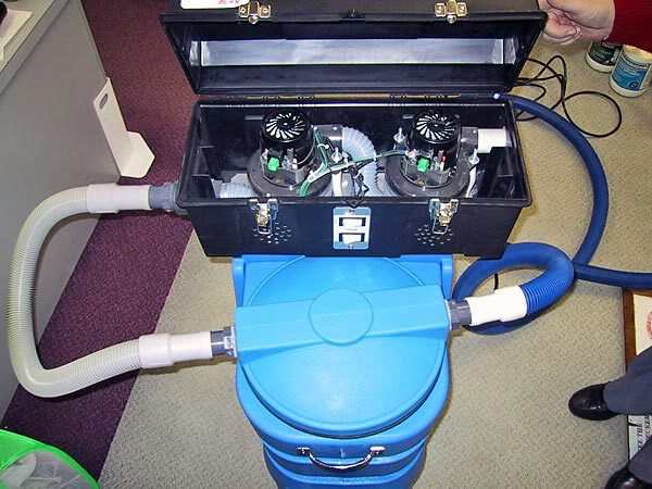

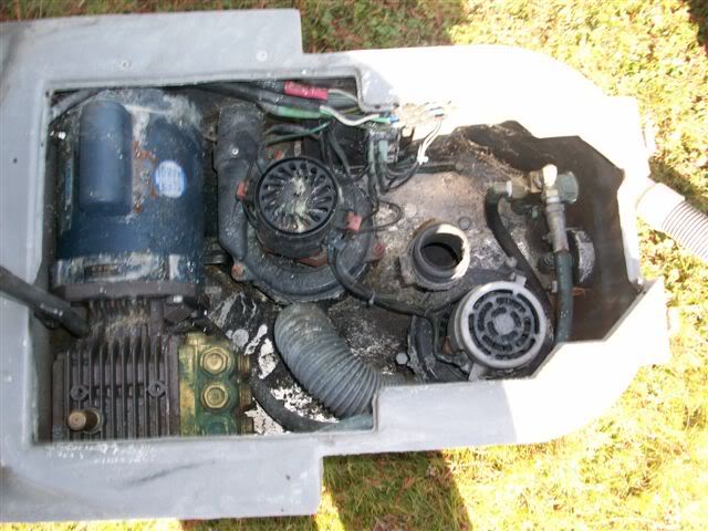

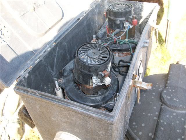

I know I've posted this before, but here's a general shoehorned into an old school ninja body. I ran the tool box vac booster to get some serious suck. Too bad it got burned up in a fire.
vac booster
Body with General lower with baked booster - the 4 two stagers were phenomenal in vacuum. Both units were rendered useless by a fire. That WAS a high performance portable.
