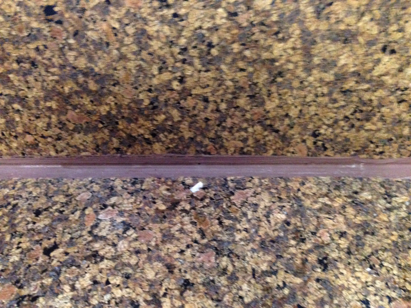

He wants it caulked with something that matches better

do a better tape job than that guy did.
tool the silicone with soapy water on your finger, it won't stick. You can smooth it out.

Cameron, do you know of a company that offers more colors than GE?

I was using Customs, but they stopped carrying it out here. Also, they have issues with the bottles splitting at the bottom and the silicone starts to cure. If you can find it, it's a good product with a lot of colors.
Without a doubt, Laticrete Latisil is the best product and they have a lot of colors to choose from

the problem with these silicones is nobody carries them, because contractors are too lazy to use it correctly. You'll likely have to order in cases of 6
