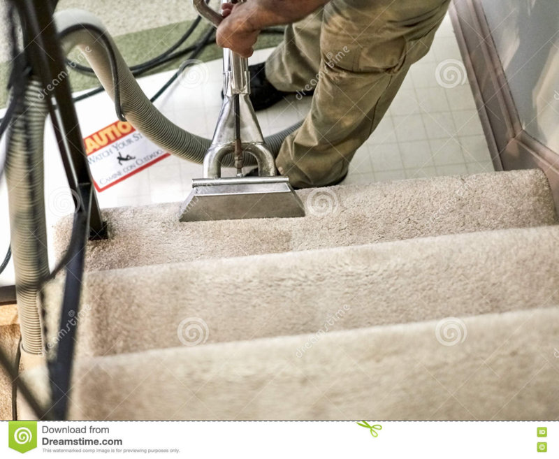

Nov 21, 2016 #3 R roro Member Joined Oct 18, 2006 Messages 1,310 Name Ross Craig Does the twin neck give better airflow? roro
Nov 21, 2016 #4 Mikey P Administrator Joined Oct 6, 2006 Messages 117,207 Doubtful, just confuses the flow Reactions: Shorty and BIG WOOD
Nov 21, 2016 #5 Cleanworks Moderator Joined Oct 22, 2012 Messages 28,256 Name Ron Marriott But it looks cool. Can you imagine if it swiveled?
