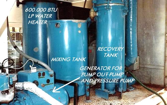

When Judson first introduced the kunkle valve to the carpet cleaning industry in 1968, it was part of the industry's first patented gasoline powered carpet cleaner. This unit was also a PTO unit. The truckmount had a 4 foot wide wand. It was used to clean football fields. The main reason a kunkle was used in this application was the high volume of the #8 blower. What the kunkle did was allowed the blower to pump all 1200 CFM out of the recovery tank so the massive four foot wand could get as much CFM as possible.

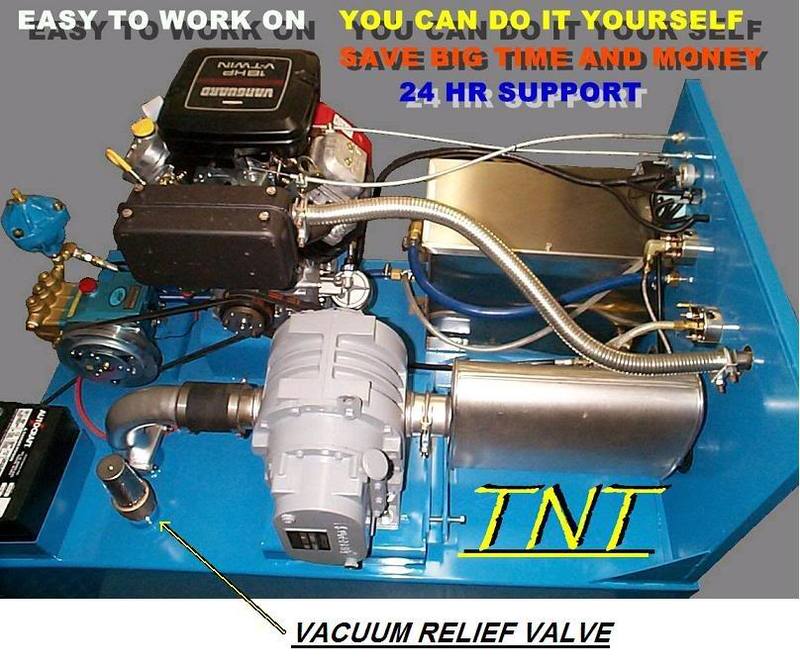

Once we went into production in 1972 on slide-in truckmounts you will see a vacuum relief valve in the photo below. This valve can be purchased from Home Depot. It's actually part of a home well water system called a foot valve. We take this valve and increase the spring tension with a stiffer spring. We adjust this valve by adding or taking away washers to get it to relieve at 15 inches of mercury.
Through the years we've done testing on conventional slide-in units with kunkle-type valves. We feel the use of a kunkle valve on a conventional slide-in unit is not noticable until you are using more than 300 feet of hose. As the hose length is increased the resistance of trying to pull the air is increased. The kunkle will allow the system to run at a few inches higher lift than normal. This in turn gives the vacuum more power to pull more CFM through longer hoses. One interesting thing we did with a kunkle-type valve on a TNT is that we ran 950 feet of hose with a 14 inch wand. All the hose was 2 inch. We were cleaning commercial low loop carpet. There was not a tremendous amount of vacuum left, but it was enough to get the job done with the use of a dry stroke.
