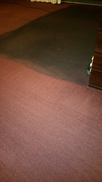

Cleaning this Steakhouse last night was only possible because of a 175 rotary and the right chemistry.......................
Best of both worlds as a 175 rotary will always be your best friend whether T&G or carpet.
