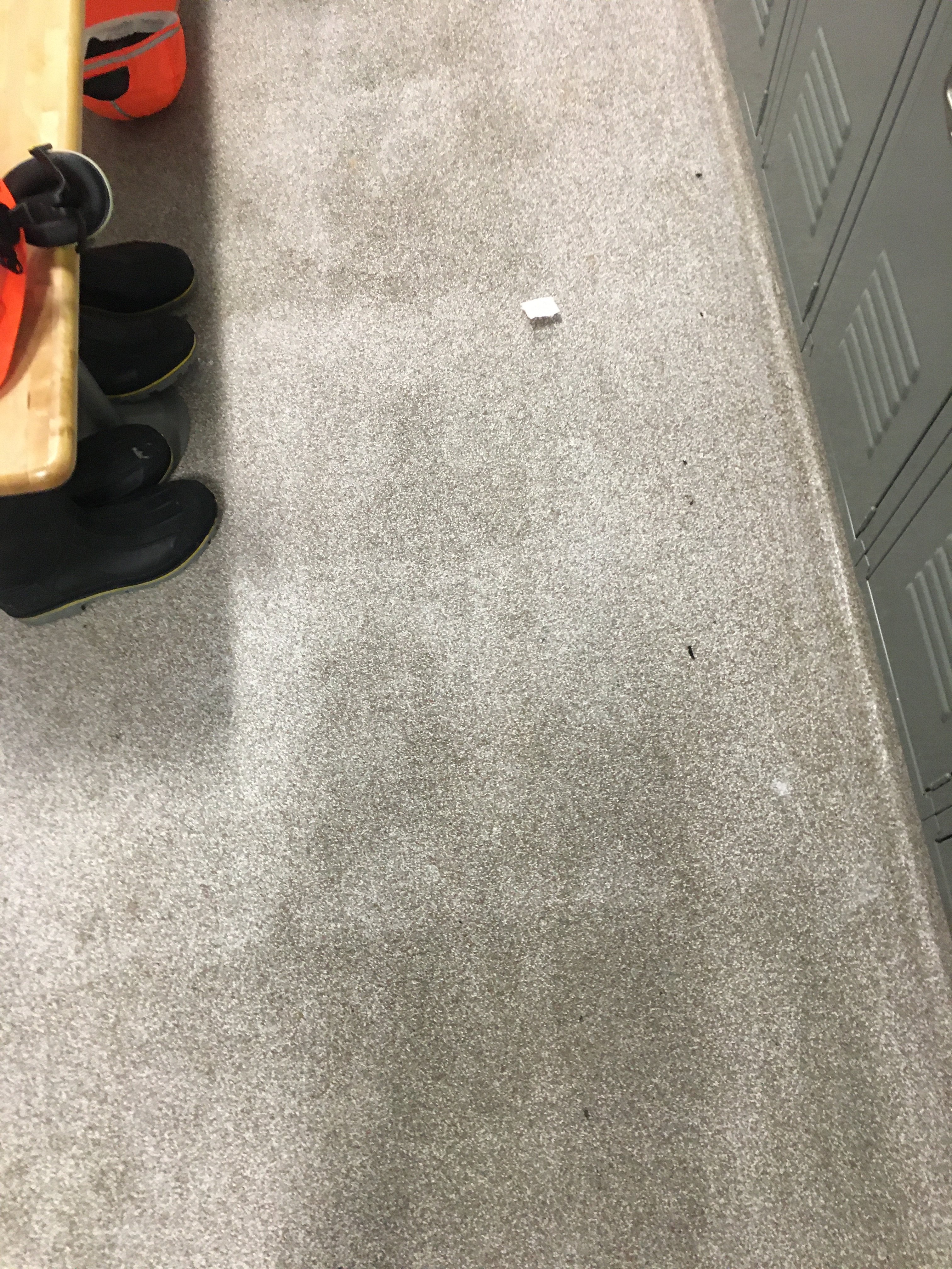

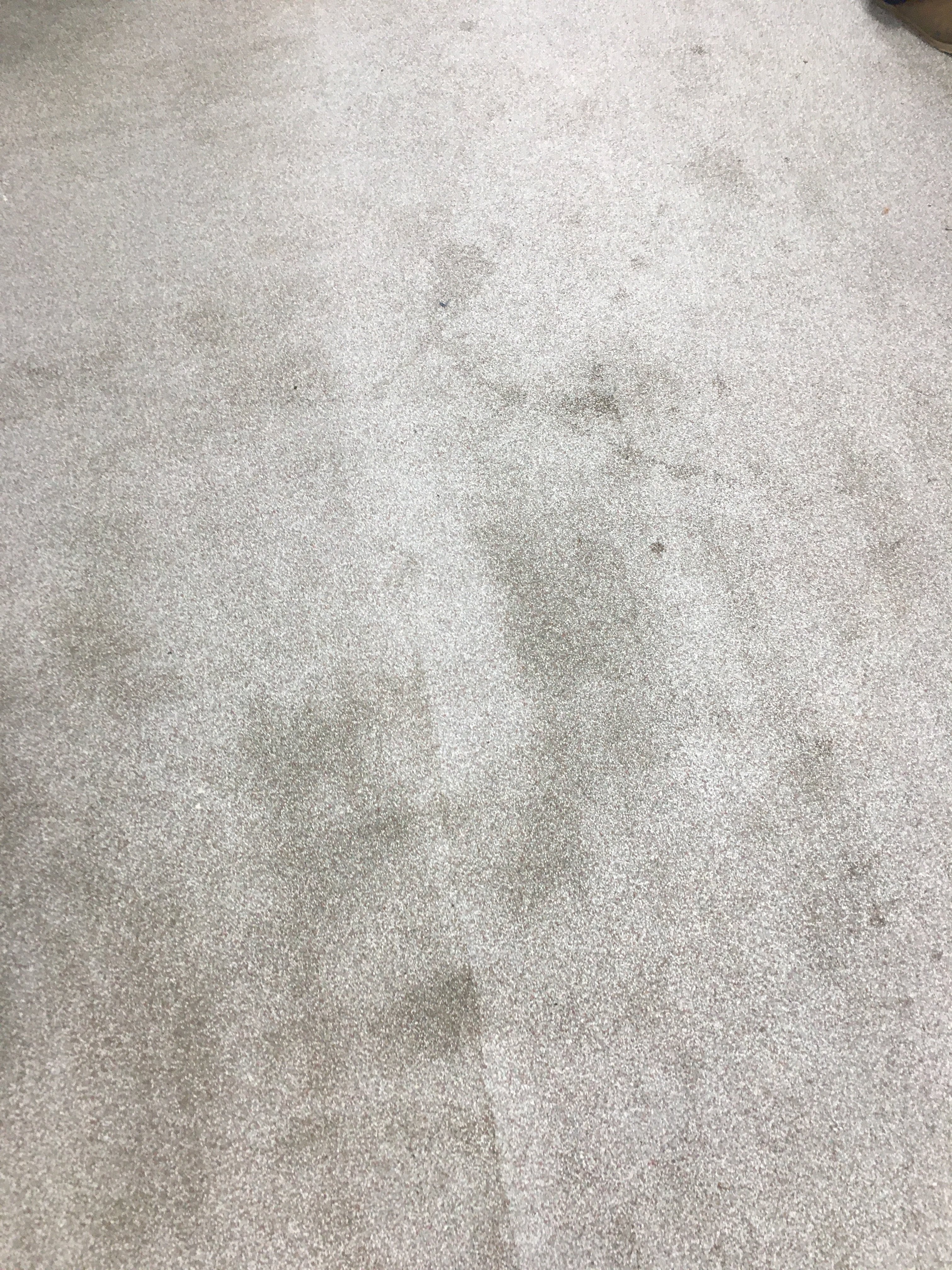

Did about 6k sq ft of epoxy bathroom floors yesterday. No sweeping or vacuuming. Just spray treatment, and th-40 it off at 1300-1500psi
!400 PSi to clean a non ABsorbant floor.
300 would have done the same
Where do you find 6000 ft of bathrooms? In a stadium?
