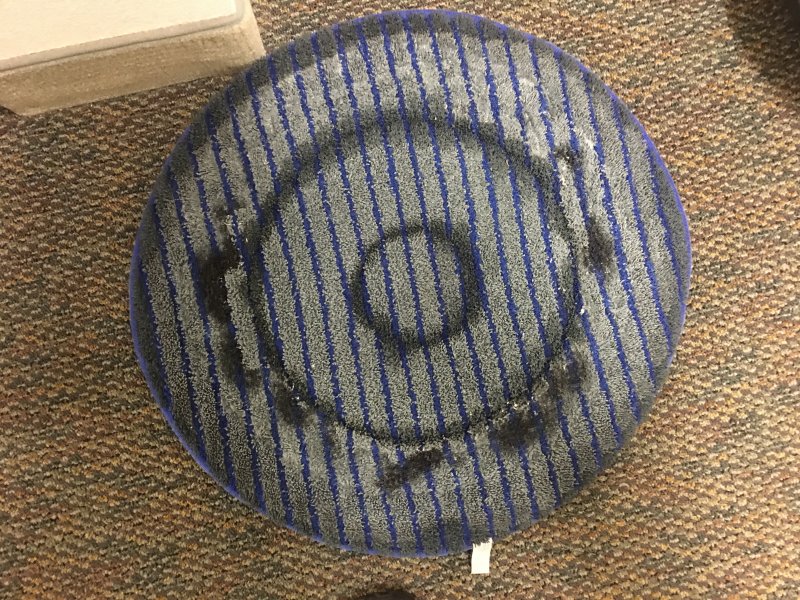

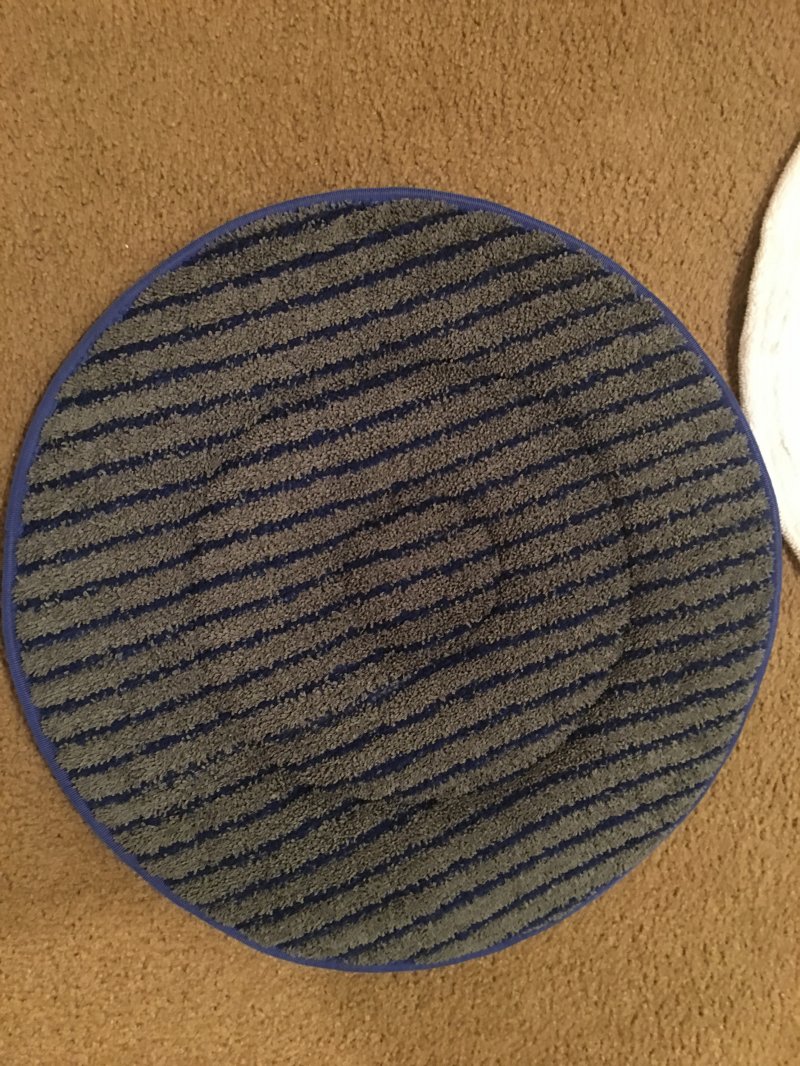

Mike. Your answer is the exact opposite of what I expected. The microfiber pad is really thick and it also has course dark blue lines in it. I would have thought that it would be the better one for filthy floors and would also be more absorbent than the terry cloth pads.

You must not have kept it wet or flipped it. Try flipping it every 300 feet, then switch to a new pad.

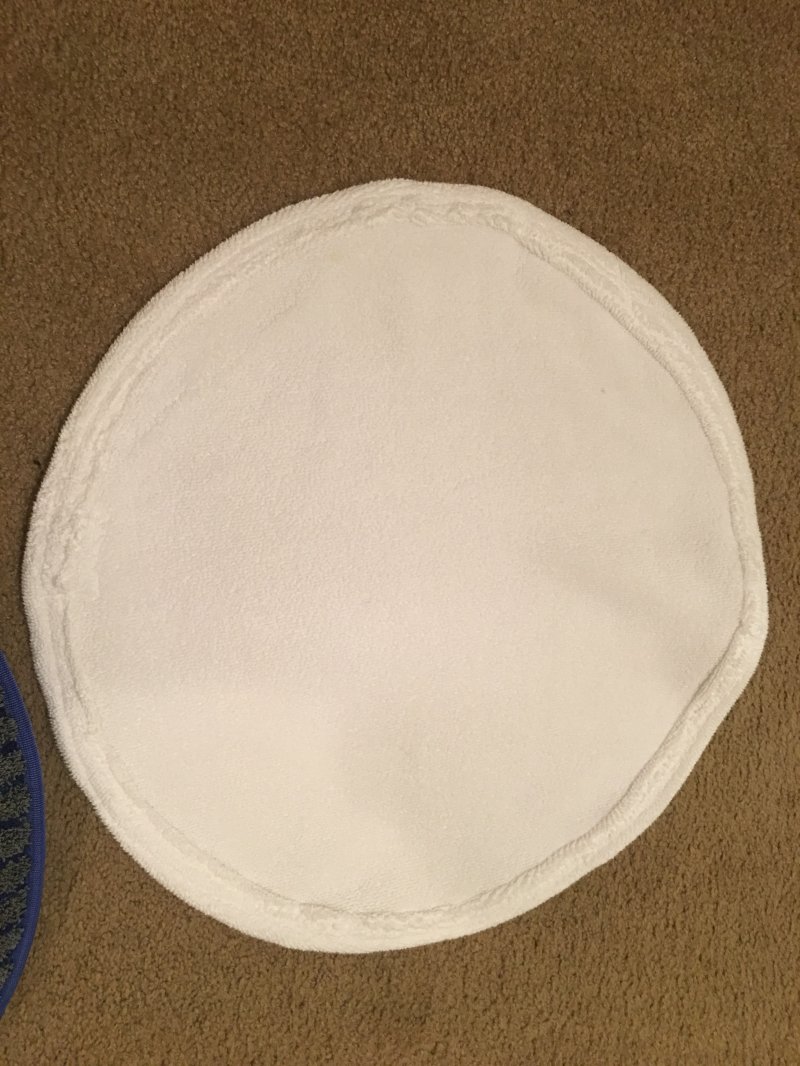

No I didn't flip it. I did wet it then post bonneted with the superzorbs. The carpet came out beautiful. Wish I could say the same for my microbeast pad.
