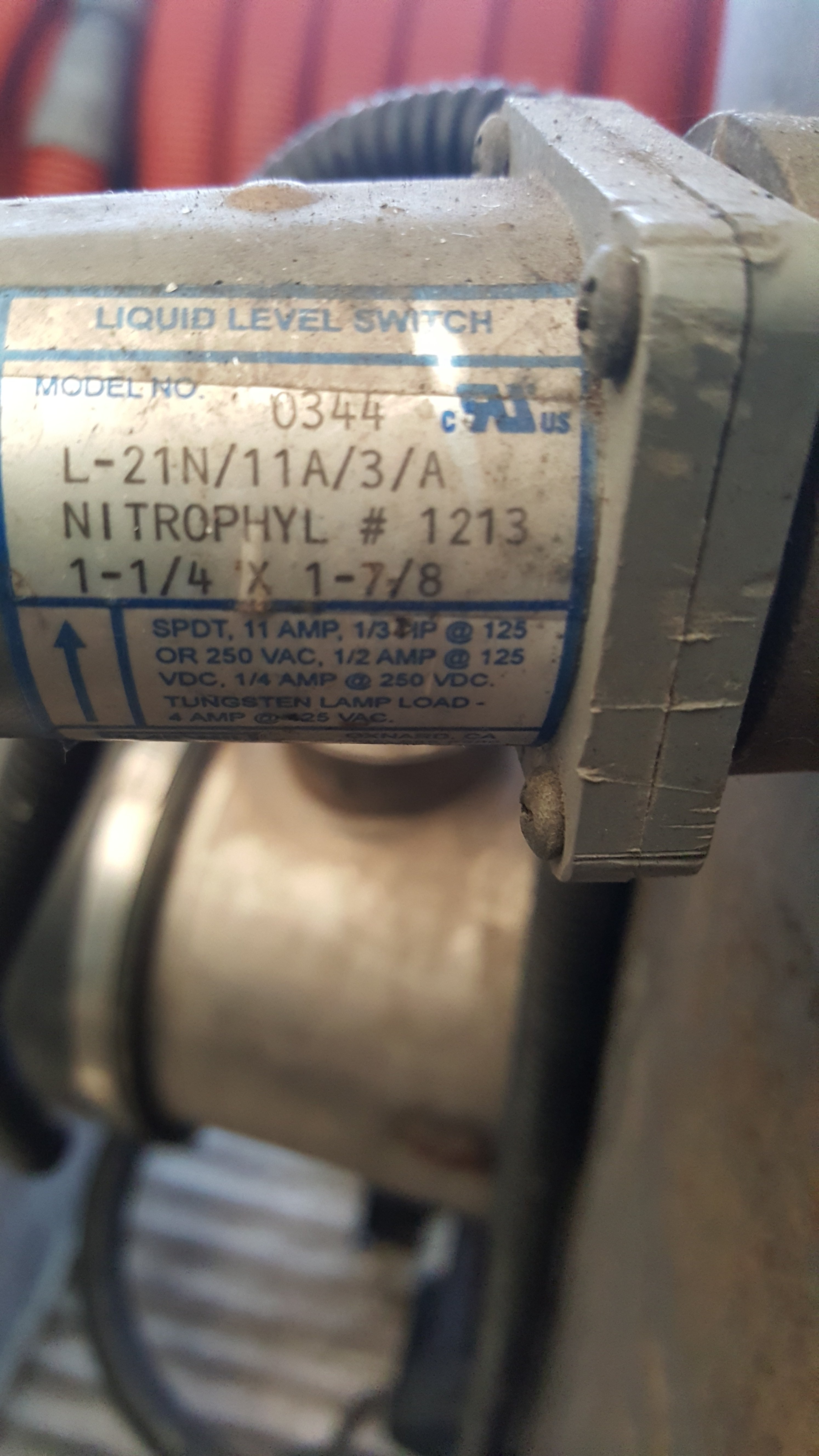

Where can I get this float switch?

It' a waste tank float switch for a Vortex.
Cleaning Professional
Steambrite is where I get my sapphire replacement floats. Consistently they are about $50 less than JonDon and interlink.

Thanks Fred. You are amazing search engine! I tried to search on ebay also but failed.

Its a Harwil float switch...you can call them direct..you can either get a part for it..like the micro switch or the float....or just give them the numbers and they can send the whole thing to you....
the L-21N is the standard float switch pretty much used for everything....

Mostly operator error or operator damage to the unit.
Those floats are the best medium priced level switches out there, that I have seen.
