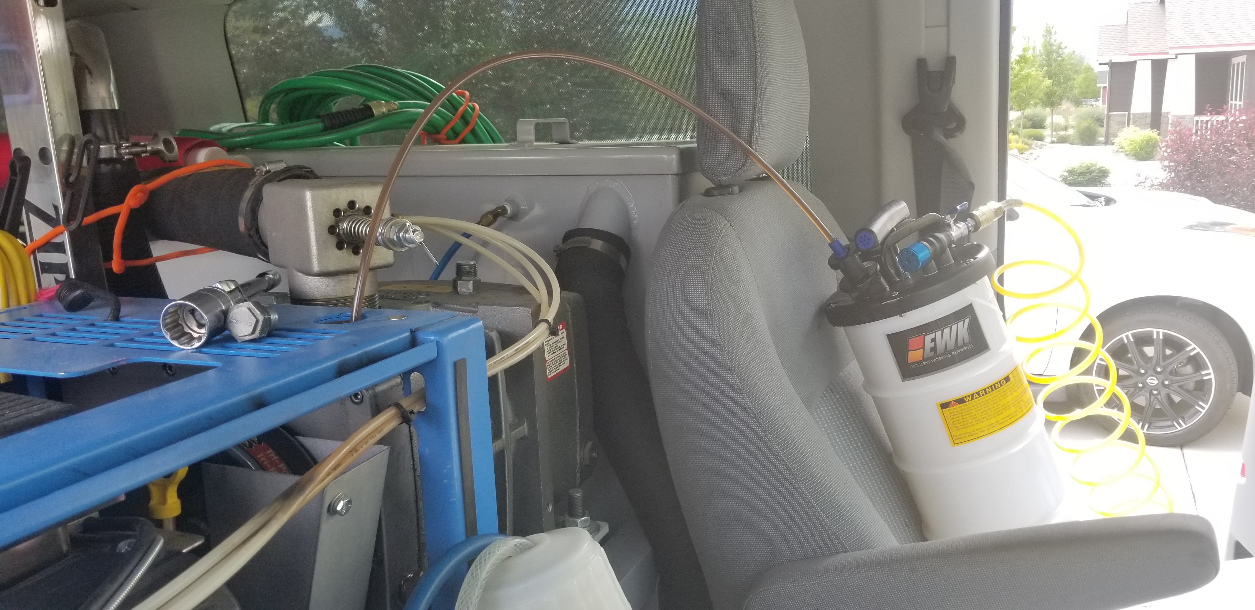

Drains a 3.5 quart blower in under five minutes
Hack Attack
Dec 19, 2017
5,620
further south than you
Dan
I just worry bout any sludgy oil at the bottom that possibly gets left behind with removing oil that way?

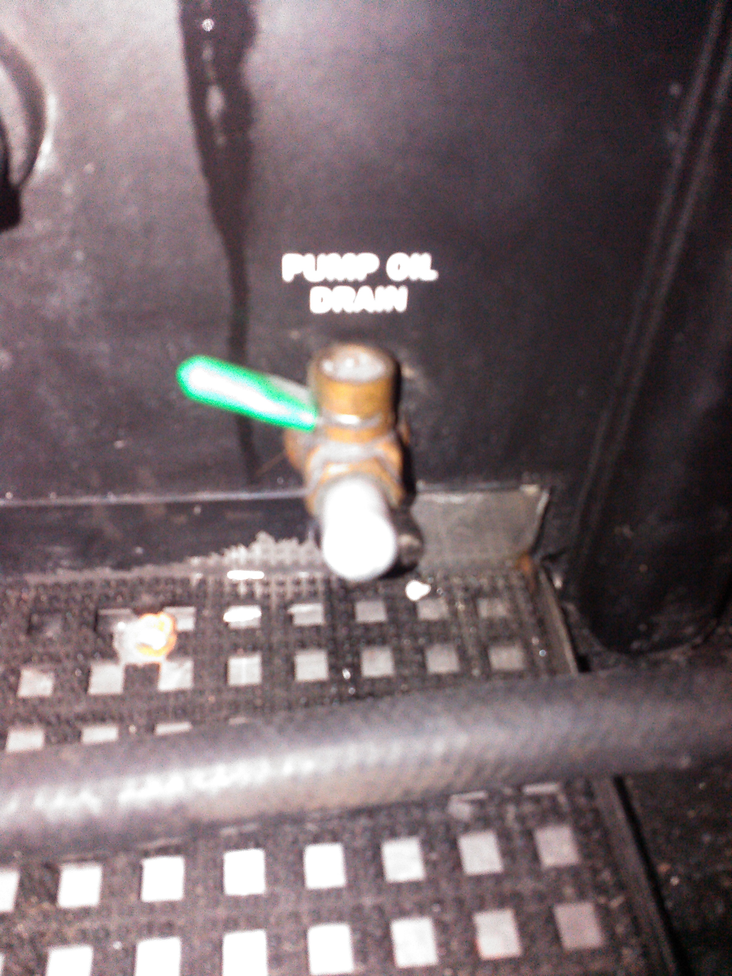

CDS units have drain hoses that exit behind the passenger seat. Anyone that has an older unit with a drain hose should check and replace if it gets stiff. It can crack and drain your blower while you're working.
