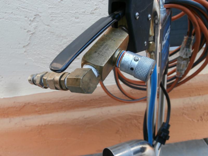

I have mine set to where I can control it with my finger......so when I get to a real heavily soiled area I can spin it wide open...or when I am at a lightly soiled area I can shut it down some......so my starting point is going to be determined by what type of soil I am looking at.........
I have no clue what the needle valve and the disk are equal to...........after you use it for awhile you just get use to where to put it for what you need...I don't even look at the thing anymore...I just turn it with my finger as needed and go..............

Can we see a picture of your needle vale set up Jim. I have the large disk now. I was thinking of making it bigger but I might go with a needle vale.
