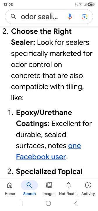

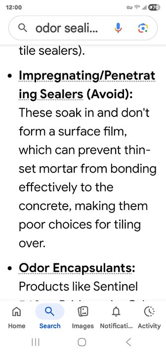

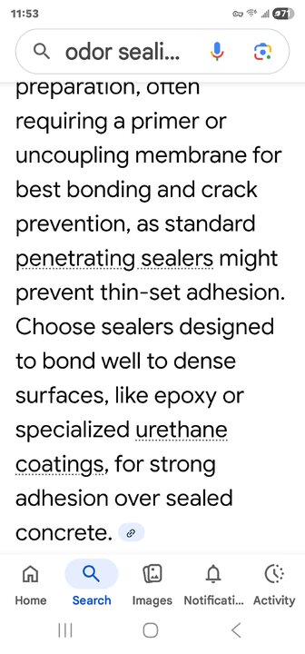

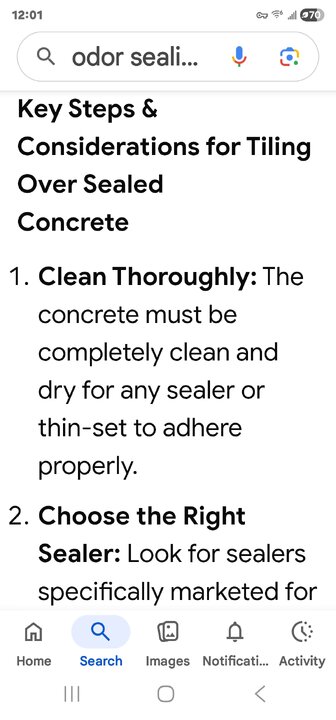

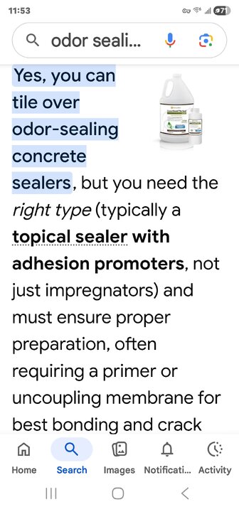

Make sure you use the right products. You are not overthinking it. I found something similar to what you said.
