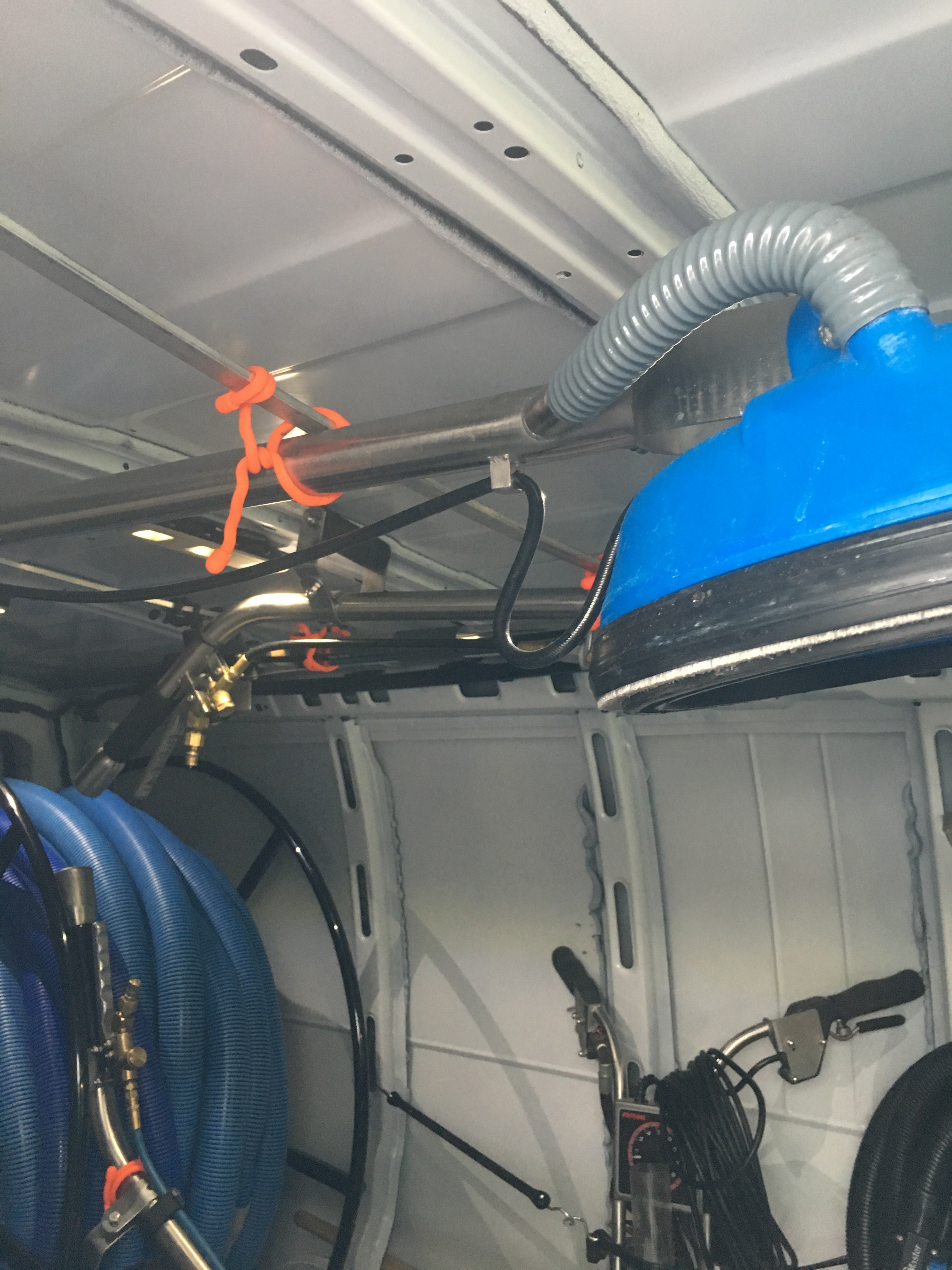

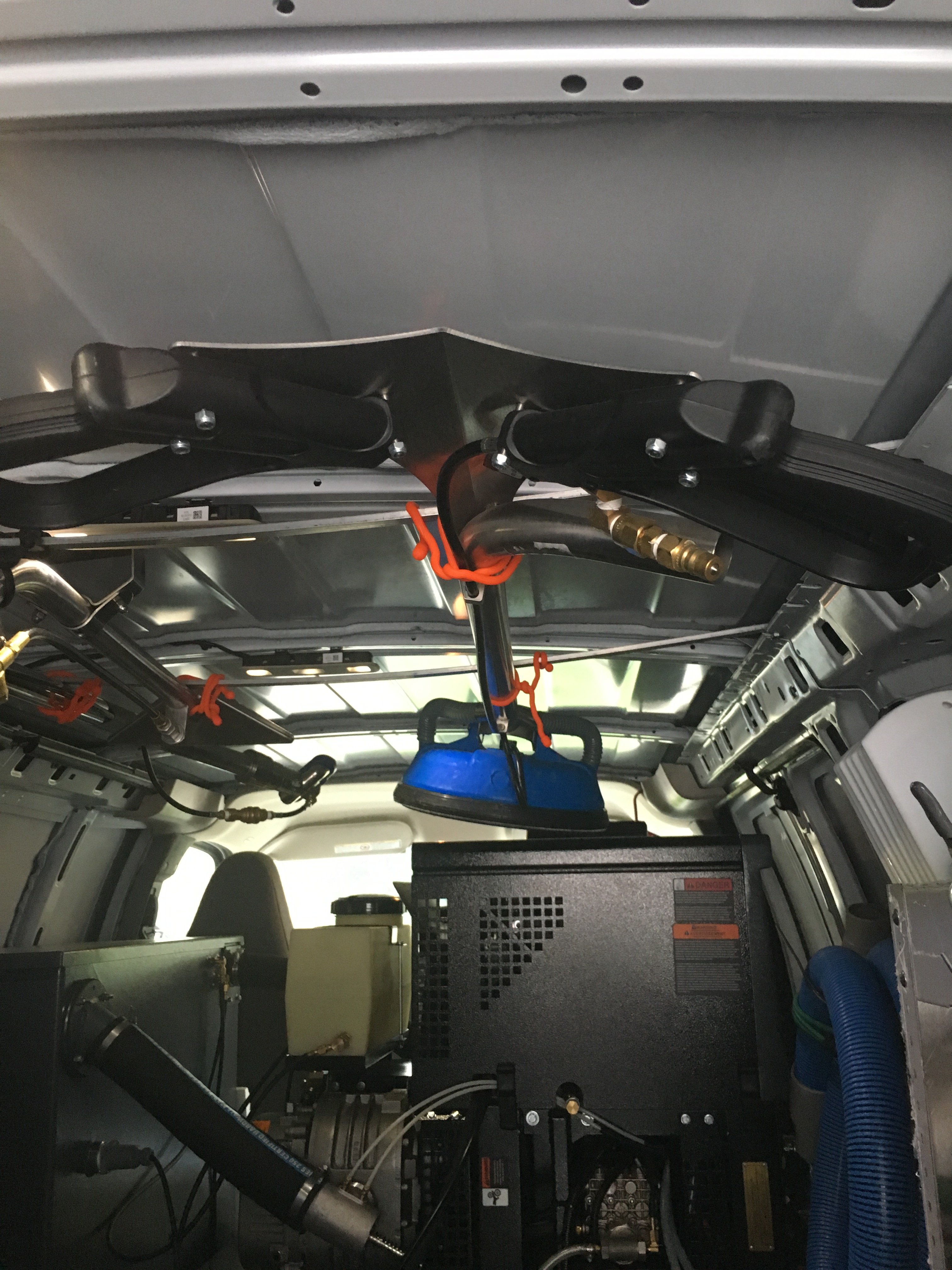

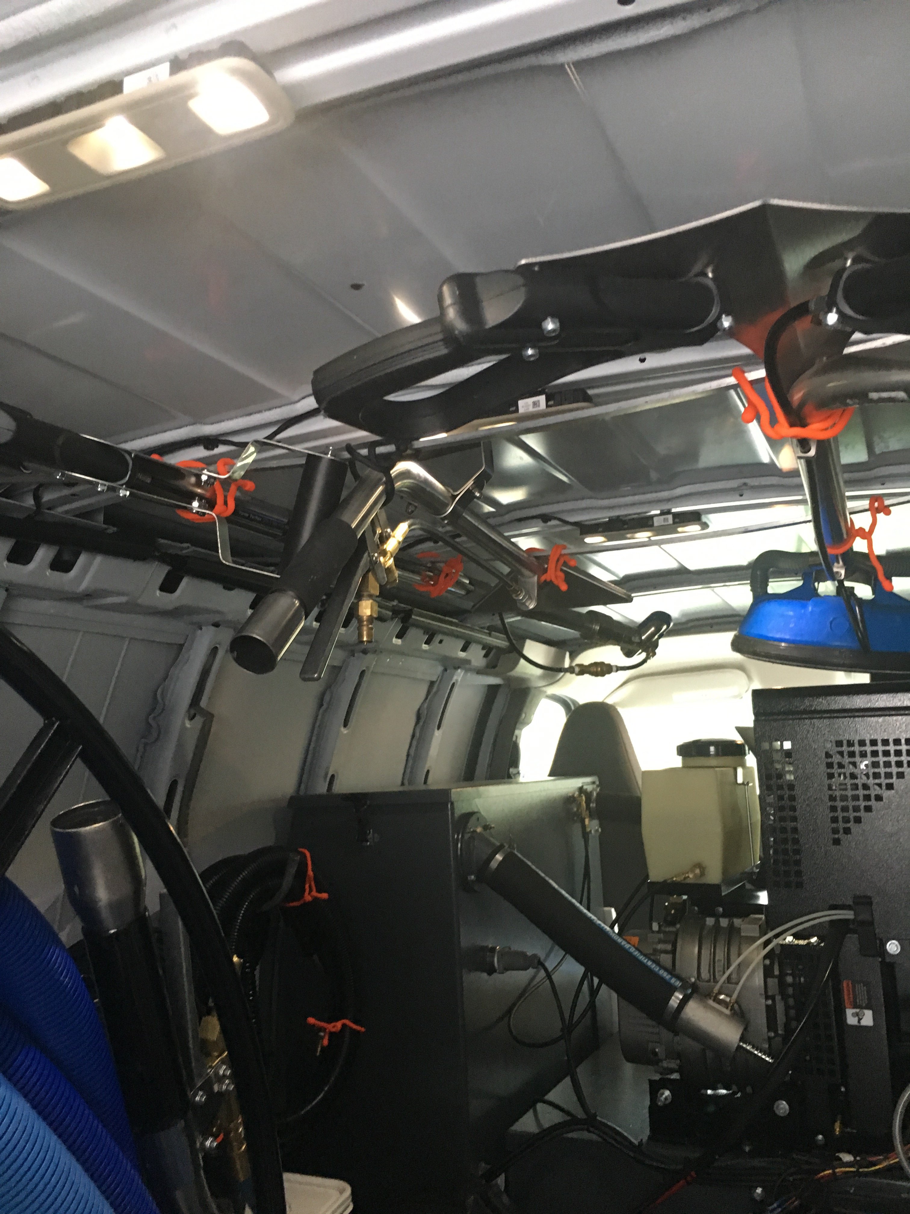

View attachment 79751 View attachment 79752 View attachment 79753
I use this foam ties to keep the tools from bouncing and squeaking on bumps.
I was just noticing how low the float switch is on your waste tank. That's how my new TCS is also. If more manufacturers would design their tanks like White Magic and put the waste tank filter and outlet to the blower on top of the tank it would hold a lot more. My 65 gallon tank is only good for 50 gallons.[/QUOTEi noticed that too when they installed it. 60 gallon waste tank that only holds 48-50 gallons of waste water.
