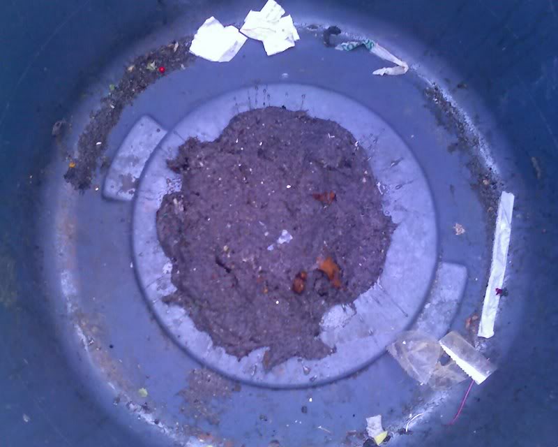

This was in my drain filter today...
117,207
Dumped the full Sani after each job.
The power of the Vanifold.
vincent
1,899
Vincent Sapp
You're supposed to clean carpet not the driveway.
How does that paper get in there? I think someone takes the hose off the wand and sucks up crap. ARe you sure the vacuum cleaner is working??
vincent
1,899
Vincent Sapp
That's a 200 gal waste tank right?
Just think I get half that much with a 120 waste tank.
Question though, are you sure you are leaving carpet there after cleaning. Thats alot of junk.
15,253
You definitely are not a snobby high end cleaner but just a simple HACK like the rest of us?
So how many times did you have to punch the holes in your glide to get the crud out while you were using it?
117,207
Never James.
My finely tuned machine sucks the crud right through.
