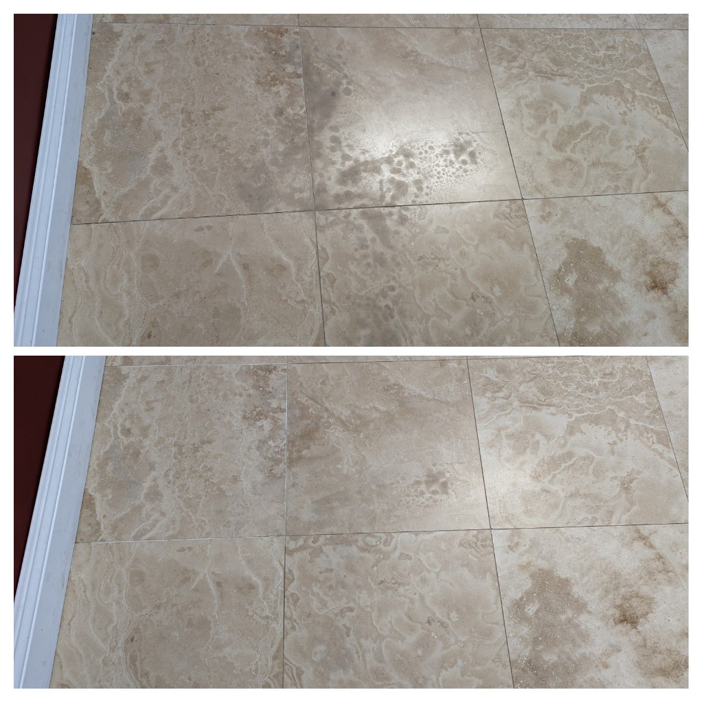

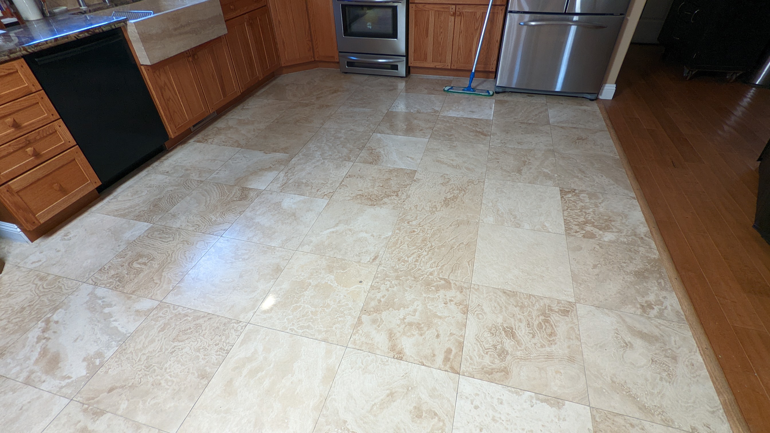

Turns out it was real travertine, very unusual one..
Got the red out but the etching remains. They didn't want to resurface the floor.. 20220831_111026-COLLAGE.jpgPXL_20220831_170836167.jpg
116,469
Not only did I misdiagnose this floor from the photograph that I posted elsewhere. I also blew it in the freakfact that my Crocs left footprints after using Sager tsunami and sugar oxy end cap to chemically etch the floor, normally I would have used 40 volume but I removed it as I'm headed to Vegas on Saturday and the only peroxide base product I had was the oxy encap, while it worked well, there were some kind of weird chemical reaction with my favorite casual footwear
