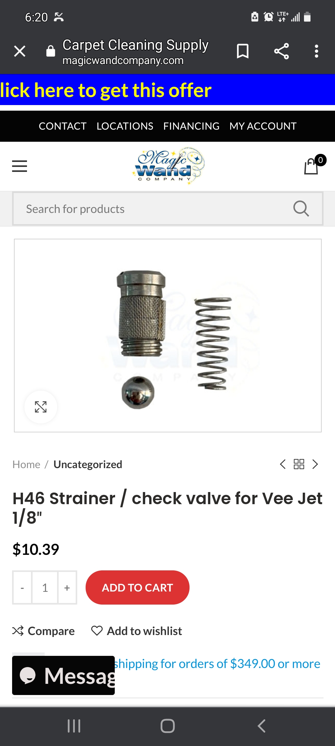

I recently installed these and the screen are cleaned.

The pressure from the leaky valve pushes the springs enough to release. That's why you get the effect of a lot will drip then it slows then a lot then it slows.
The spring valves are useless. Think of it as a full straw with your thumb over the too. It will never leak until you let air in.
Just replace your valves more often.
