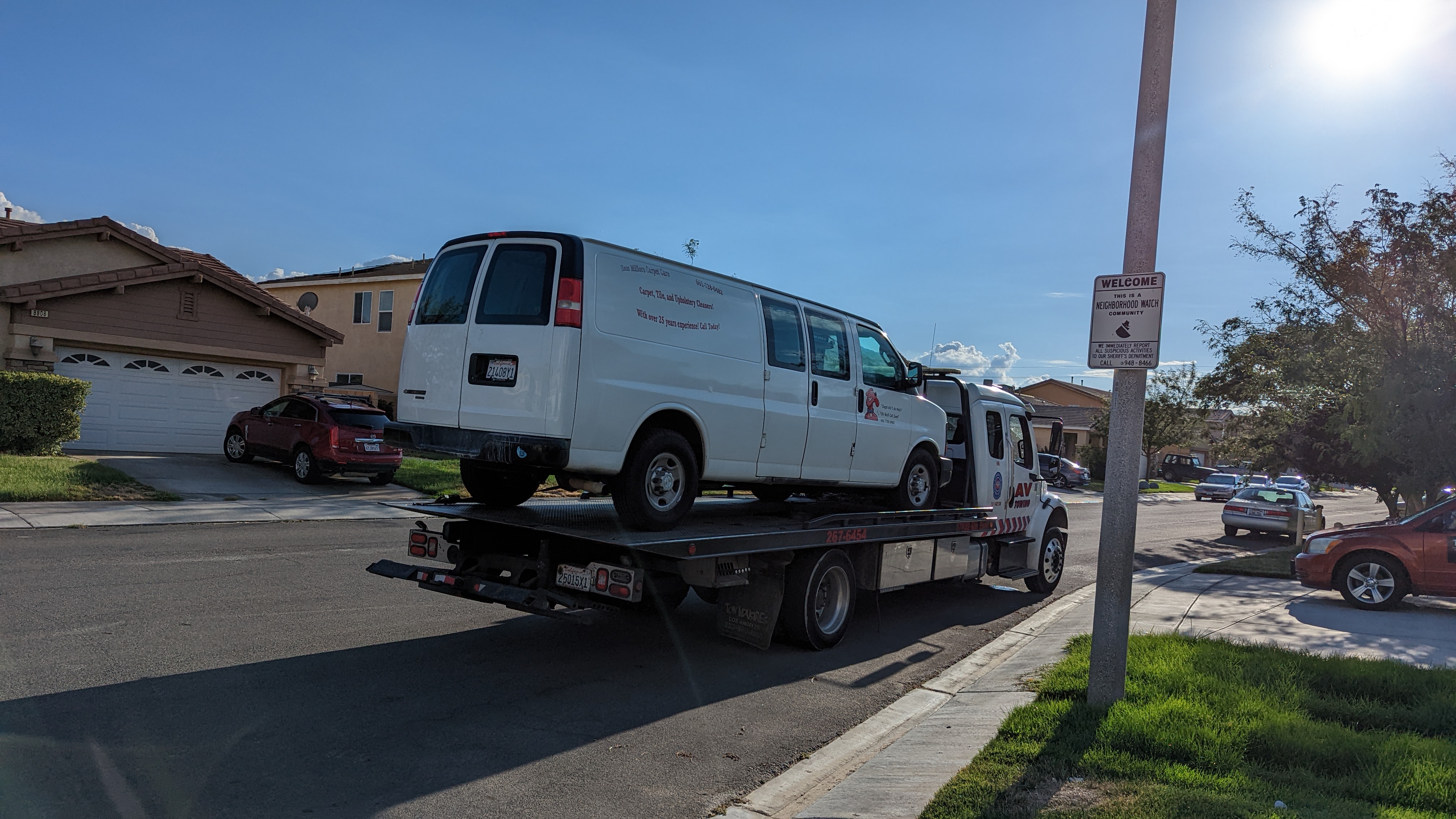

So my pro 1200 se a couple times.
I've refilled radiator fluid and I've since fixed the leak.
But I've forgot a couple times to put the radiator cap back on and drove off.
It's got about a 6 mile range before she blows the radiator fluid out and over heats.
That said I have to add water and more fluid and wait to get it back going.
Well I recently got a po 300 code random misfire.
In my haste I run out and buy $350 worth of new coils thinking that's got be it!
Also going to replacing all spark plugs and wires.
Should've started with spark plugs and wires.
These bad boys are melted on.
Internet guru car guys says yeah overheating can melt some stuff.
Oops!
Well I learned that after I spent the money on coils.
Ps they probably should be replaced.
But that's not the issue.
I hope it's a bad spark plug or wire.

Could be but there's still a misfire so hoping spark plugs and wires fix it
Most of the time you can tell if the wires are bad by looking at them, looking for cracks and sparks, and running your hands down them while the vehicle is running. If you get shocked, you know you have an issue. Spark plugs rarely go out and if they do then it means you have bigger issues going on. Now the coils... those are cheap Chinese crap. I believe your van has coil packs for each cylinder.
11,530
Yes it does$ 350 for a pack of 8 new at AutoZone

So I took @Cleanworks advice.
Sent it to a mechanic a po300 code is multiple misfires, and there is a boat load of possibilities.
I did manage to replace 7 out 8 spark plugs and wires.
They say a fuel pump going bad can cause this code too.
