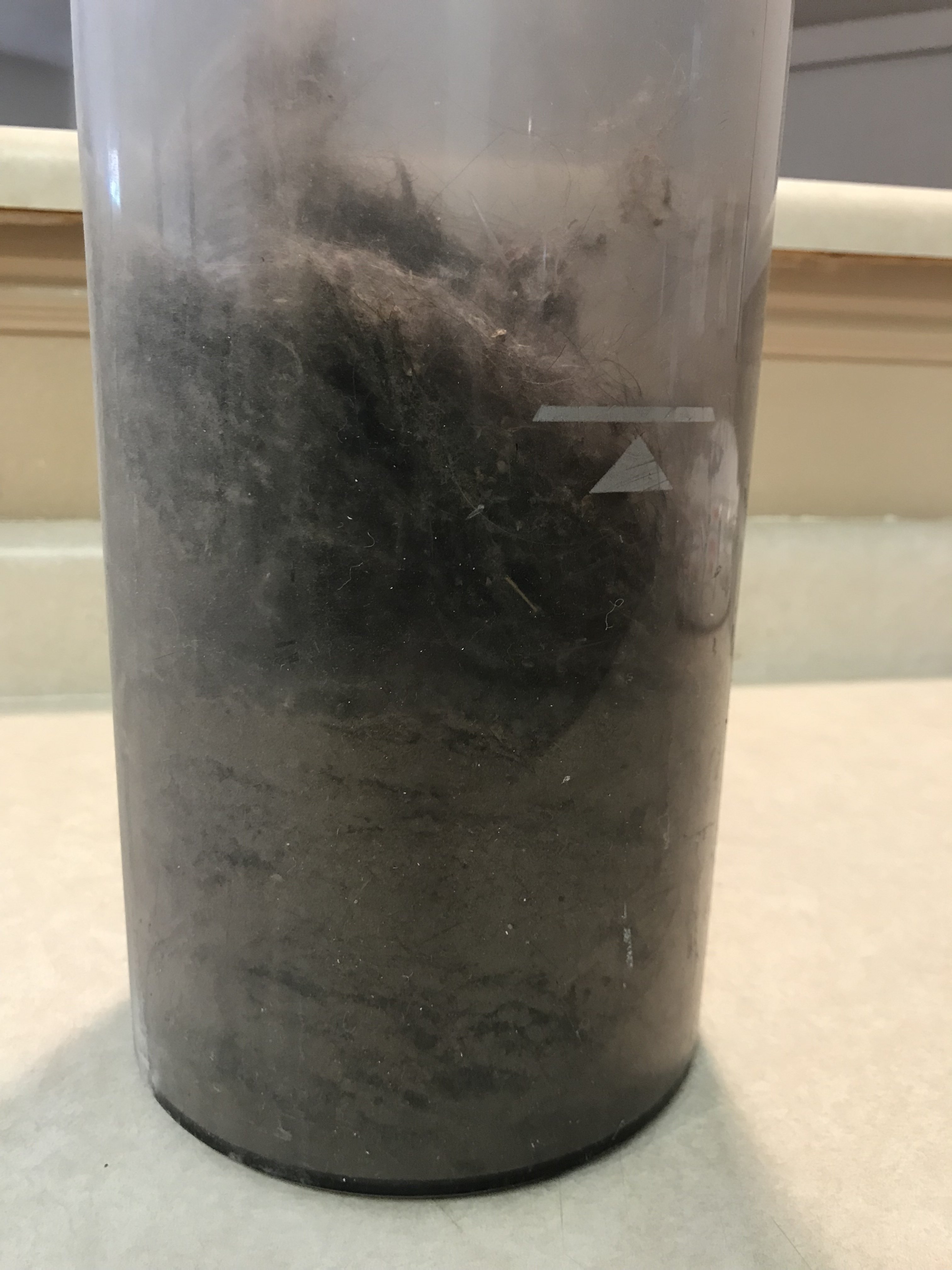

Here’s a pic from a job yesterday. This is from one room and every room filled up the bin.
12,841
All of that material is feeding and breeding grounds for the bacteria that leaves a place with a "doggie"/"dirty sock" odor after cleaning.
