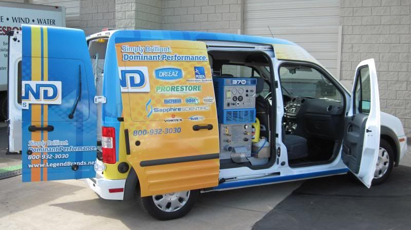

Sapphire had a 370 TM in a Transit Connect but they built a frame work to mount it to. No fresh water tank either, not sure if you could get a submount a tank without causing weight problems.
I'd love to have that new design, those are really sharp little guys! Lets see how the year goes, but right now I can't afford one.

Is that the rig I saw at Mikeys Fest in Nashville a few years ago? Do I remember correctly that there were no water tanks crammed in there?

The SS370 Economy Transit Package is $1131.00 more than just the SS370.
The package comes with the frame, fuel tap, 25 gallon waste tank AND a auto pump-out.
It really is a sweet setup.

That is cool. I'm glad it doesn't cost $5k. I really dig that set up.

There is not much room left in the cargo area. You could fit something like the HOSS but that's about it.
Even with the additional weight in the Transit it still drives very well.

New Info for Transit Connect
Ray wanted me to post this due to the update from Sapphire Scientific that we received this afternoon.
Technical Service Bulletin
Subject: 2014 Transit Connect
Due to a large reduction in the payload limit along with a decrease of useable floor space,
Sapphire Scientific will no longer provide console packages for Ford Transit Connect vans
years 2014 and up. The 2014 Transit Connect payload limit is only 1270 lbs. There is no
console configuration we can recommend for such a low payload. Our current mounting
frame configuration also does not fit within the reinforced mounting locations located
in the 2014 Transit Connect.
Sapphire Scientific will continue to support 2013 and previous models of the Transit
Connect with our model 370 and Rage packages.
