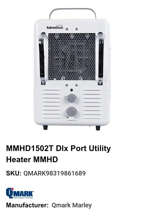

I did a ton of research and all electric portable small space heaters just randomly stop working pretty frequently, even worse others begin smoking, and whatever else. I found this thing, it goes under several different names but it is the same thing it seems. About $100. 1500 watts, analog, and they've been making the same exact unit for like 30 years. They hardly ever fail, simple. Don't get something that costs $30 or $40 and looks similar, it will be risky trash.

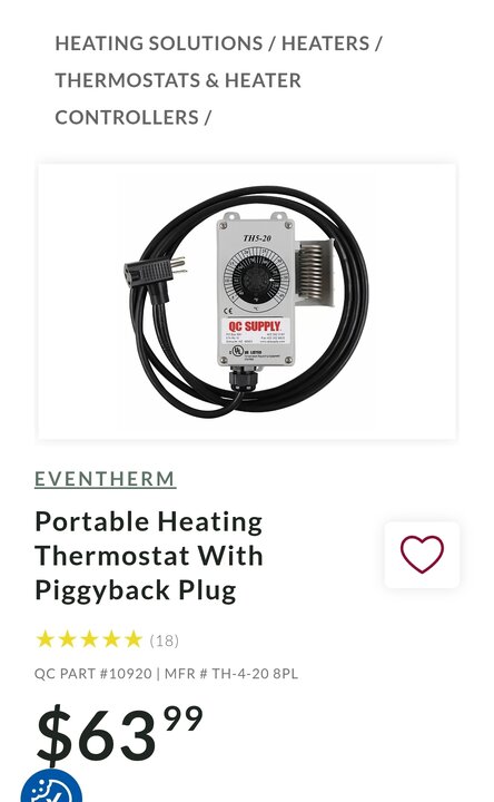

And then I got this thermostat because I have found that onboard thermostats in small space heaters are not reliable, and digital ones just randomly stop working in a short period of time. And the Marcell temperature monitor send alerts to my cell phone if the temperature drops below a certain level as a fail safe in case the electricity goes out or the heater stops working. I then mounted everything and wired up an electrical box and outlet and mounted it in my van so it is all neat and easy to plug in with an extension cord from my garage each day.

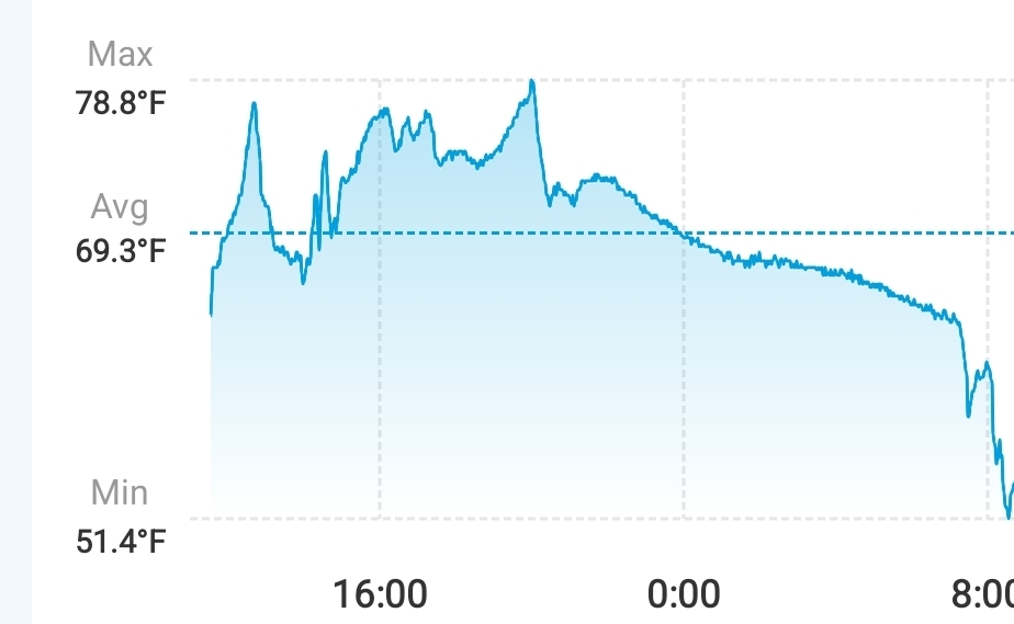

We dont even get that cold here but I went ahead and did a cheap vevor diesel heater with 1.9gal tank in it last week as the high tops are harder to keep warm. My test last week in the 40s showed it kept 20+ above ambient outside on setting 3 or 10 so I am feeling good this year.
Last year we got some 15-18 degree weather which almost never hits us in West Texas that cause me lots of sleep loss and even put 2 electric heaters in the high top on different circuits to fight that odd all cold weather here.
That was the graph of my test with it being about 42f overnight. Dropoff at 7am was me with the doors open and heater off checking it out. Really easy to install in 10-20 min and total cost was about $150.

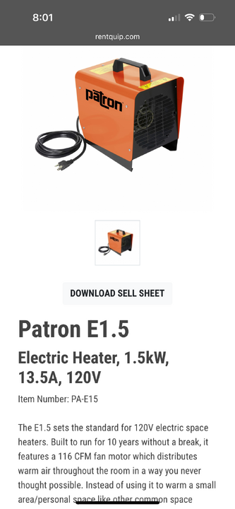

Isn't it just going to output the same as all other $50 1500w heaters? 5k BTU output for the patron, 20k BTU heat output for the diesel heater.
The peace of mind he speaks of is that it runs well and continuosly without malfunctioning in the middle of the night. Just like the $100/1500 watt electric space heater I posted. Maybe it distributes warm air throughout the van better with a more powerful fan too. I imagine it's worth the small decrease in power to the heating element to circulate heat more effectively.

It just heats differently… I have one in my garage, and when I’m to lazy to take my van to the shop (after a 16-18 hr day), I throw it in the van, set in on low, and the van is a sauna in the morning…
It’s built for commercial use.
It’s designed to run CONTINUOUSLY for 10 years… not like the other plastic junk on the market.
Convenience; it’s plugs into a standard wall socket (make sure it’s a dedicated circuit).
No playing around with messy fuels…
Just my experience.

Is a 1500w electric heater enough though?
I struggled myself last year when we dropped into the teens where I had to run two different electric heaters with two different circuits. I woke up at 2am and saw the van temp was still dropping at 35F in the van with 18F outside with the electric heater running. My ass stayed in the van for an hour with it running with the heater on to get some more heat in there before I had to put another one in there so I could get some sleep. For reference we are talking an uninsulated promaster high roof van. We almost never get into the teens, very odd for West Texas but I thought those with the harsher climates would hit these issues regularly or need to winterize completely.

Purchase one, and report back your results…
6,563
I would be very surprised if this not enough for even the northeast…
When you put the van away for the evening, make sure the heat has been running for the last 1/2 hr on the van.
Put the heater in the back, start it up, make sure there are no combustible material within 2’…
And enjoy peace of mind….

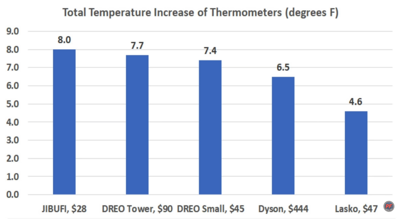

Well I mean we have actual data from plenty of sources almost all quality 1500 watt heaters will provide a very close increase in temperature. See screenshot from project farm electric heater test. Patron heater linked would be very similar to my test results I noted above which kept the van about 10-12 degrees above ambient in my testing last year. So when you are 24F cutting it close, 22F and below would be no bueno for 1500w electric heater.
I would note that if $125 solved my issue over the same priced diesel heater without the install time and fuel that takes I would jump on it, but I don't think the data supports that.
Source for data in image:
View: https://www.youtube.com/watch?v=ND2mrzPnBic
