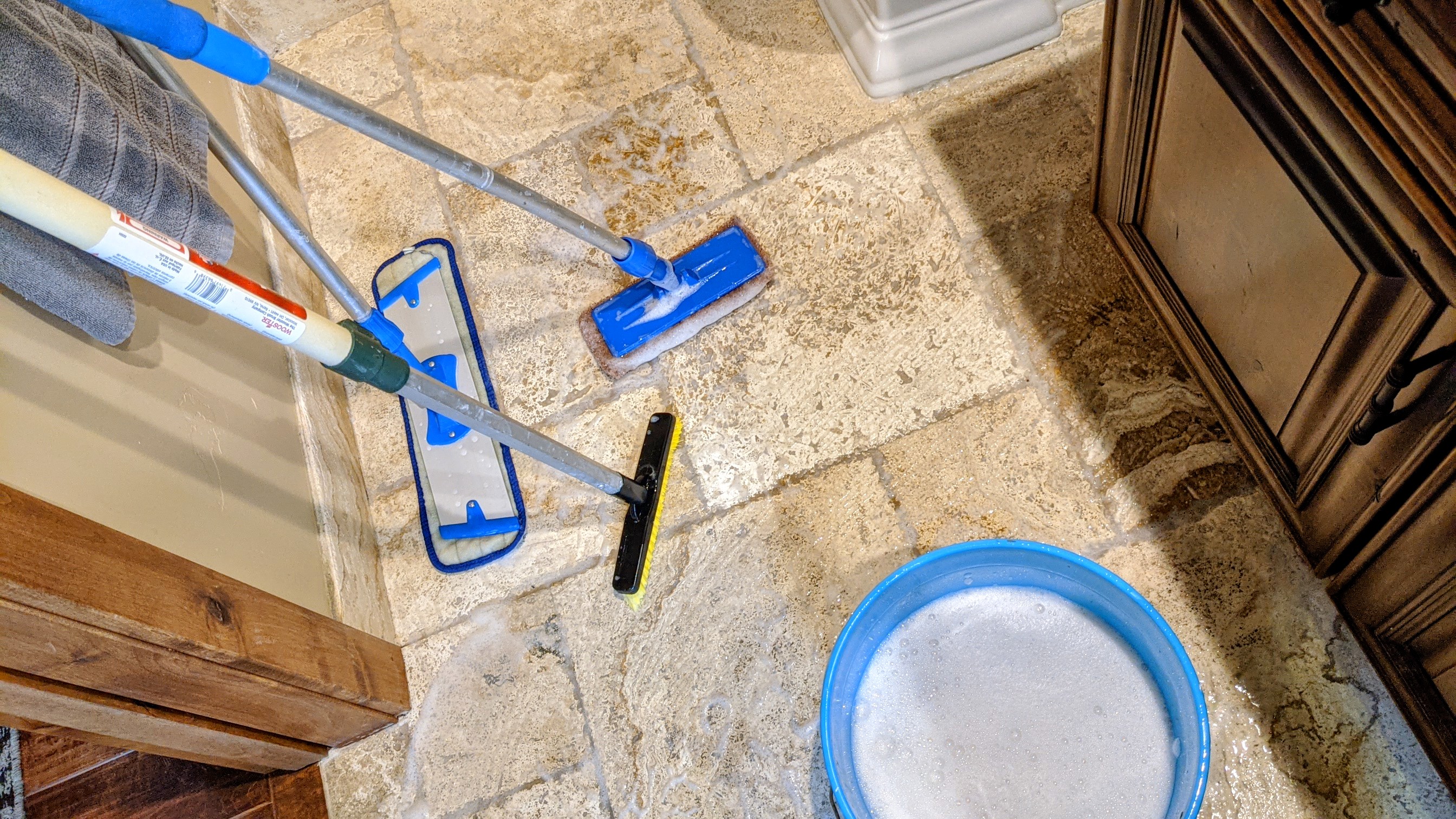

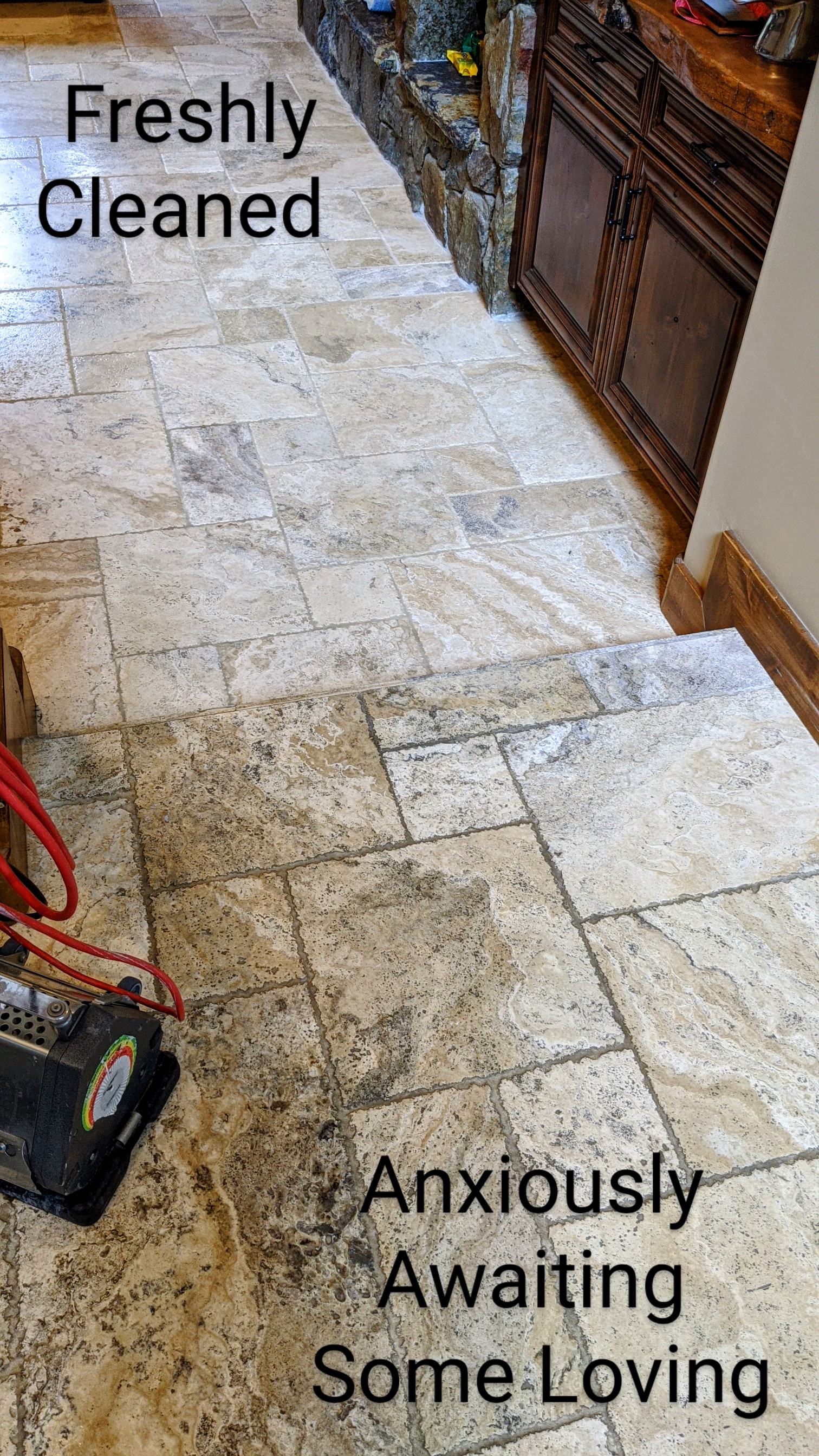

$2300 of travertine @ family room, staircase, entry, hallway three baths w/ showers...
6 hours of bustin arse.
