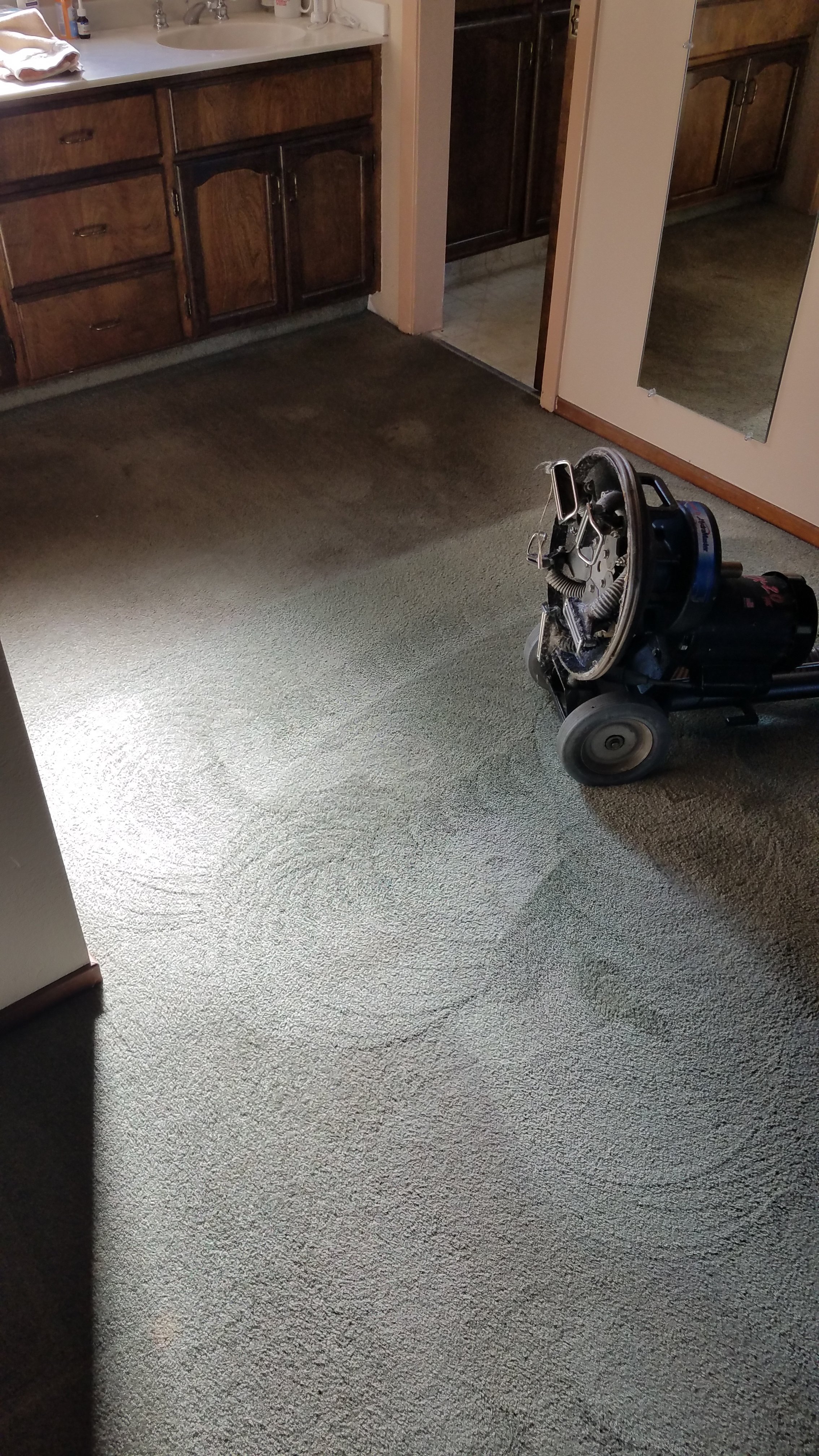

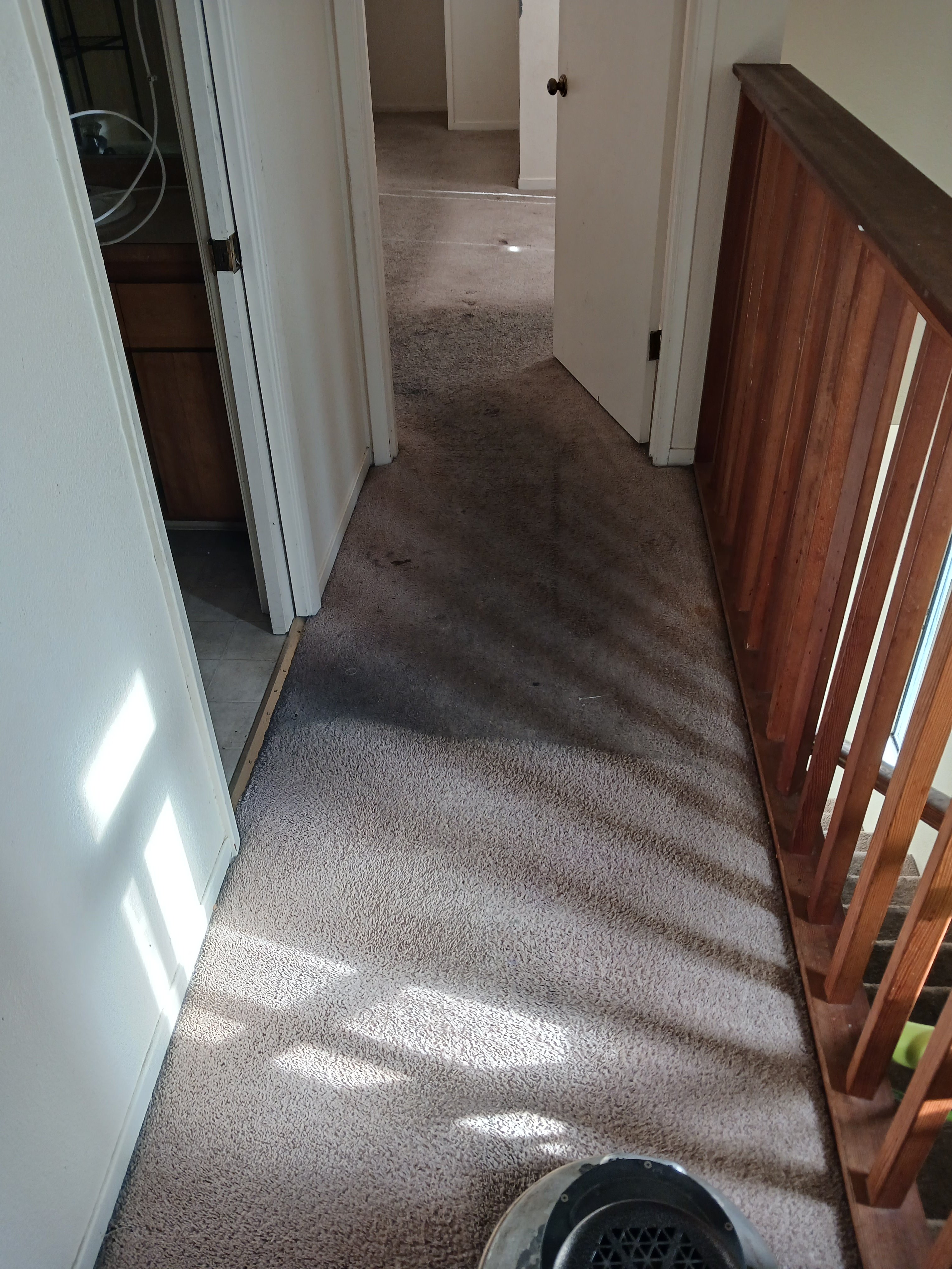

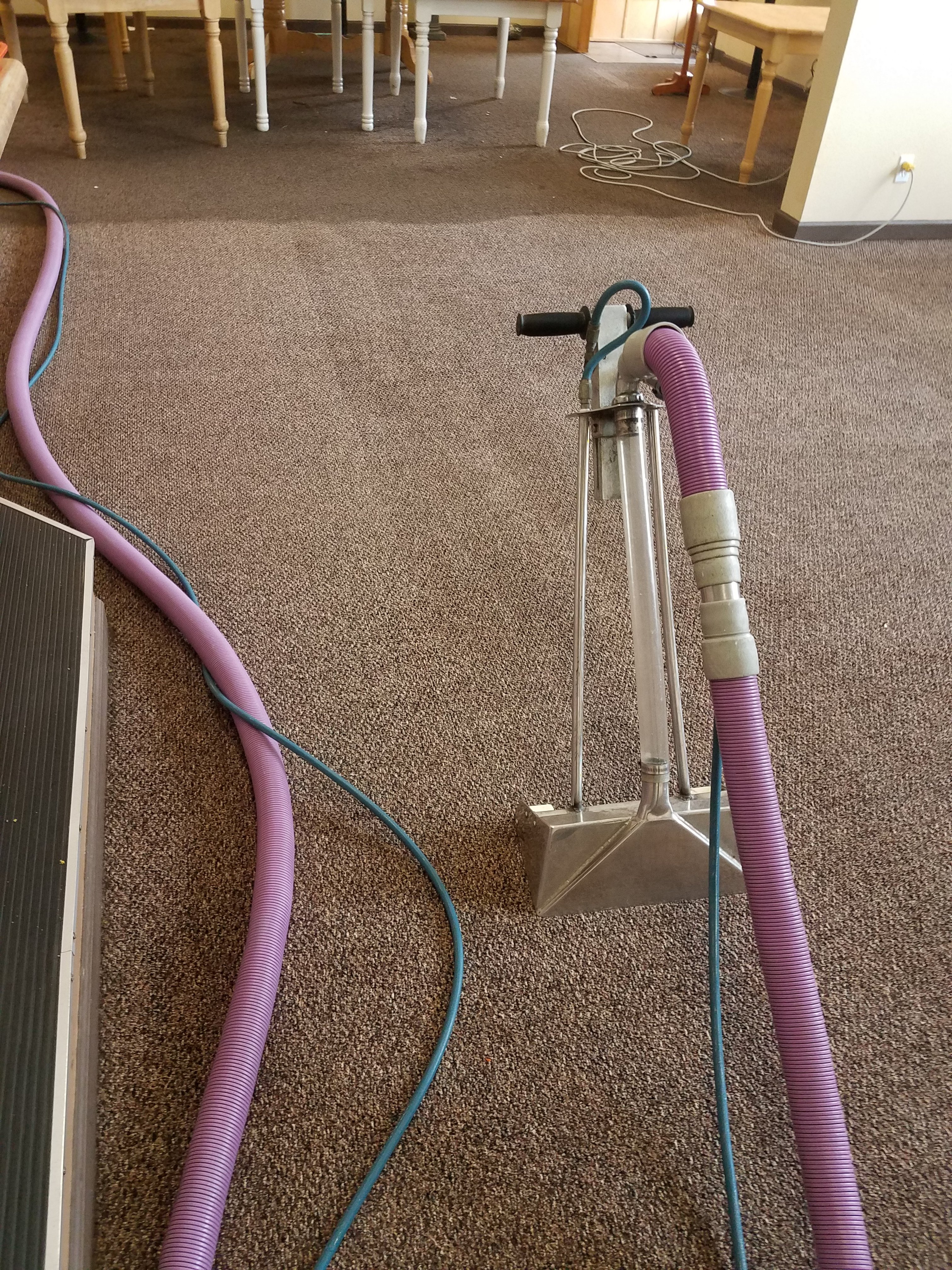

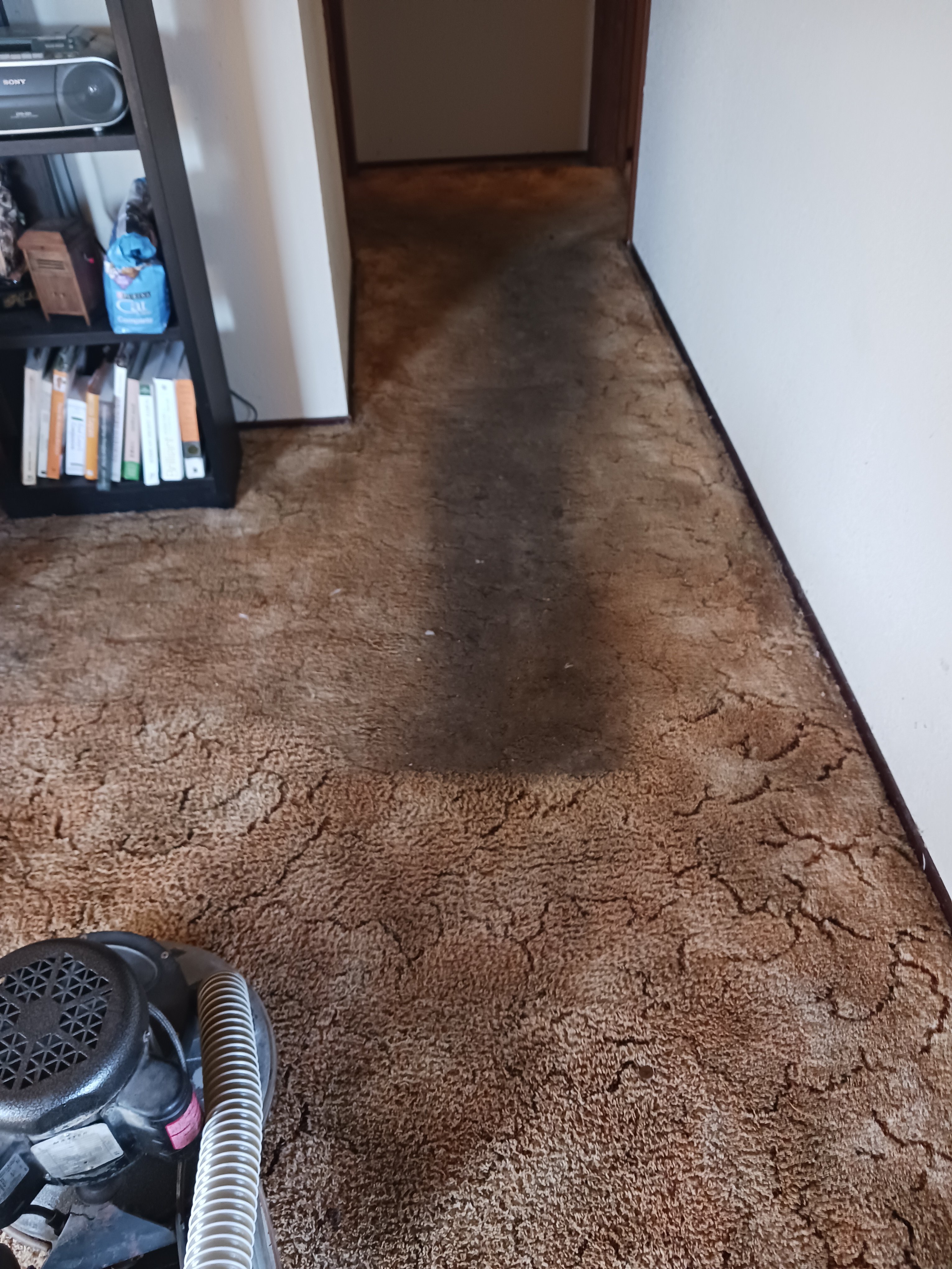

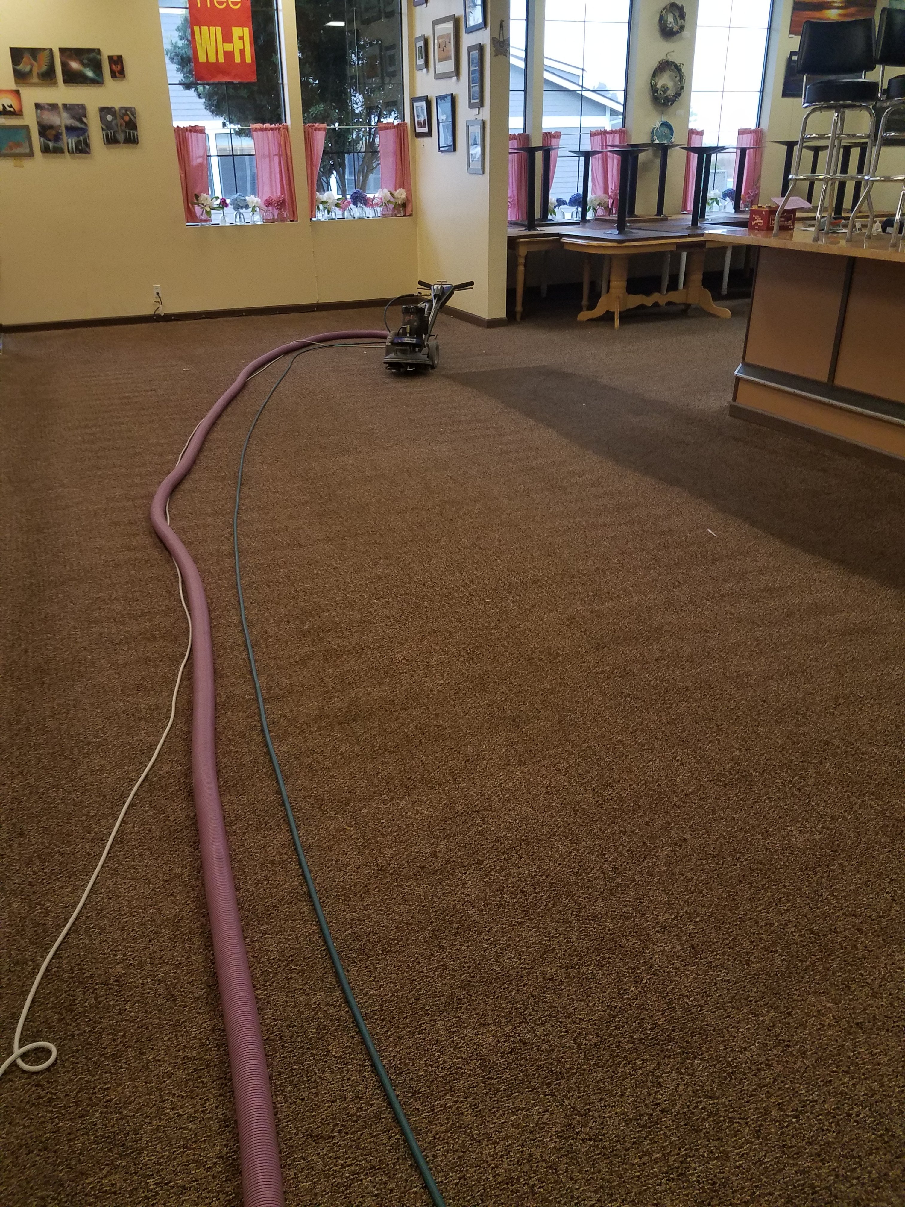

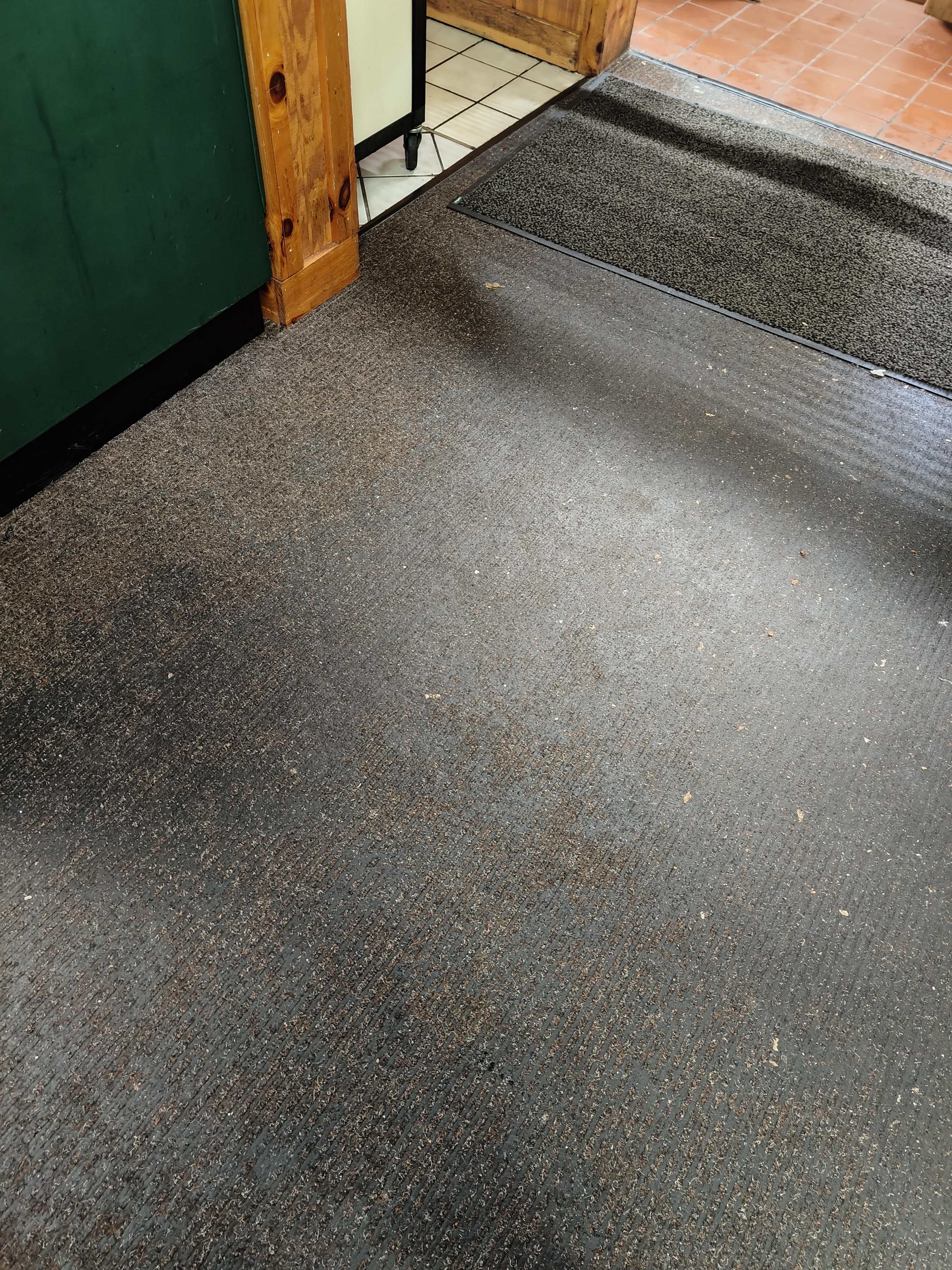

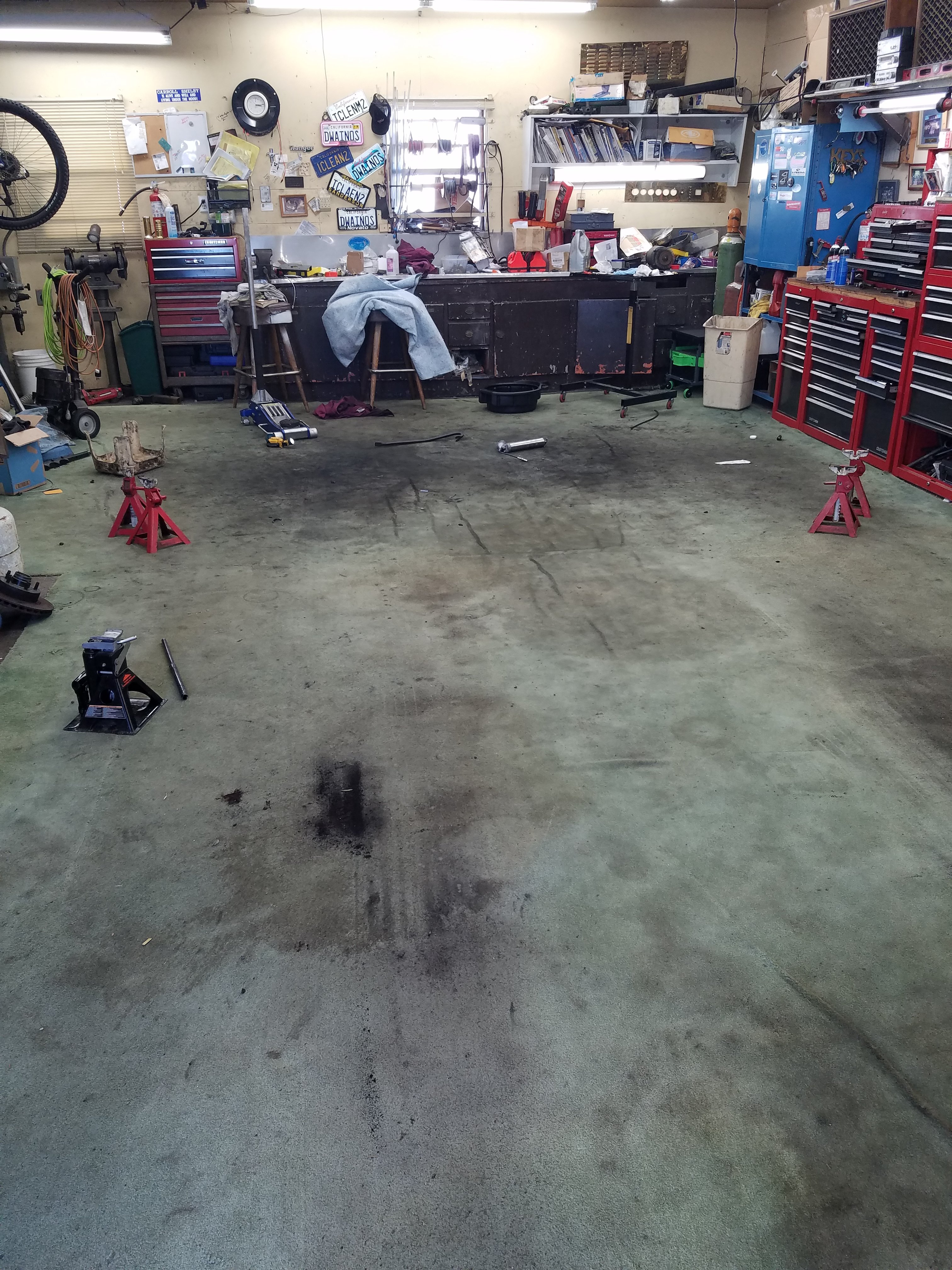

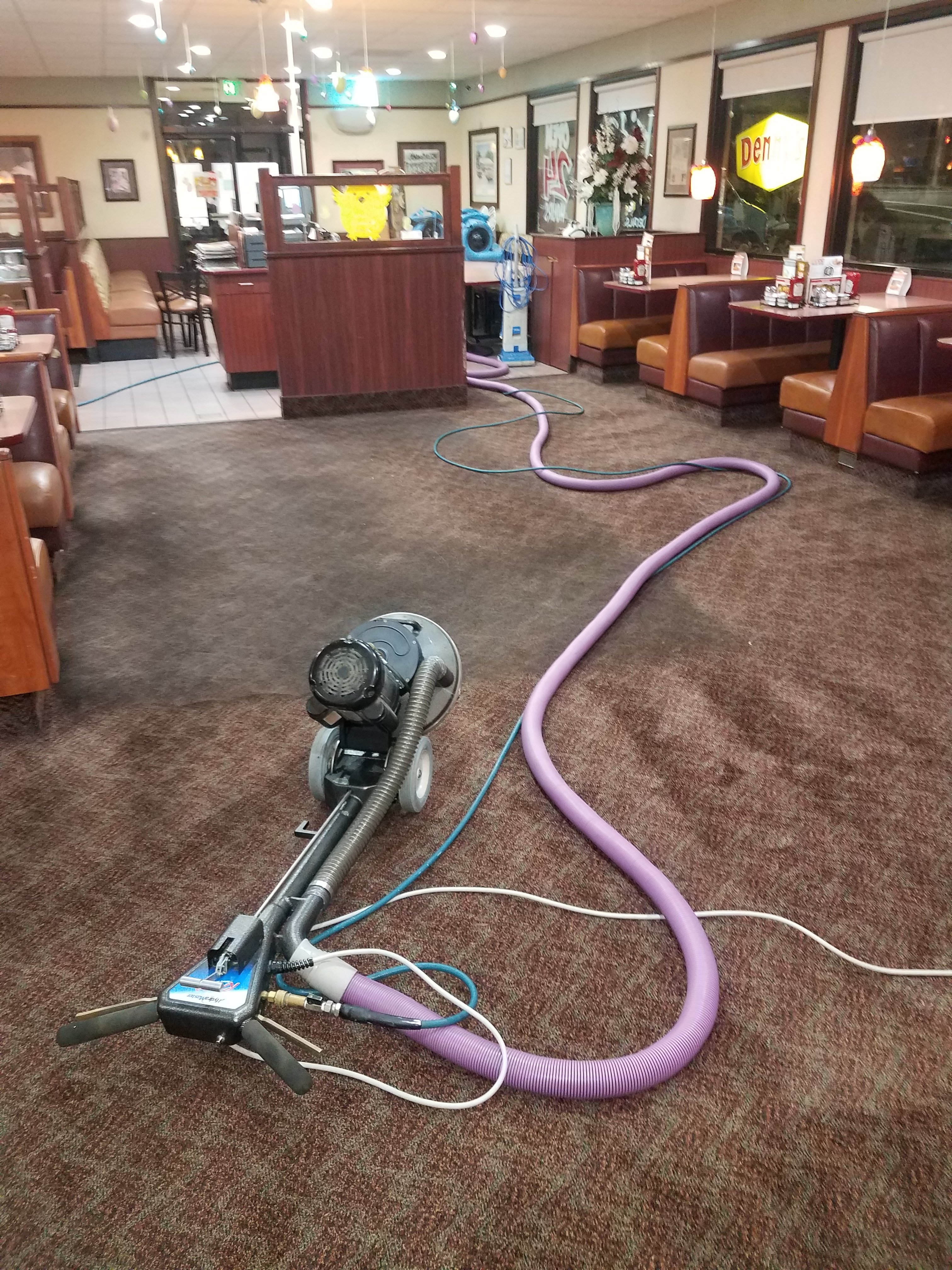

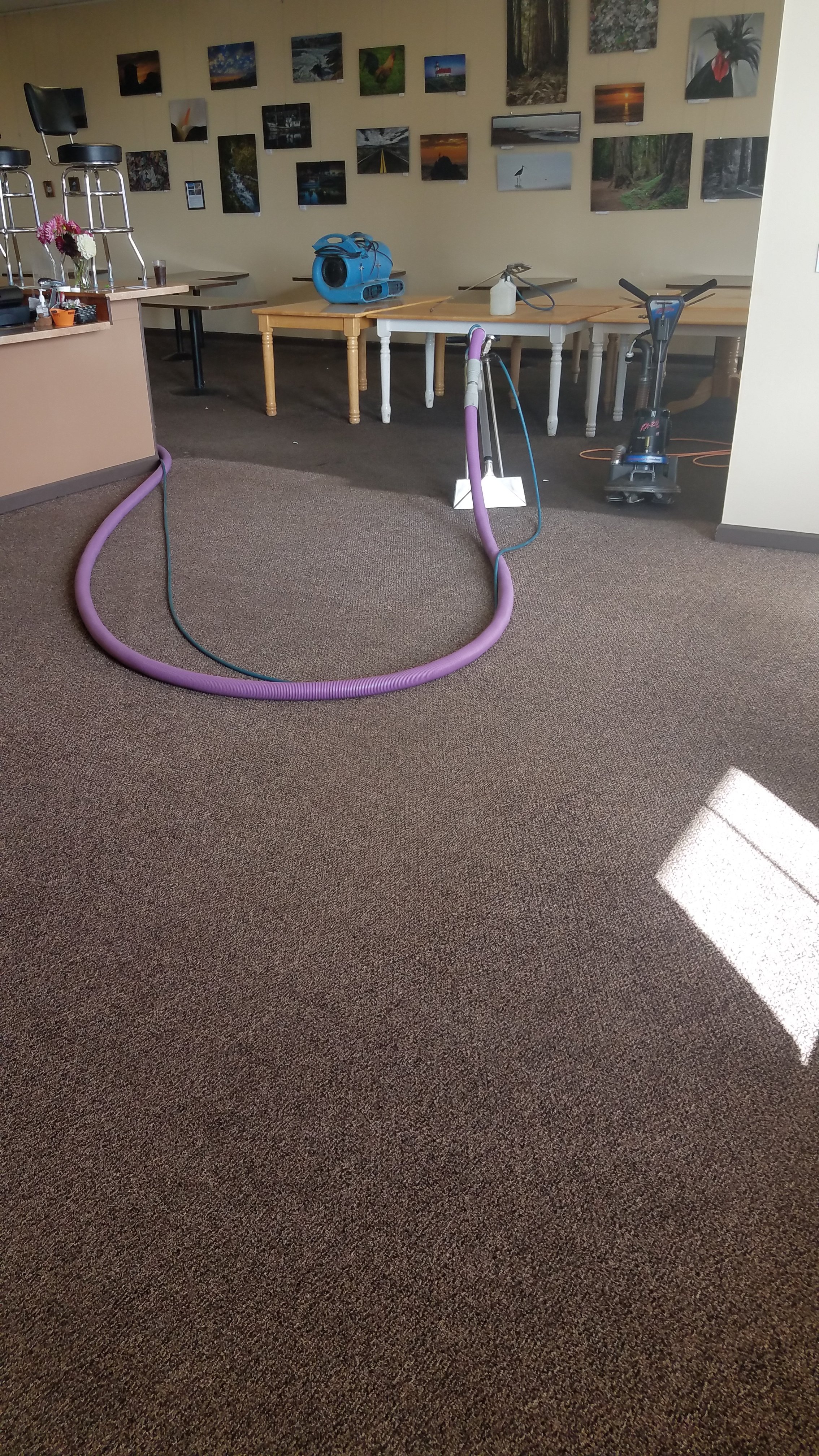

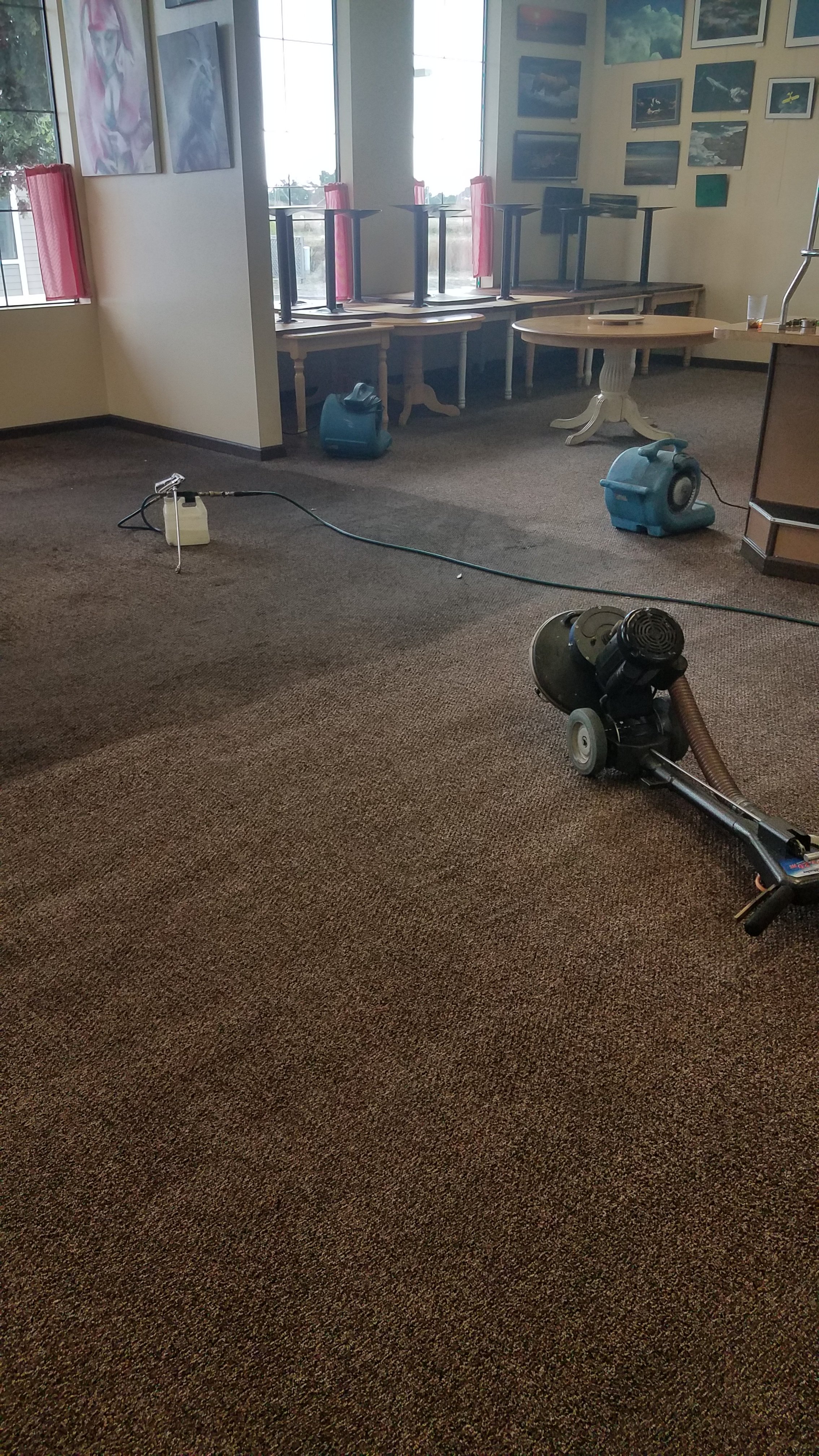

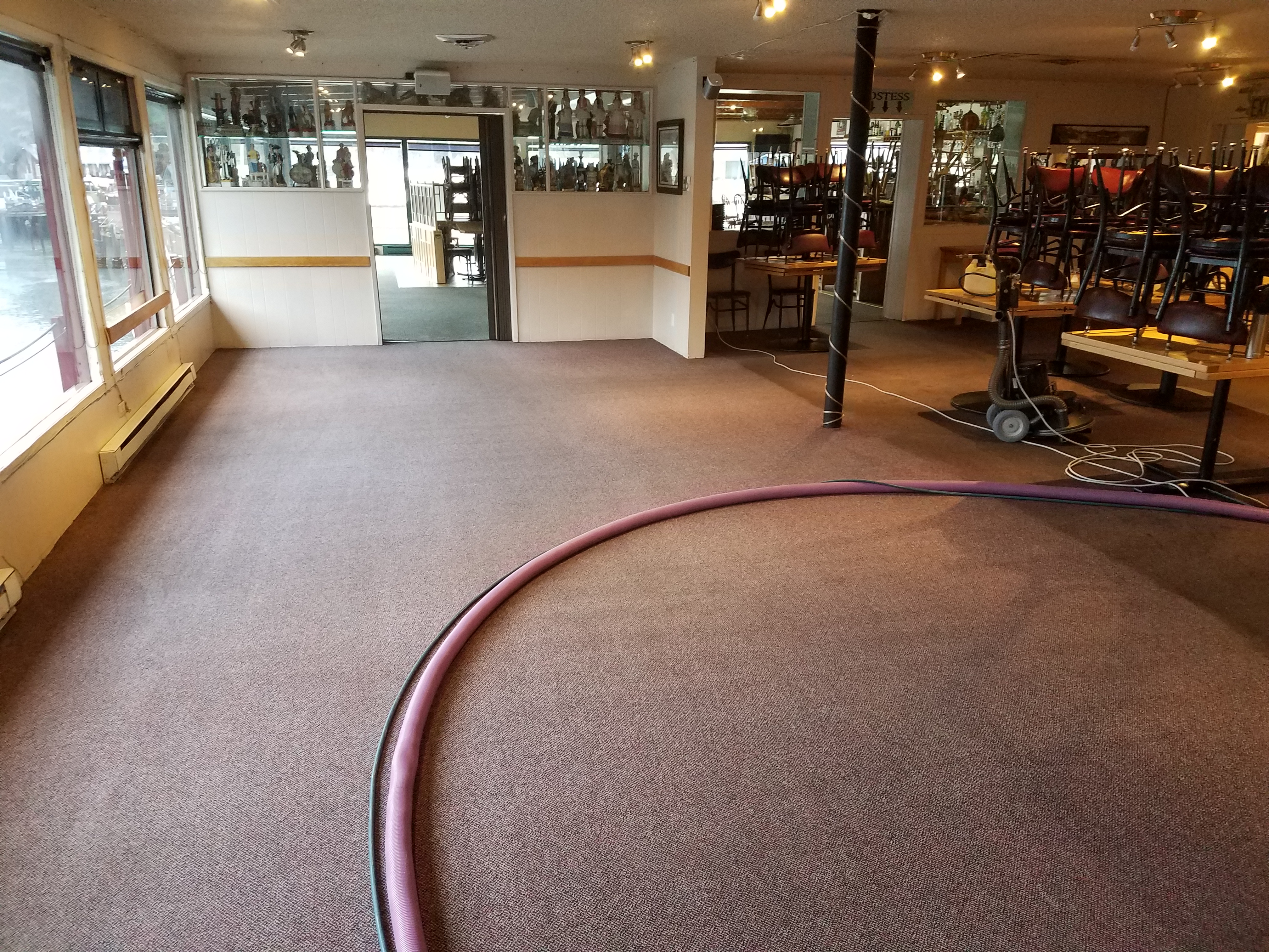

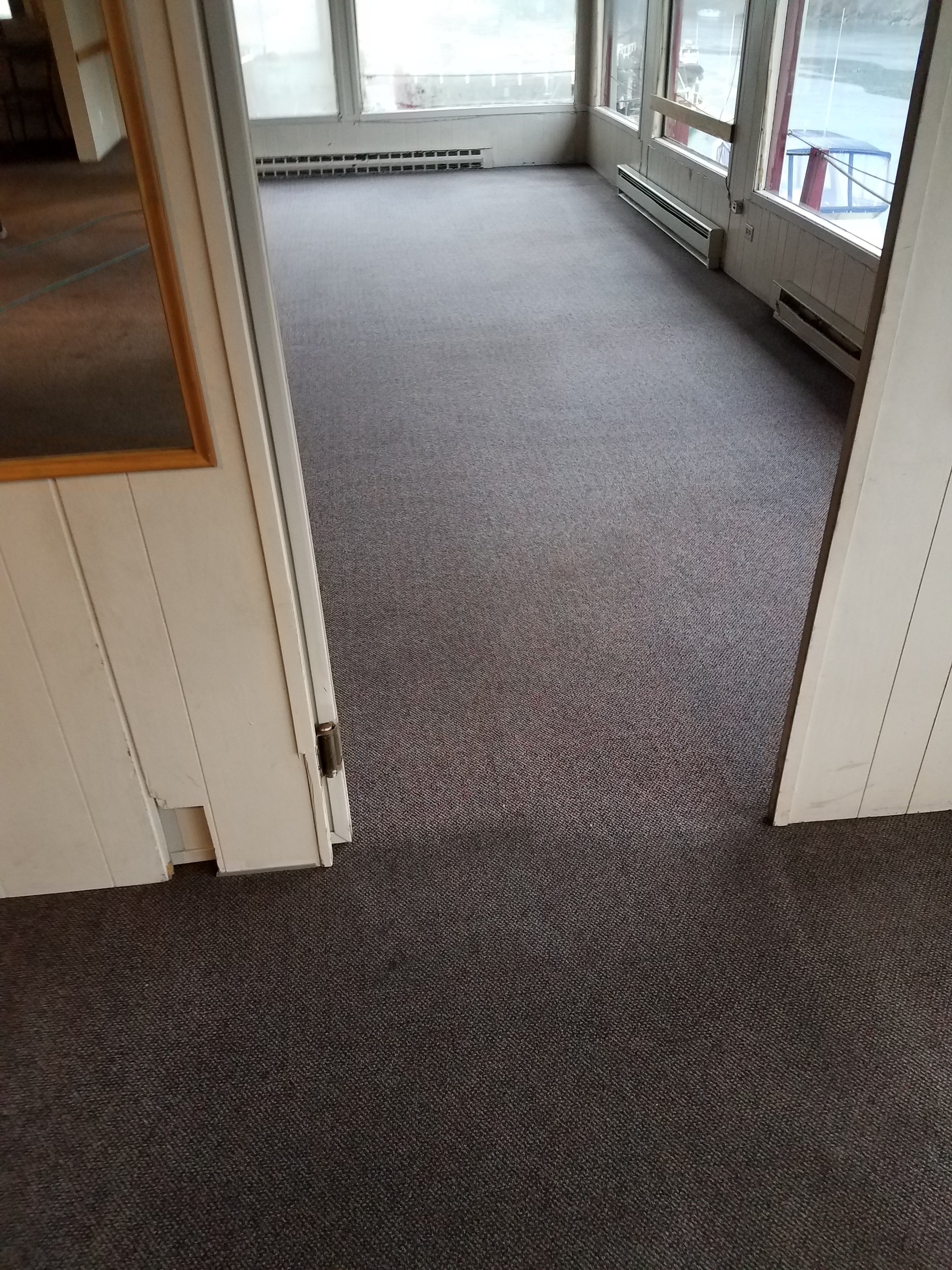

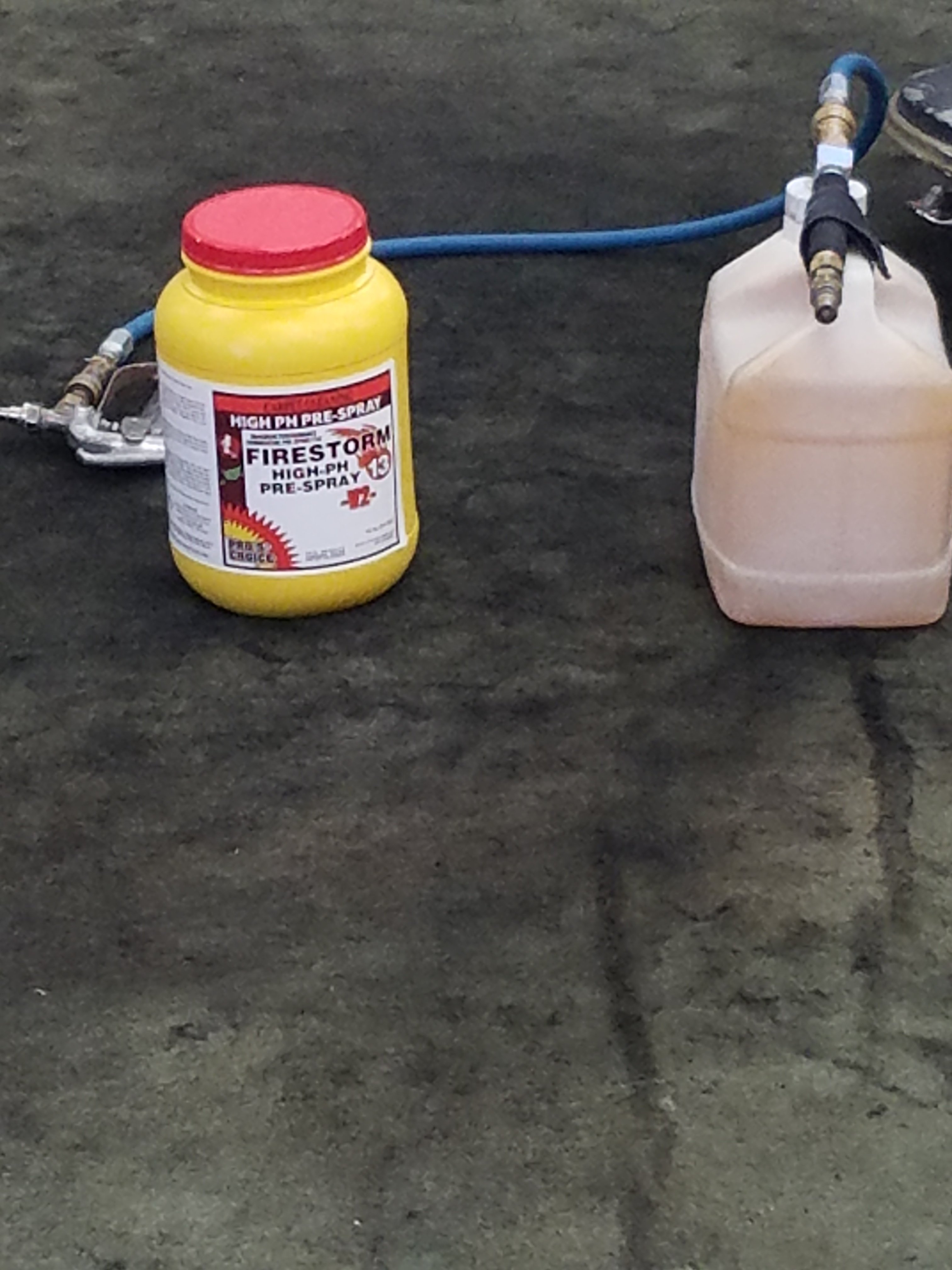

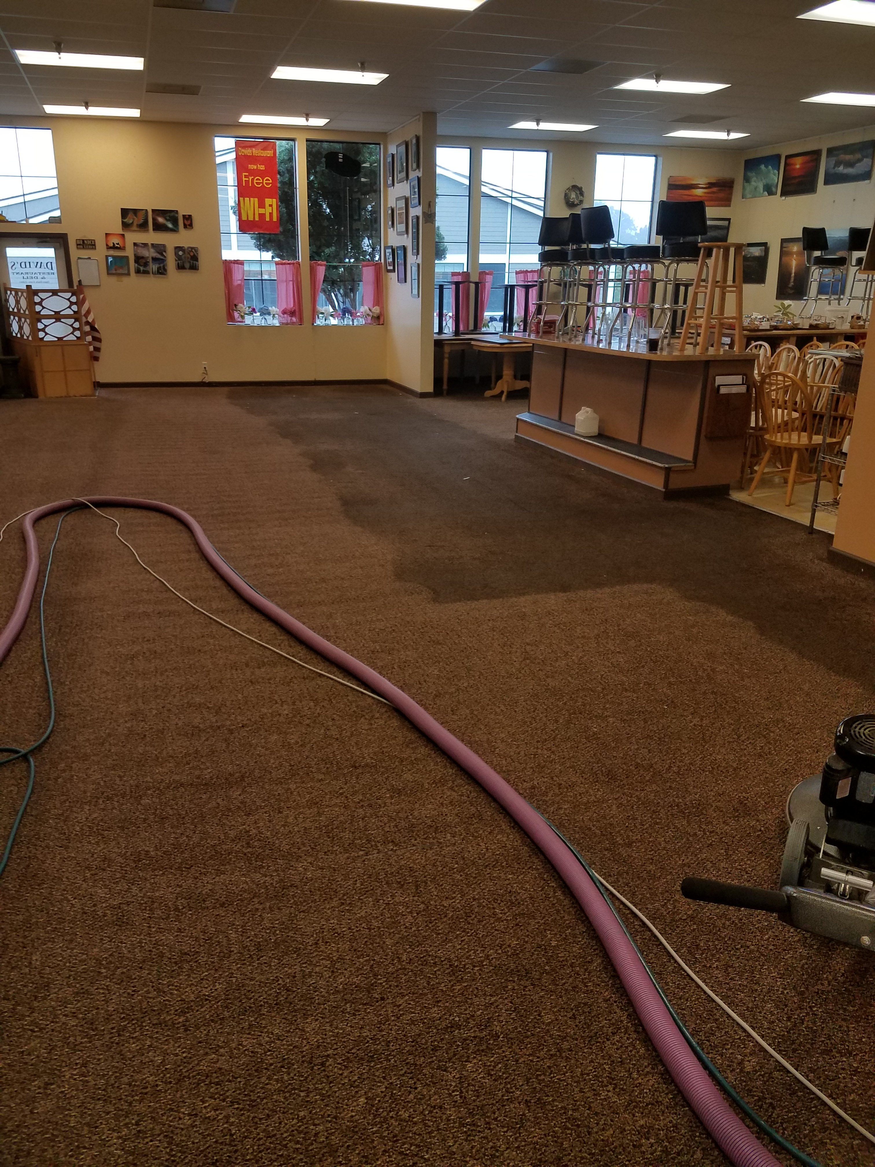

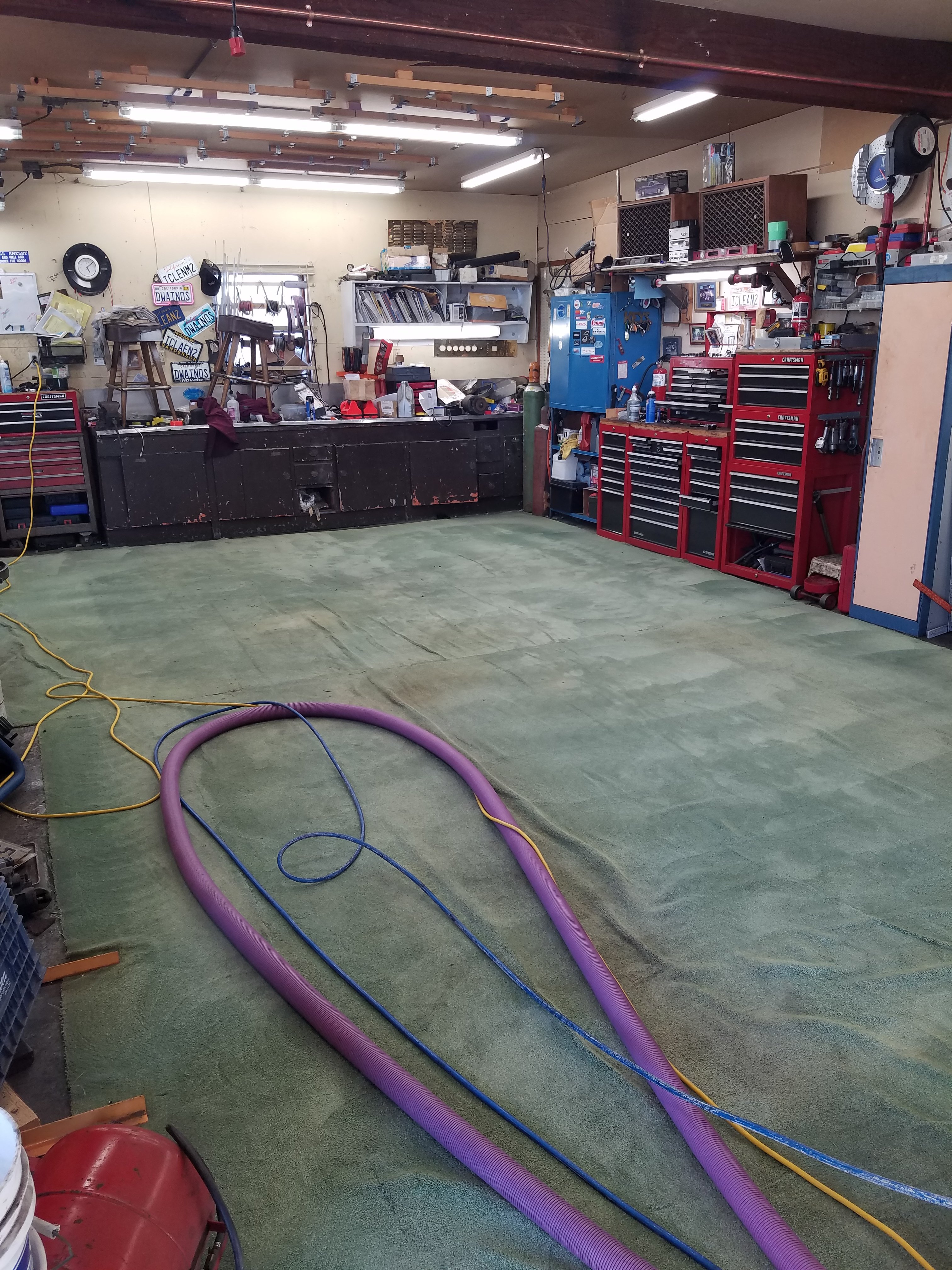

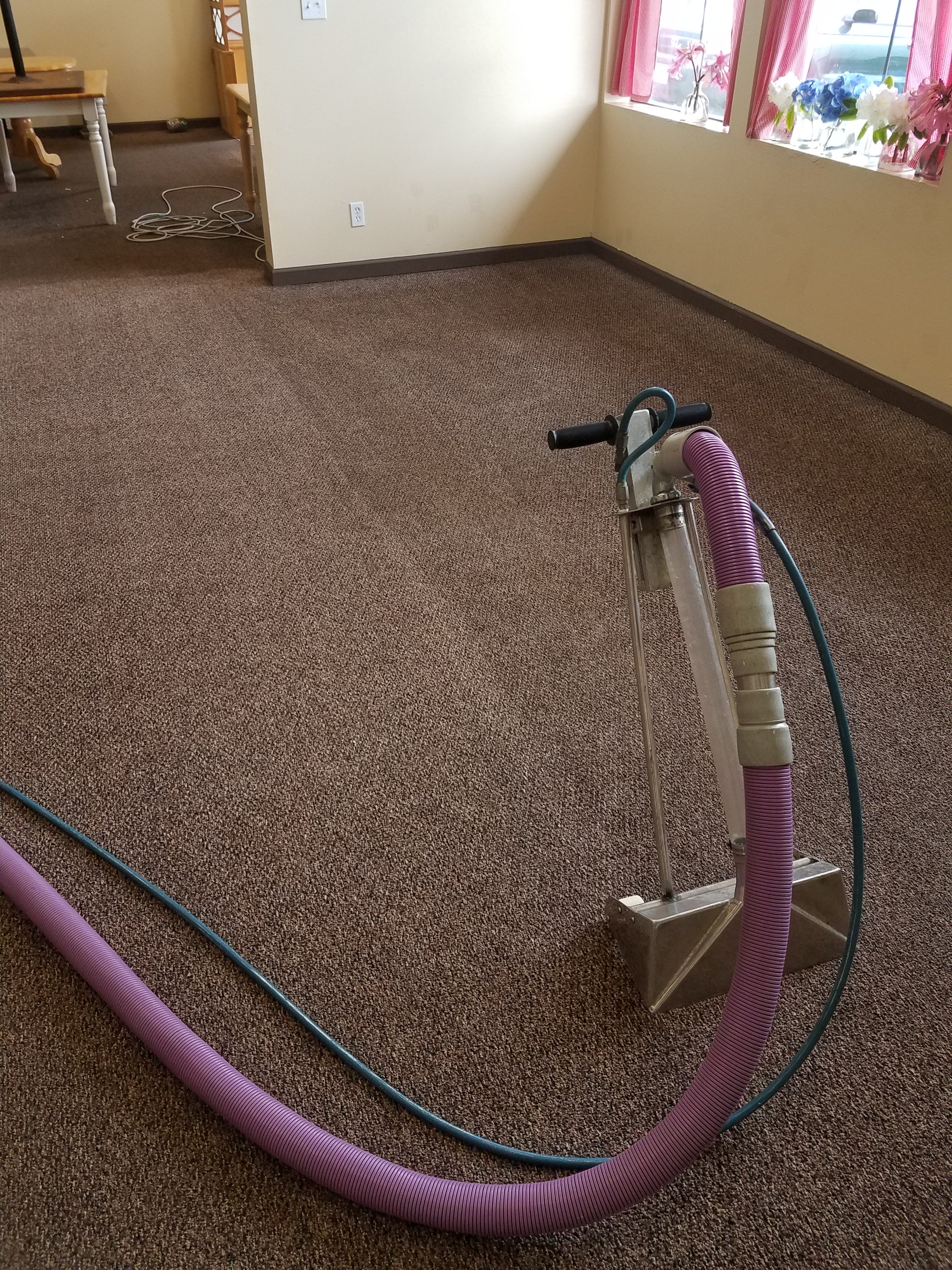

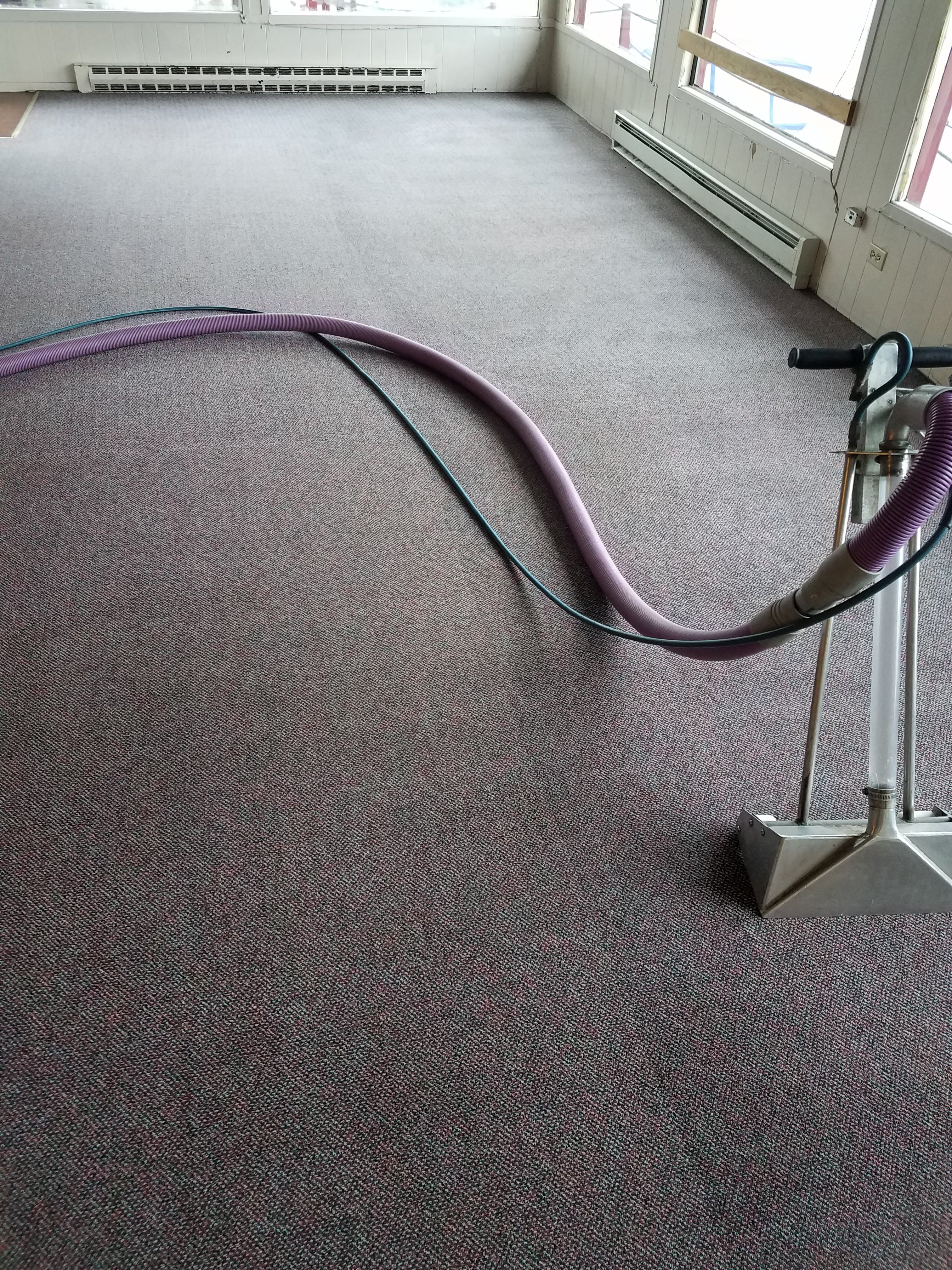

I removed everything from restaurant grease to axle Grease with firestorm, if it's really really really nasty i add 2 cups hydrogen peroxide to prespray and the same to each 5 gallon jug of emulsifier (or equivalent in powdered peroxide) and that's it
Pictures of restaurant carpet it was let go because it was going to be replaced but new carpet kept getting back ordered and back ordered till my customer couldn't stand it anymore. Shop carpet pictures is my shop after completely rebuilding the front end on my 3500 chevy van yes i do do all my repairs on wall to wall carpet. Nothing like taking off your shoes and changing oil in your stocking feet🤗🤗
