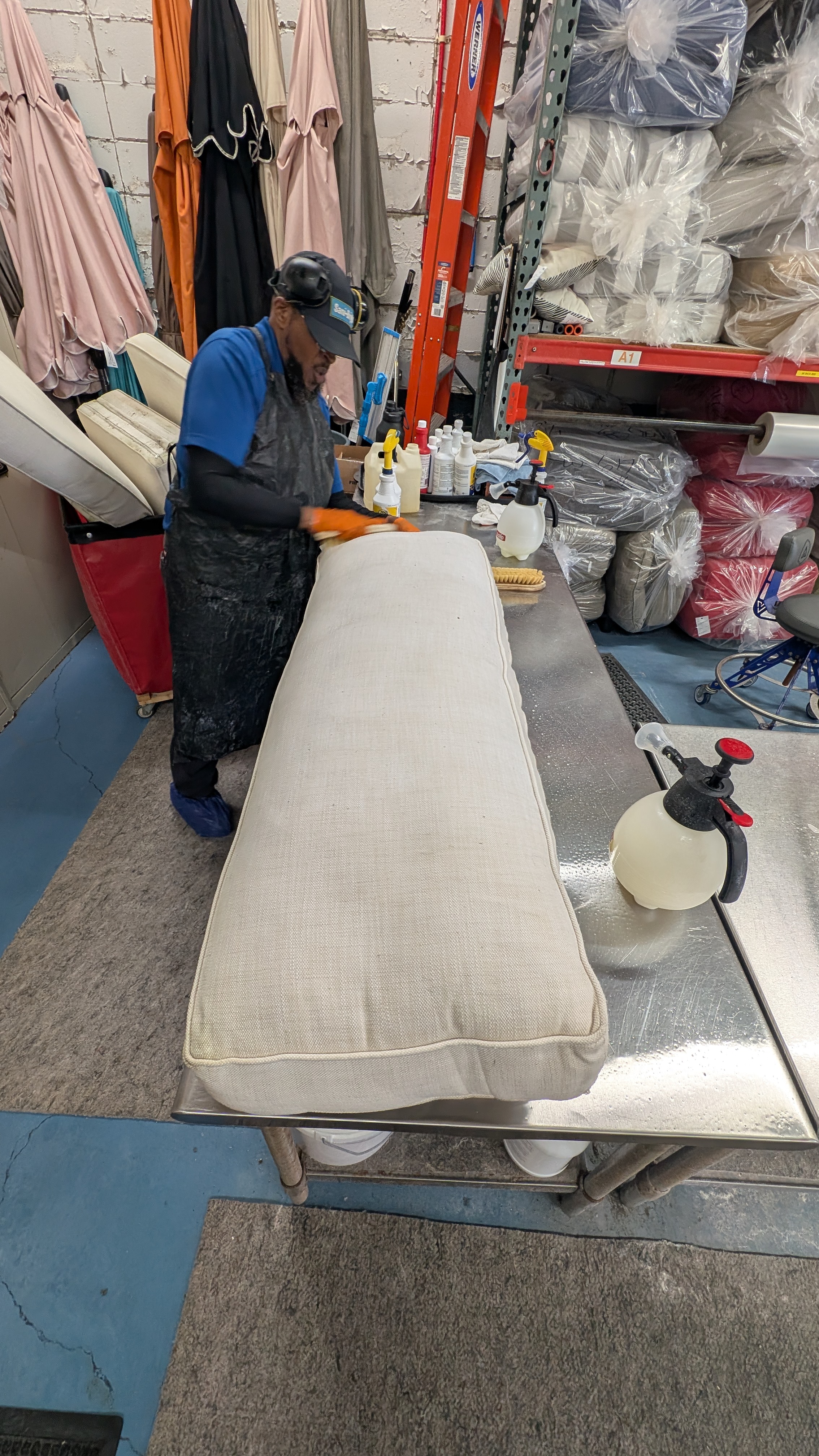

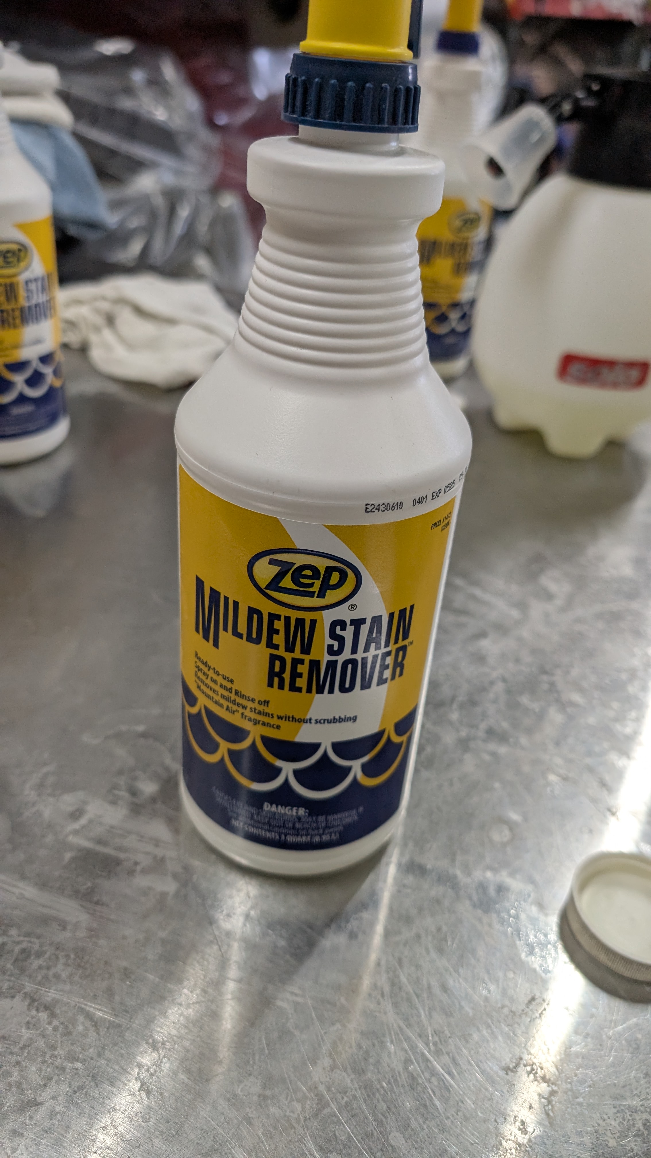

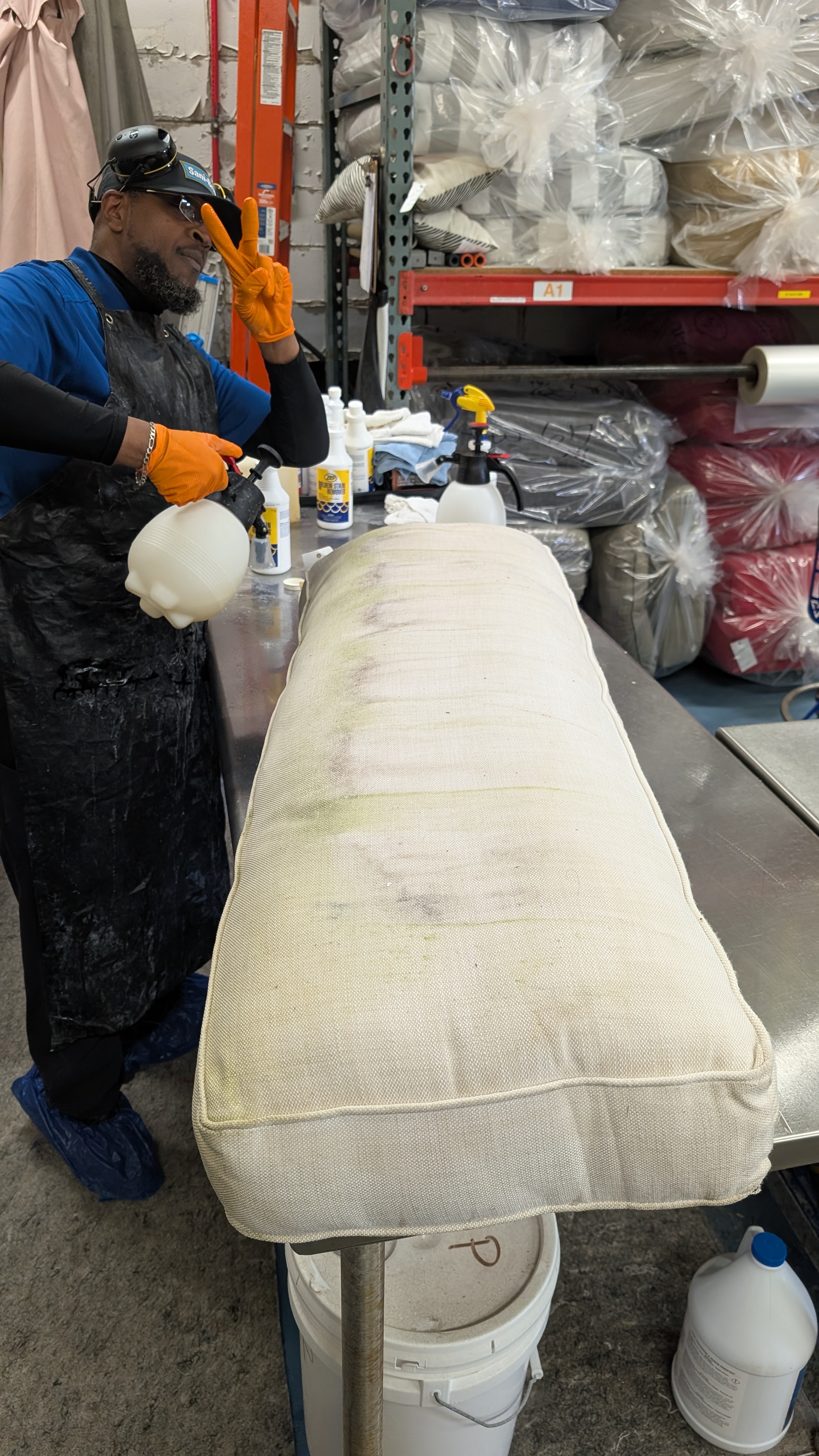

Zep mildew stain remover. Miracle in a can
116,044
Pre vacuum
Pre rinse
Apply enzyme cleaner
Rinse
Apply Zep
scrub
Dwell
Rinse
Repeat Zep if needed
Rinse
Dry
PXL_20250122_201213361.jpgPXL_20250122_201204045.jpgPXL_20250122_201646809.jpgPXL_20250122_201822807.jpg

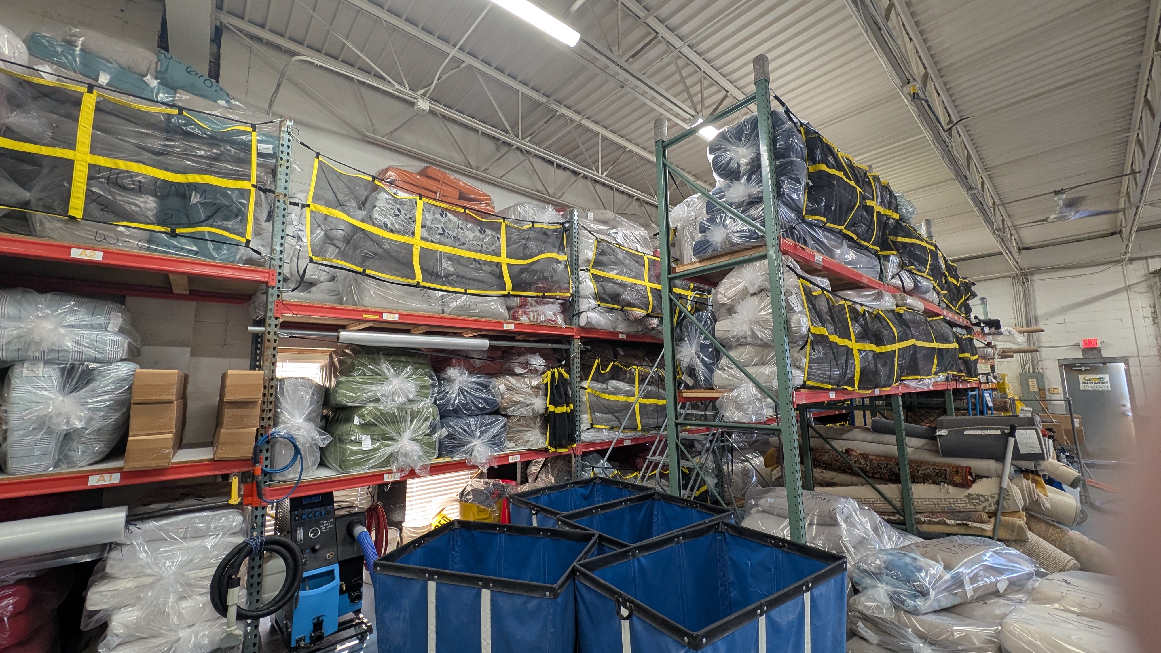

Joe’s shop was FULL of patio cushions (stuffed to the rafters, in every corner), he was doing a clean n winter storage system???

And is that Zep a chlorine or peroxide based mildew chemical?
