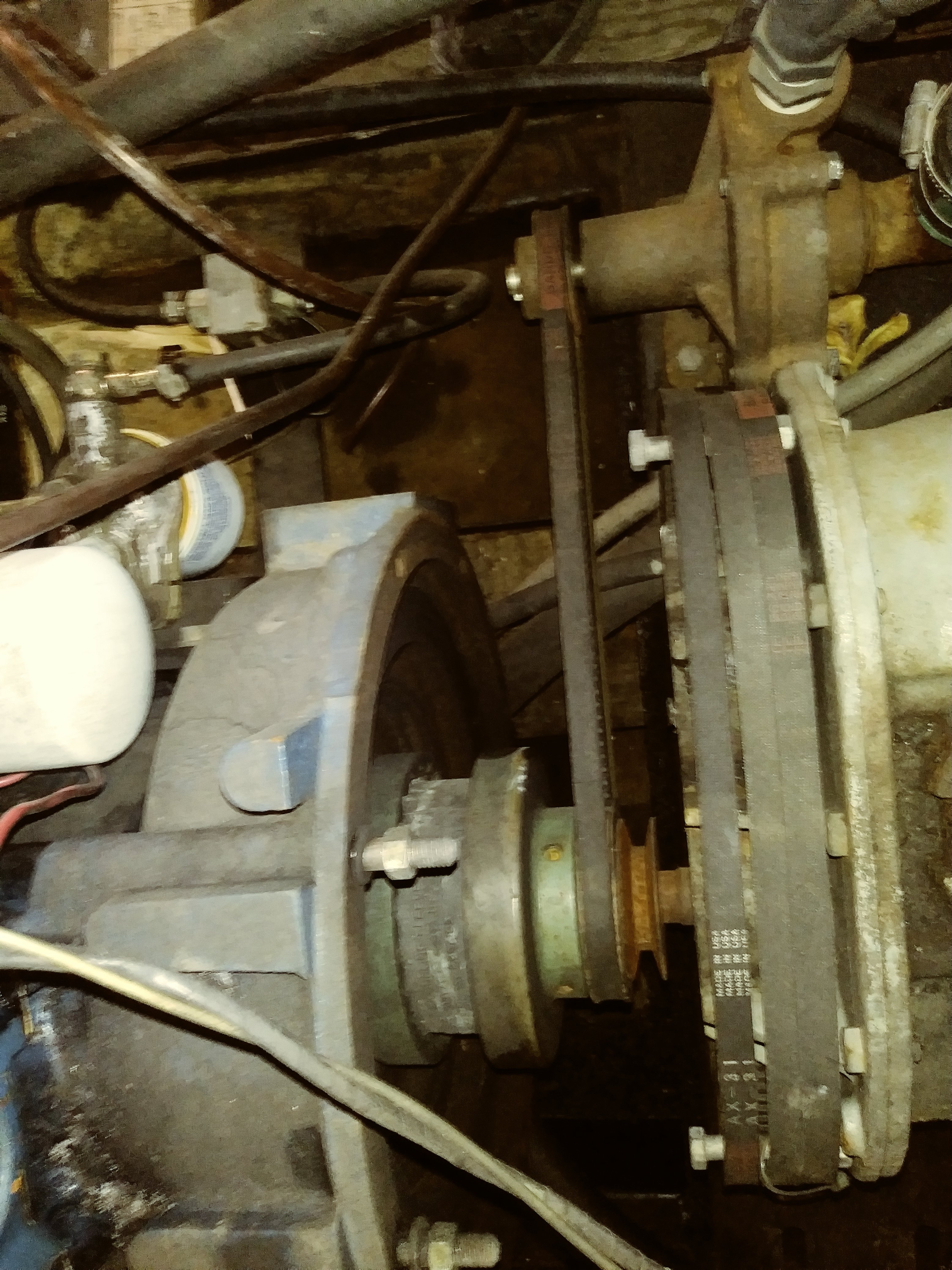

One of the units here is a coupler system
I can't say for sure why pto but I like the idea of being able to disengage and those PTOs aren't prone to breaking in my experience. If I had to guess I'd say just because it is a simple solution and they are usually available already coupled.
Yes the isuzu ihas the coupler system,the perkins has a pto,those things last,heavy duty and its the same my buddy has to operate his wood chipper,1500$ just for clutch whoa ,engine is going for 5000$ used in sail boats, isuzu engine going for 4k on ebay

@bob vawter what is that big lever out front for?

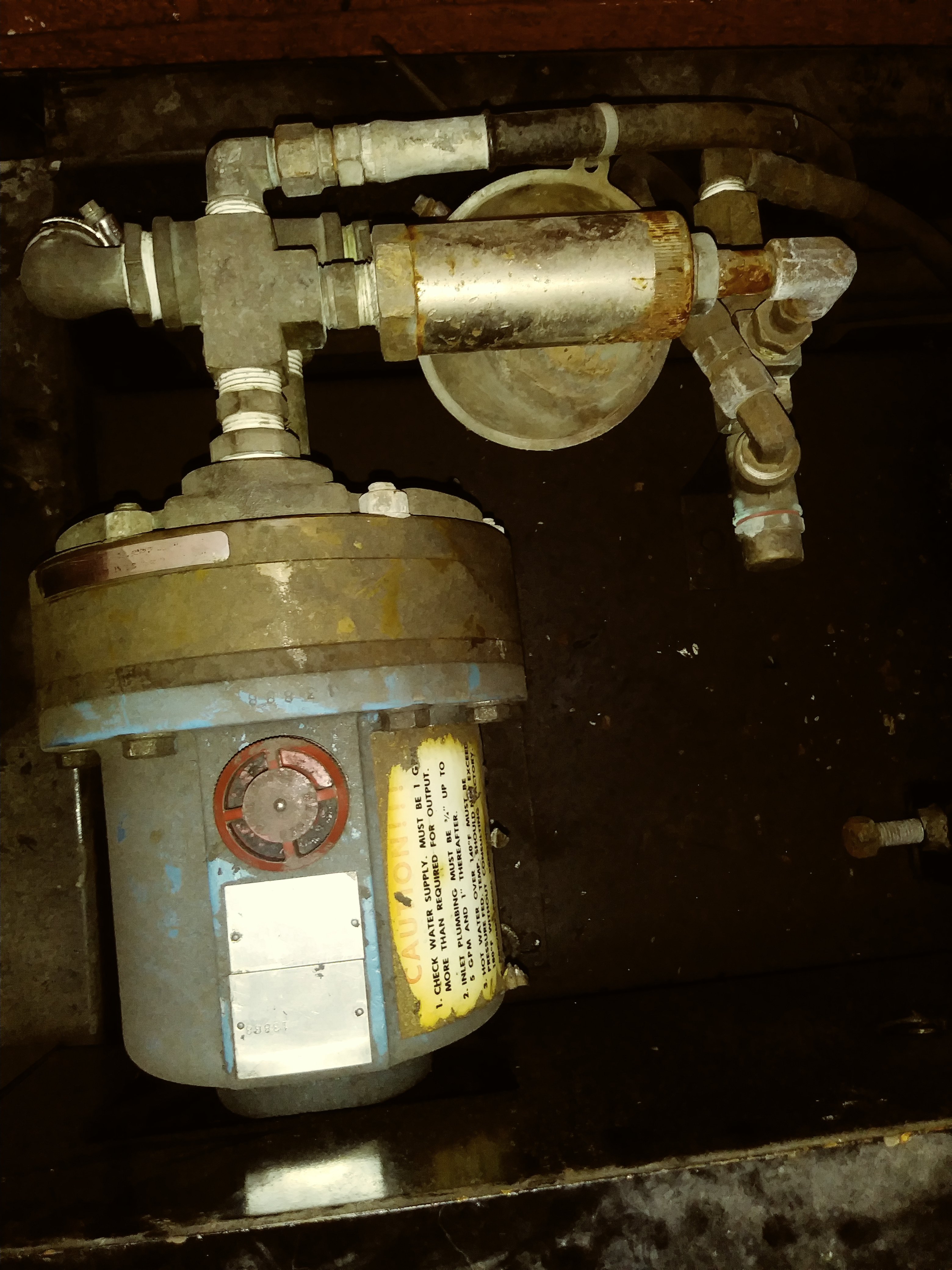

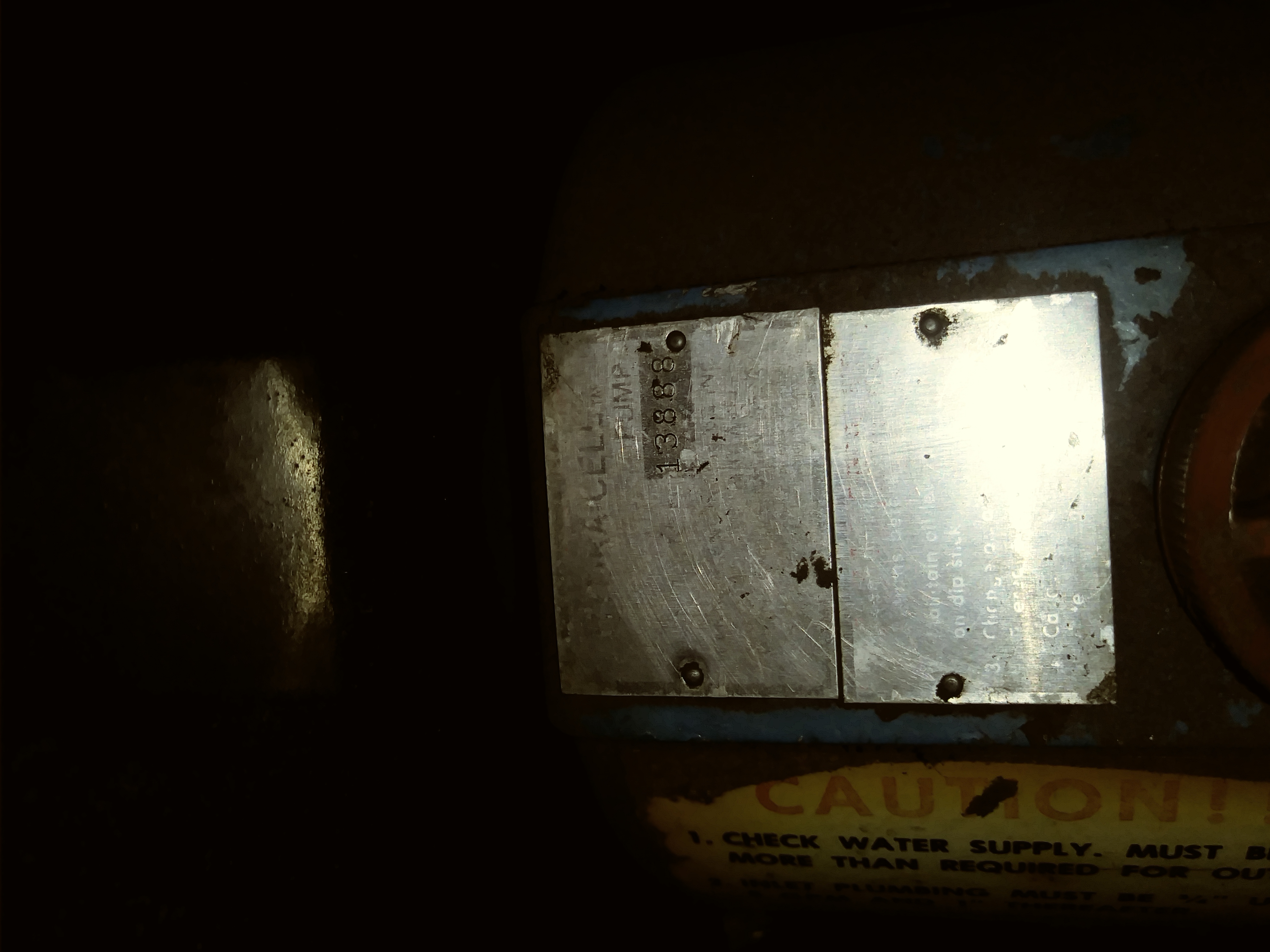

thats the clutch lever...lift up to engage the belt system...cant tell for sure but that looks lik a Hydra Cell D 12 pump capable up to 2500 psi as opposed to the smaller D 10s that i used....

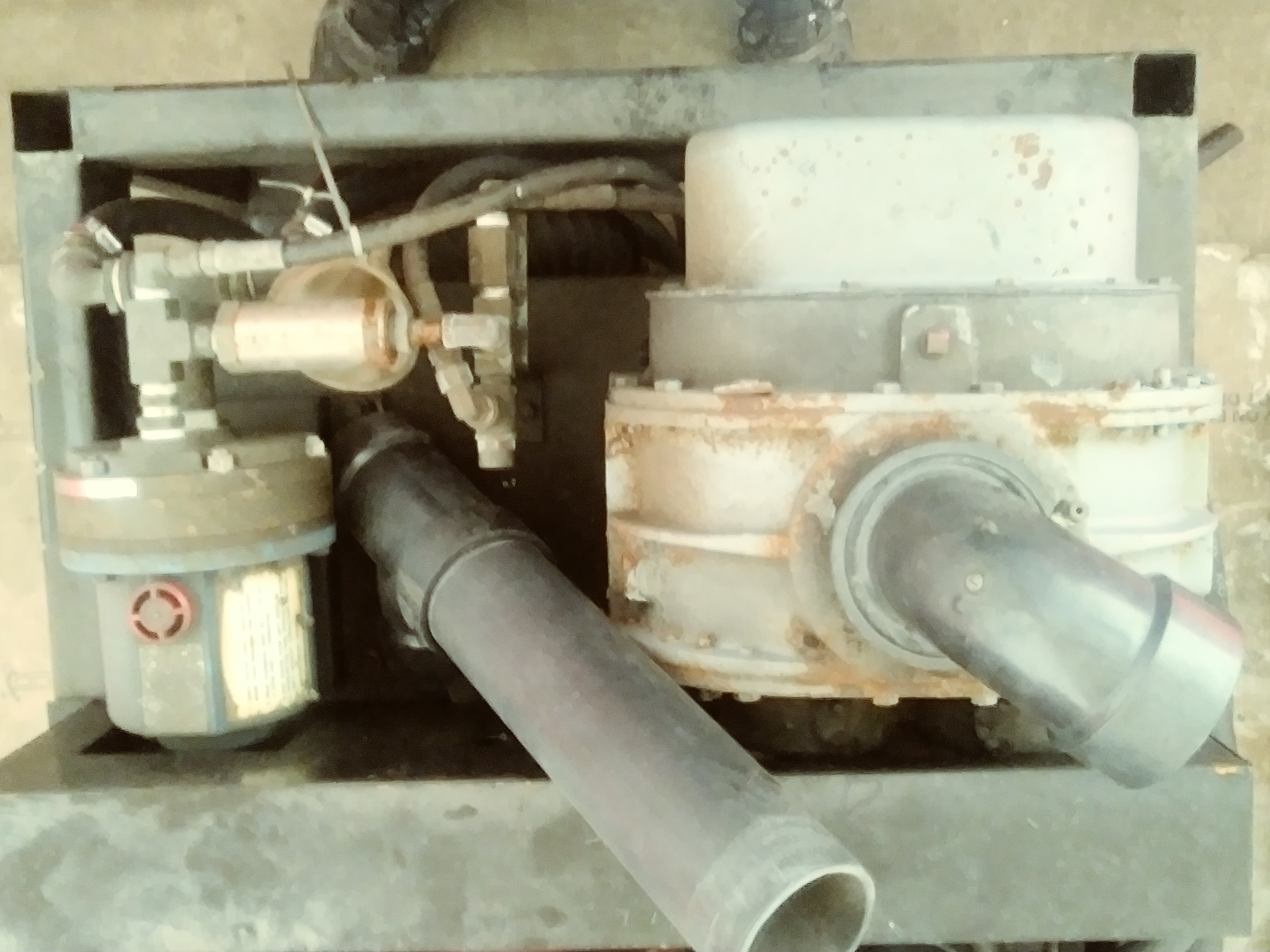

a used D 12 goes for 6 or 7 hunnert then the blower is worth maybe another 7 or 8 hunnert..the motor would require a compression test to be sure
the real question IS: what kinna waste tank? The Bates tanks were really a POS!

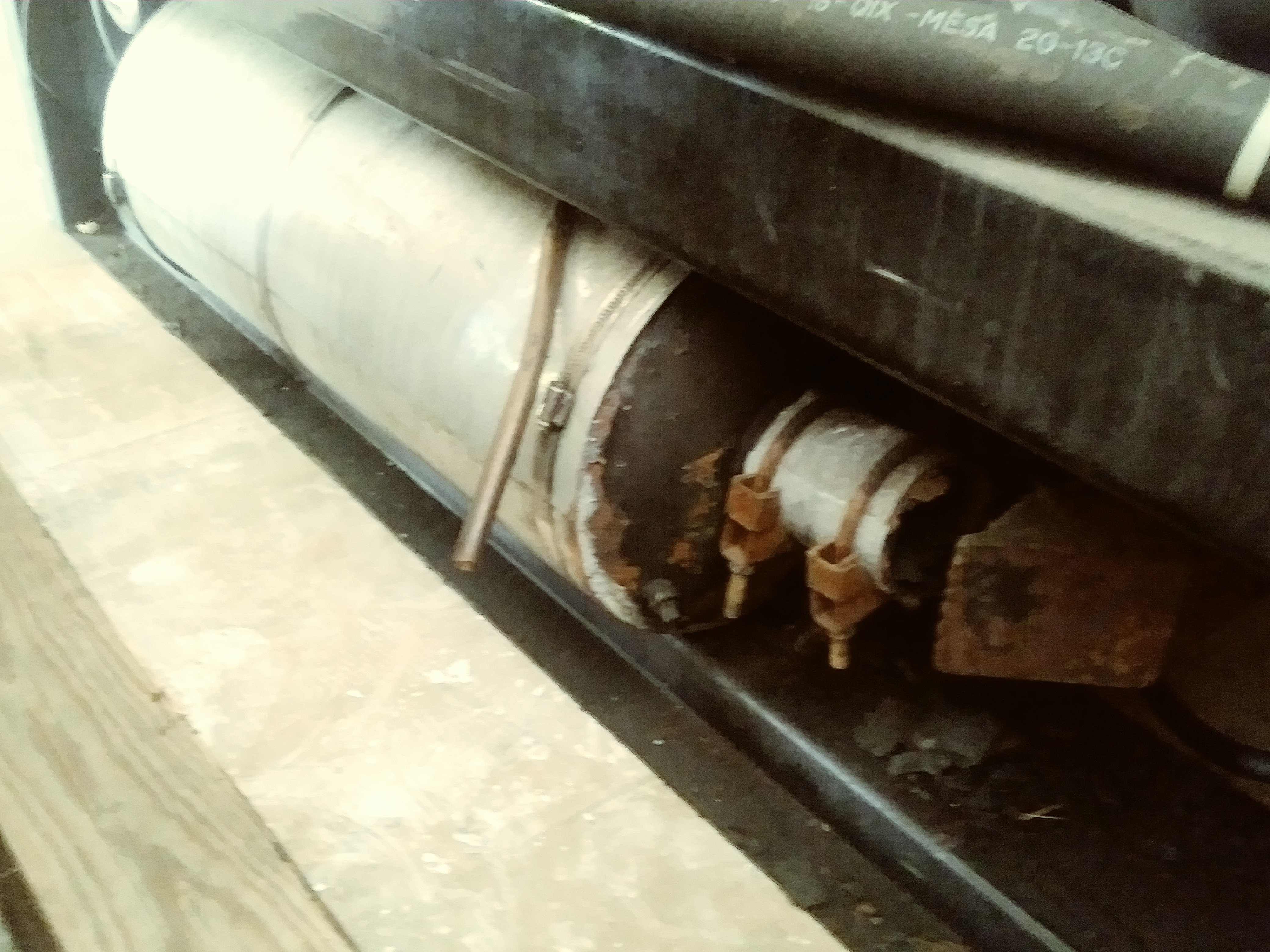

Not sure if the waste tank is attatched,there is a stainless box on the isuzu but not the perkins,there are two mufflers under it and what looks like a black ,thinking fuel but couldnt see the cap anywhere but there is ful in it,i turned it over today but couldnt get it to fire,compression is there,fuel is there but i dont think the plugs are heating up or im not turning something on correctly,hit it with starting fluid lightly but still no fire,engines turnover slowed when either entered intake,im guessing its a wire somewhere,im not a mechanic but i can figure just about anything out if i focus a little and trust me,this thing has my attention,i think im going to end up keeping it lol

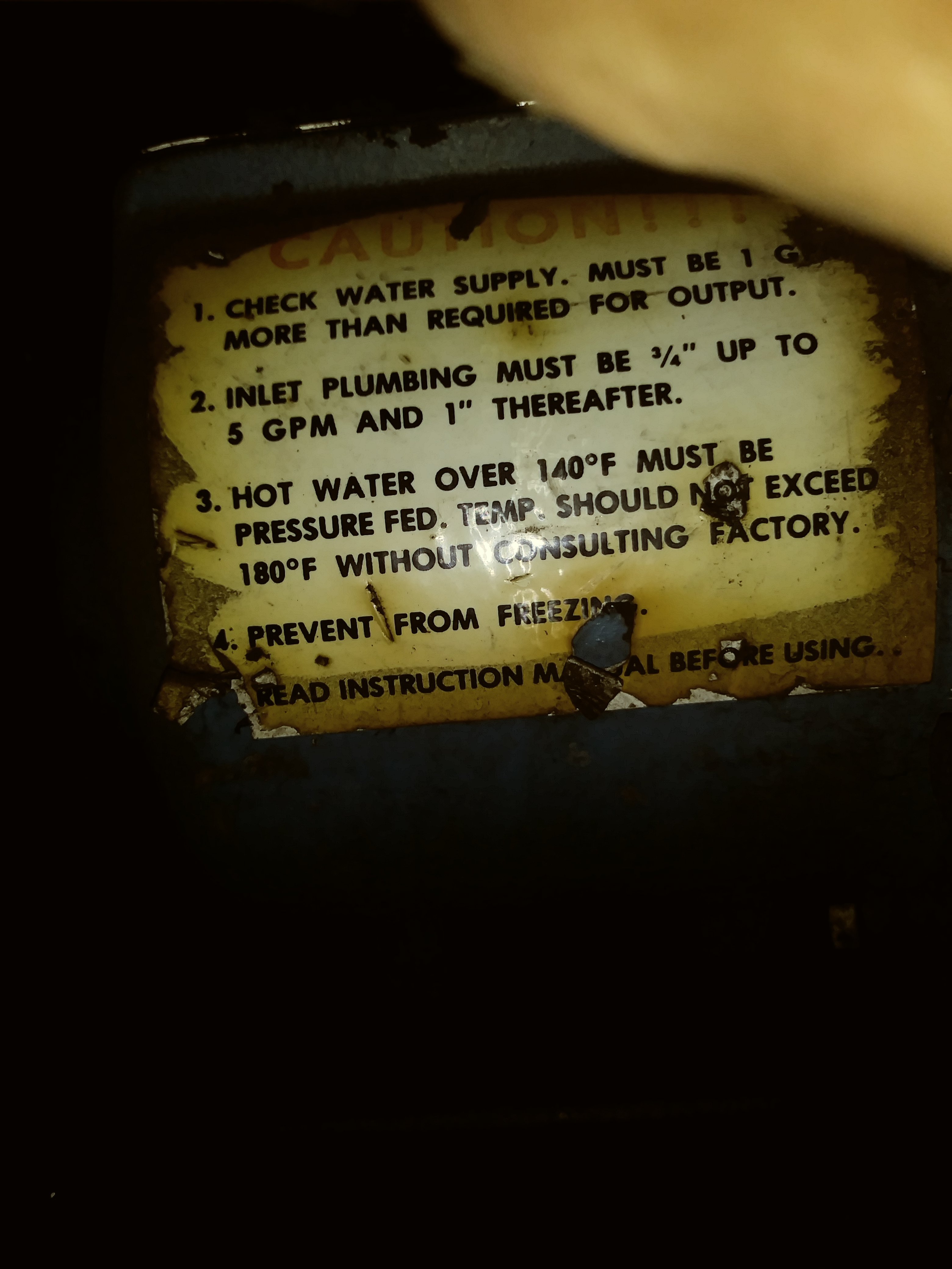

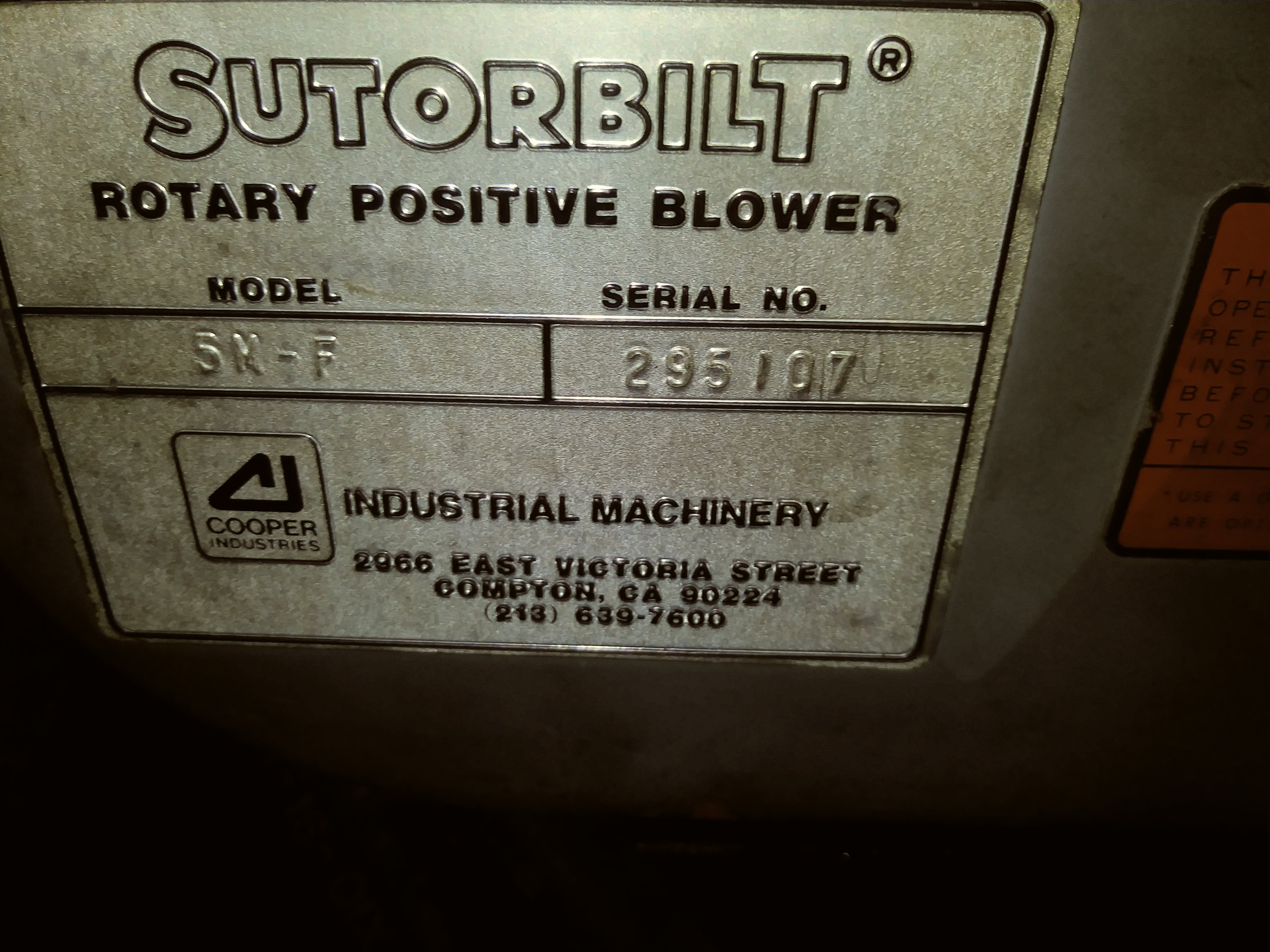

Tell you what,5 days ago i didnt know shit about any of this,gene bates spared no mercy on rugs,these machines are insanely built,im looking over the spec on these parts and they are heavy duty
S
Sikkwilly

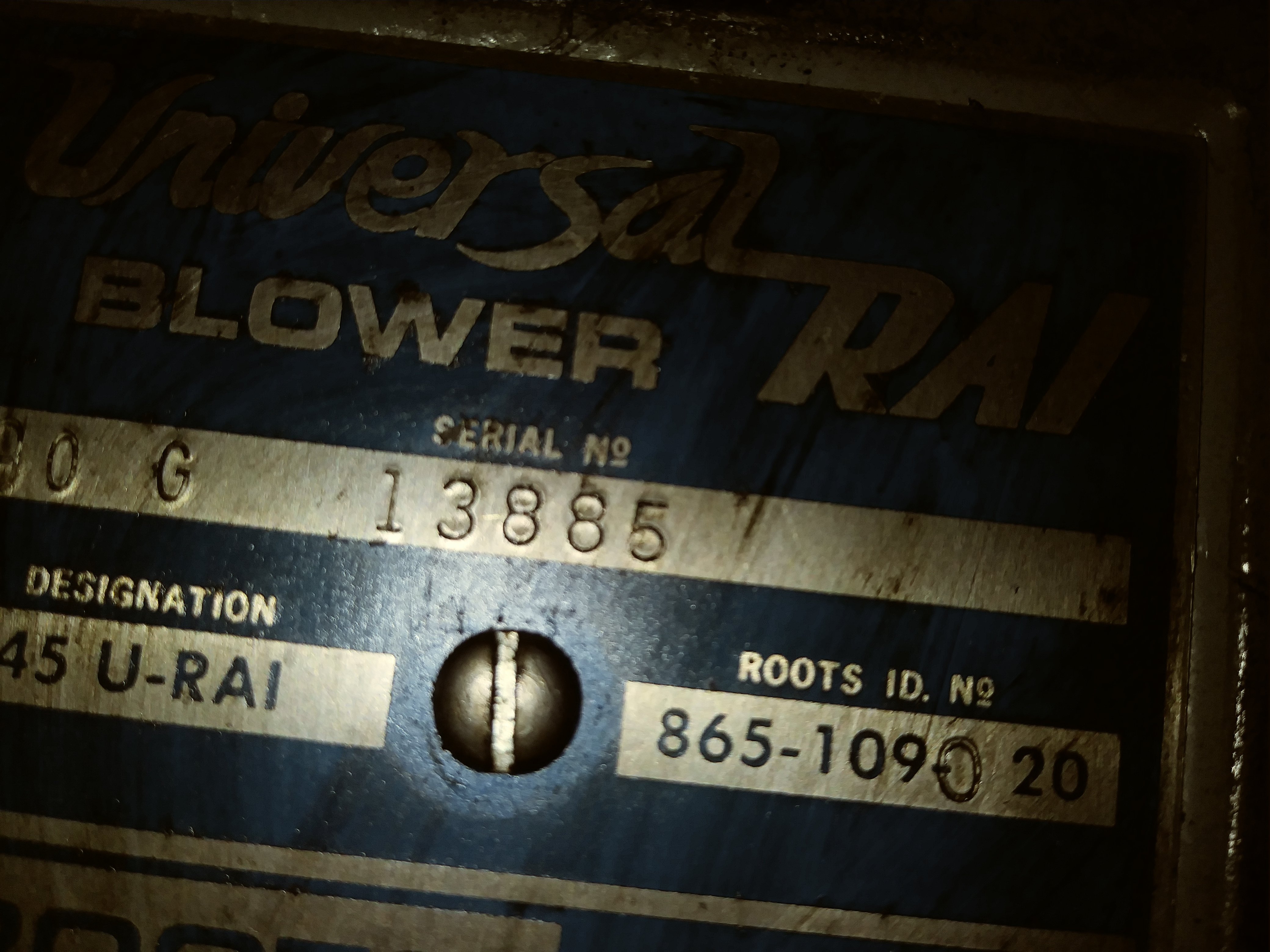

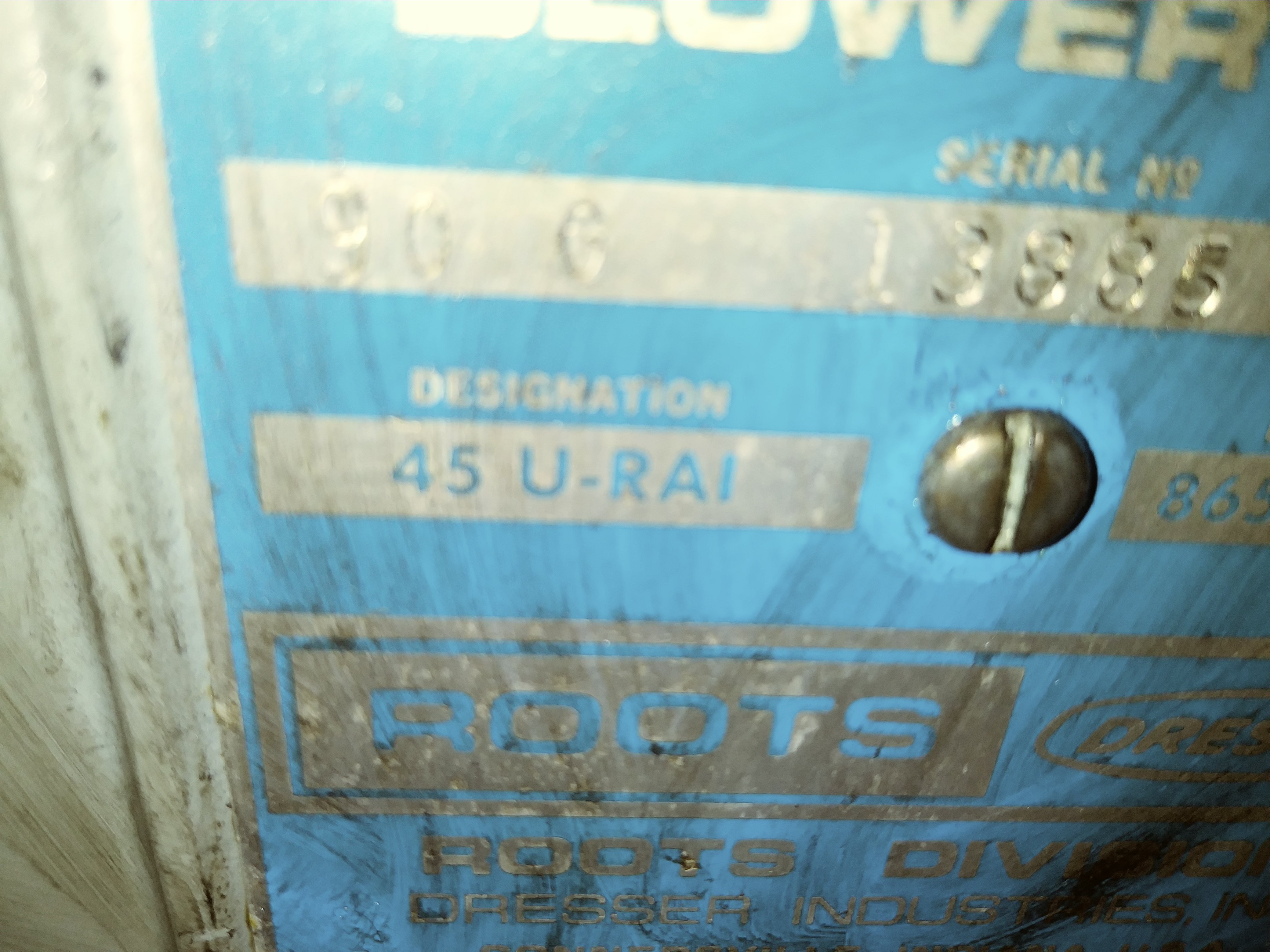

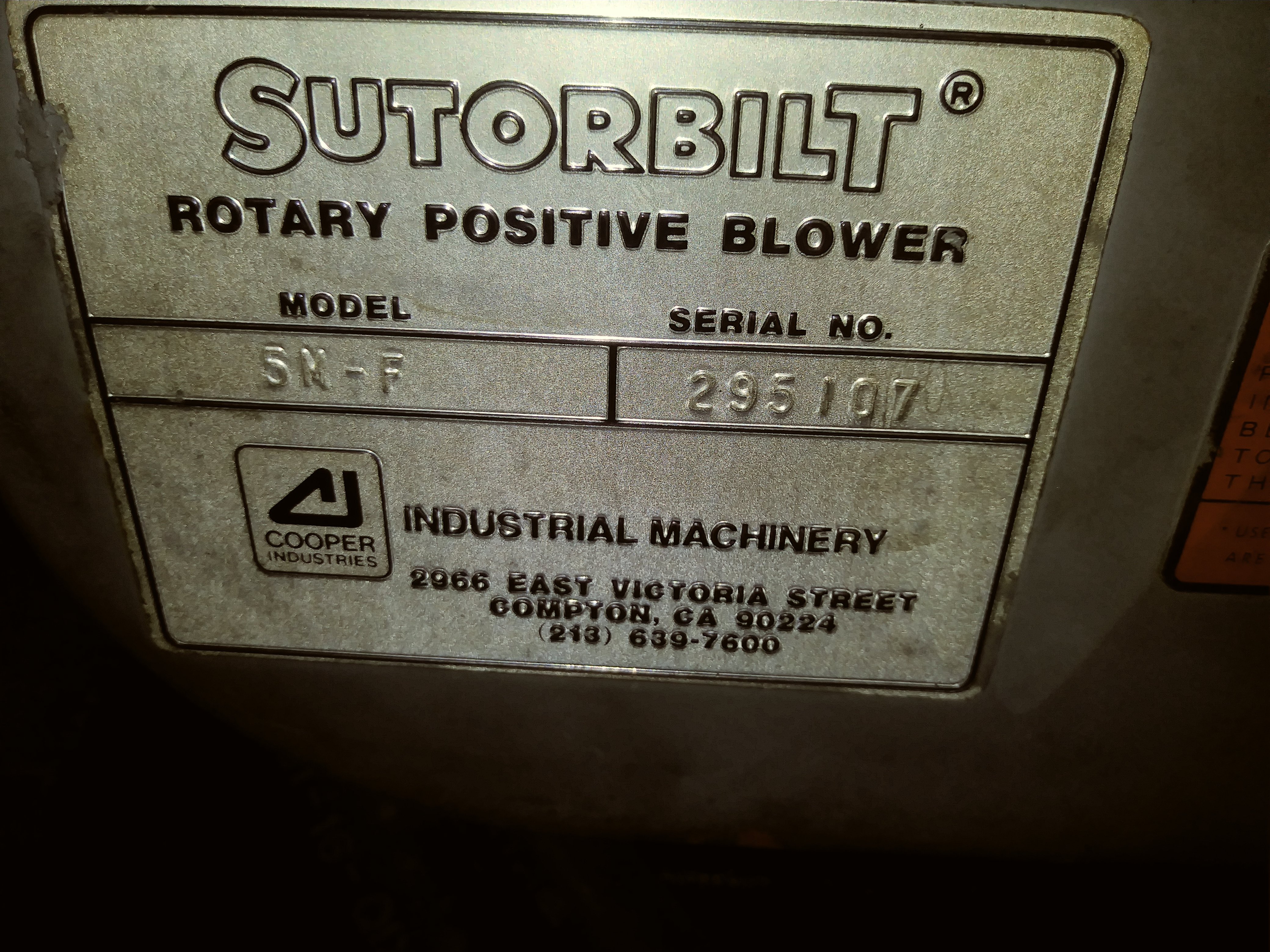

Suterbilt 5m-f positive displacement high temp blower and a hydracell pump,cant twll what size
20190927_171927_Film2.jpg 20190927_171959_Film2.jpg 20190927_171913_Film2.jpg
