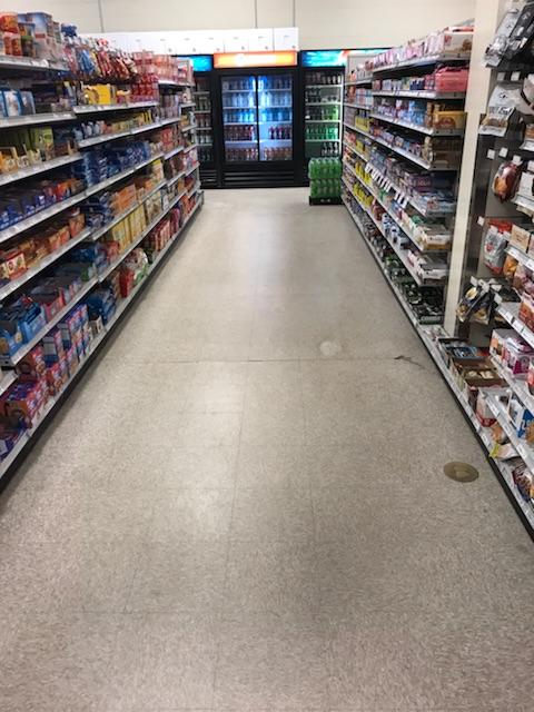

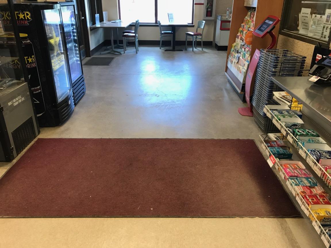

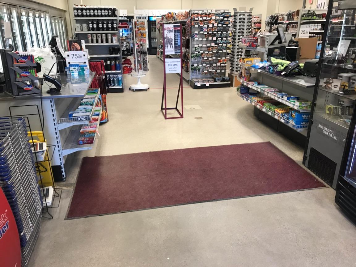

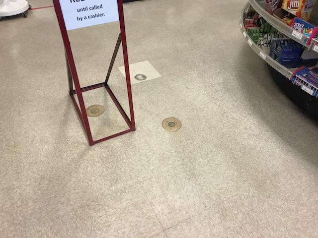

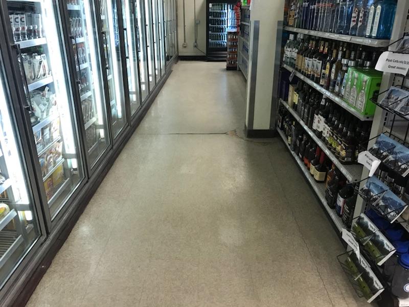

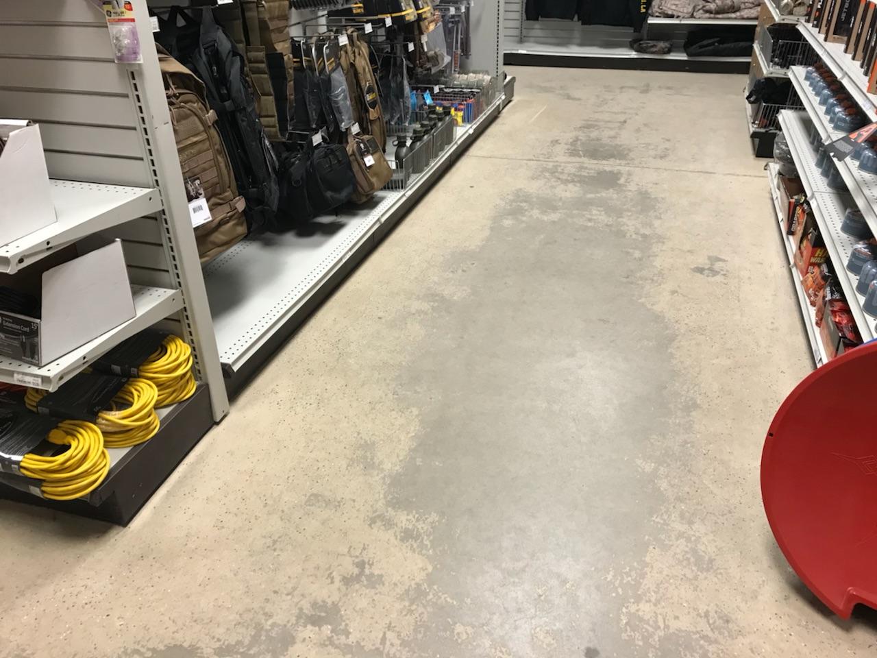

$2400 for me..
117,349
30 plus years old.
Last guy completely stripped and waxed the vct, cleaned the concrete over three days for $600...
No tanks.
10,245
And could you do that Sunday nite after we
close? What a piece of crap. Retail ranks up there with residential, if not worse.
117,349
The only want to shut down for a day..
I offered to SPP and recoat for 2400.
He think the Brass would rather spend that type of money on ripping up the vct and prepping the concrete
28,277
and they'd be right .....
for the price of a keg of Busch beer and dinner with a few fat bar tramps they could get a squad of Jarheads to rip the chit up.
.L.T.A.
The cost of the beer alone would be more than $2400.
117,349
I was very clear about my proposed method being just to buy them time.
Same thing I'm doing on the sport court at thier housing base
