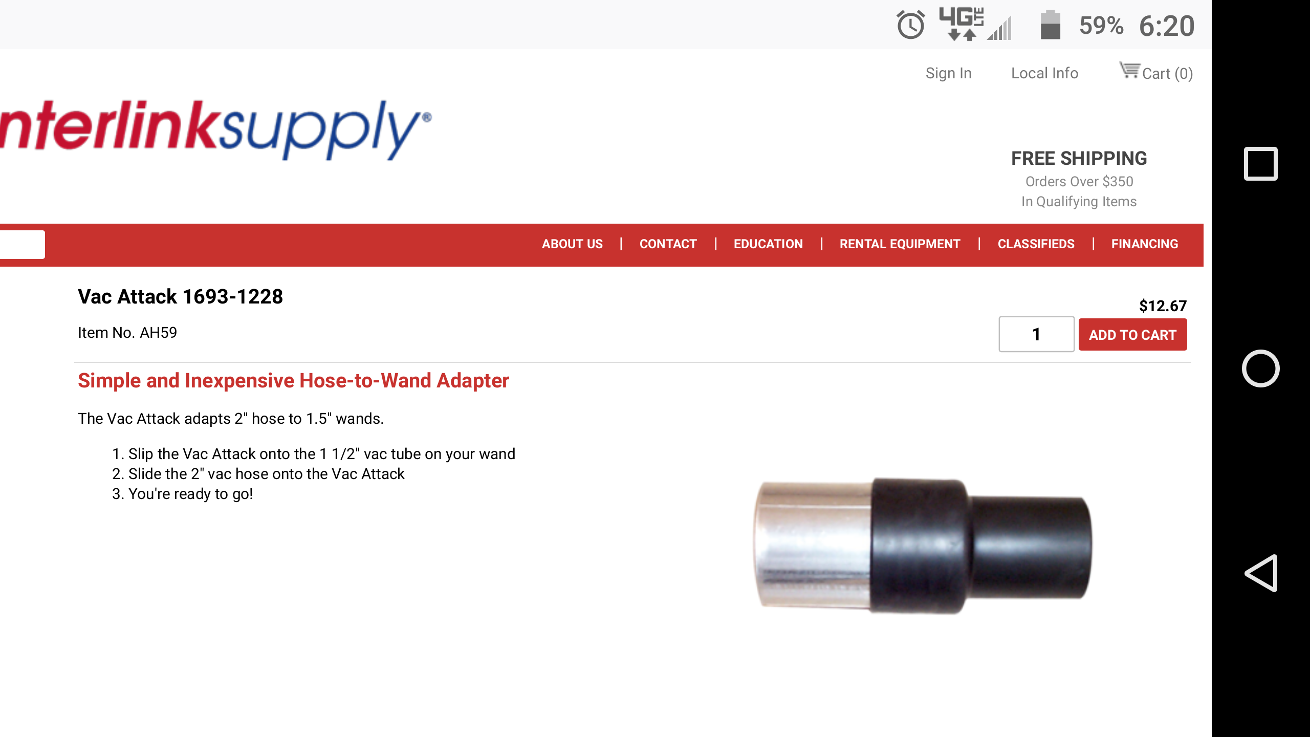

  7. the 2 inch to 1.5 inch hose. You have to go from 1.5 inch wand tube to 2 inch vac hose. The adapter hose is a great idea, but this is the biggest problem for me. I use a Prochem upholstery tool that I use to do the edging which is adaptable to a 2 inch cuff. If I got the wand I would need to figure out a way I could use the wand and switch to using the upholstery tool with little effort. At this point I could use a 2 inch to 1.5 inch cuff on the wand over an existing 2 inch cuff (which is what I did for my trial) but there is so much pressure on the cuff that it bends plus there is a vaccum loss between the cuffs. The other option is to use a 2 inch to 2 inch connector cuff to go from my vac hose to the adapter hose but then every time I edge, i would need to switch cuffs which would be very time consuming. If anyone has any suggestions on this, buying this wand would be a no brainer.

I don't have that wand yet but I often switch between 2 inch and 1.5 inch tools. I have 2 whip hoses hanging up in the truck with flash cuffs. 2 inch for the wand and other tools and 1.5 for stair and upholstery tools. I just put on the appropriate whip hose.

This might help.
