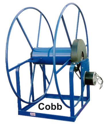

Greg;
This is the chain drive model that we've used:
You can add one or two solution reels to the left side.
