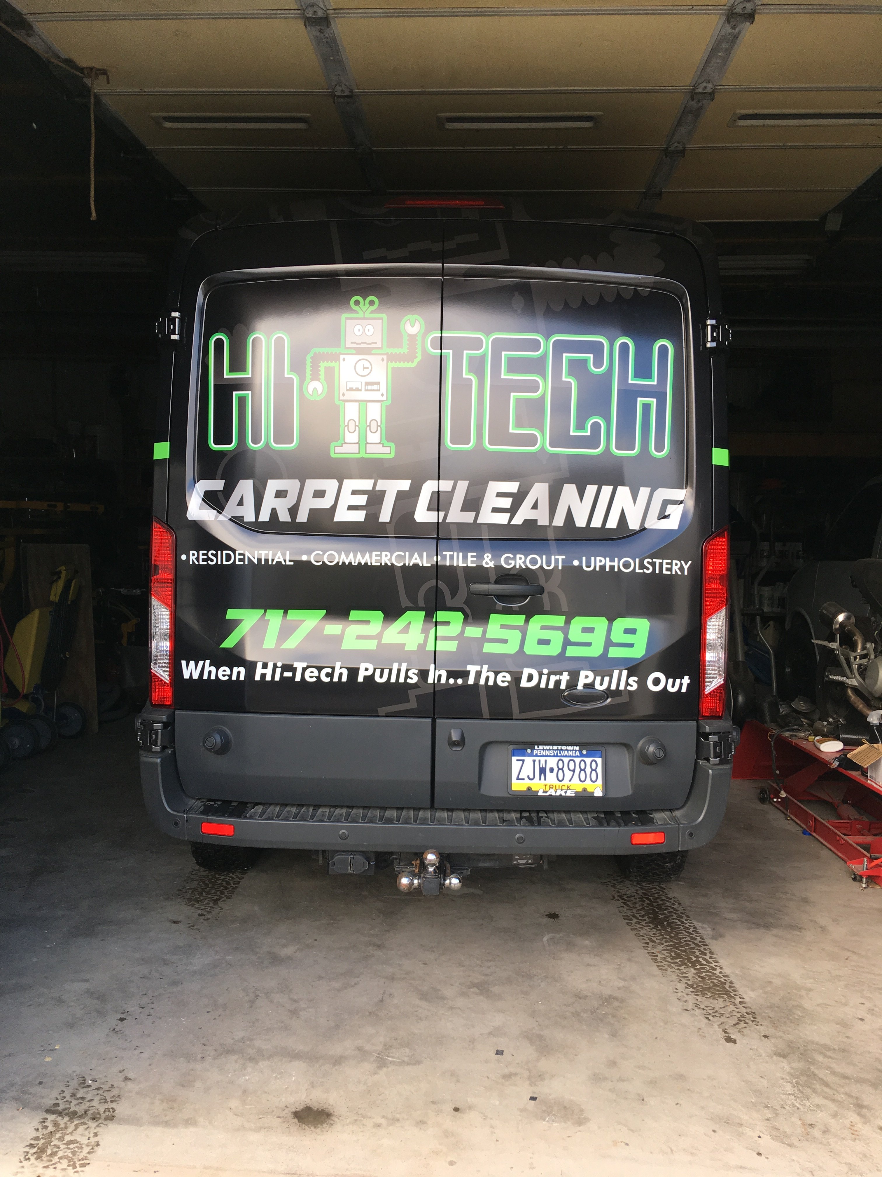

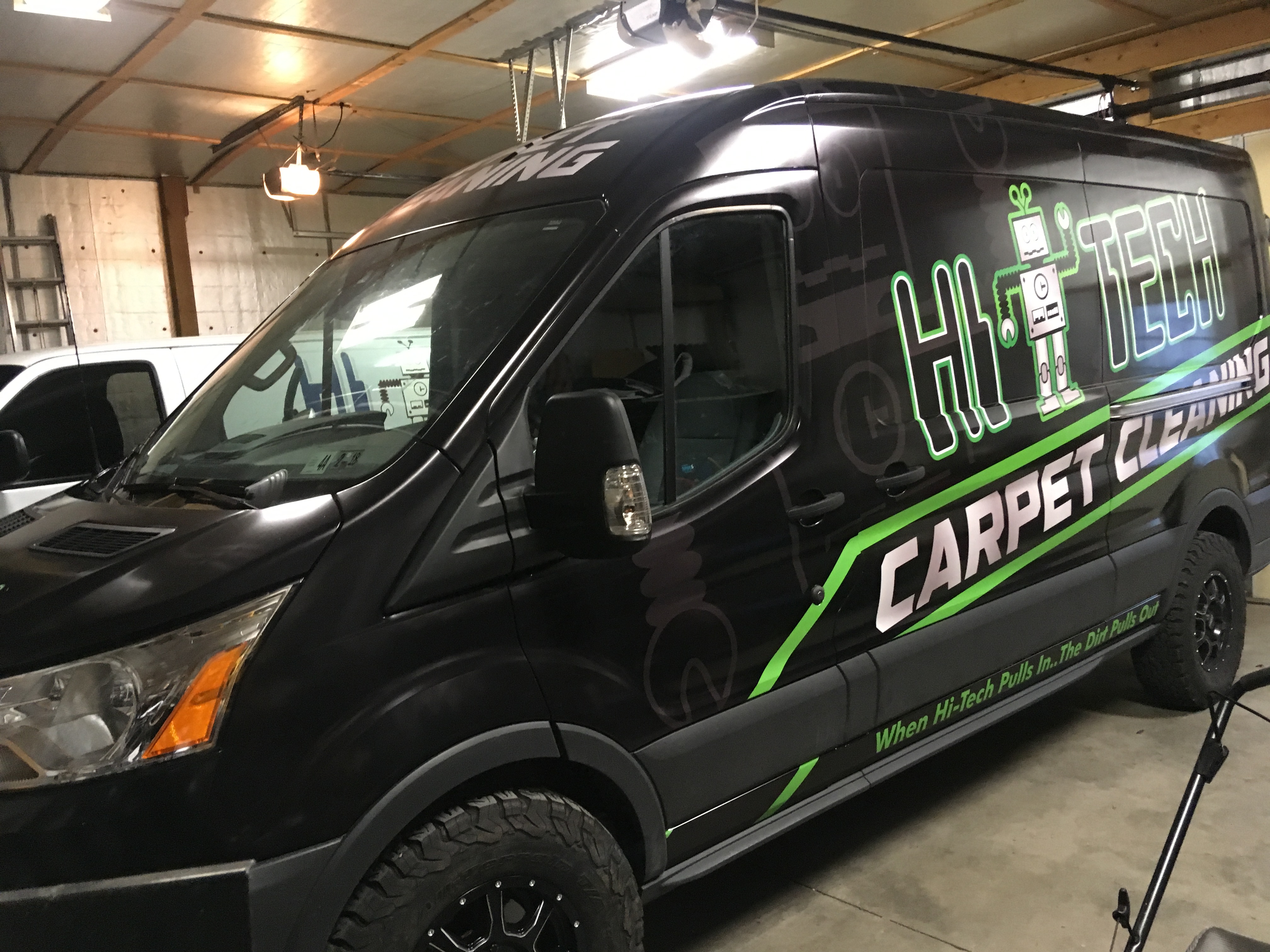

So i'm trying to decide between a wrap, partial wrap, or lettering. For you guys that have had your van wrapped did you have the design already done or did they design it as well. The one company I talked to about it can do it all but I'm skeptical paying by the hour for design work if I dont like it at all. Thoughts?
A planet far far away
https://99designs.com/car-truck-van-wrap-design
If you don't already with with a designer, 99 designs is one way to go. The put it up for bid, you tell what you want and anyone that wants to partake in the contest submits designs.
You get many designs, almost too many from different designers. You have a set amount but at least you know it won't exceed that. Its a cool process, we've used it several times over the years.

Sneak Peek... Its slowly getting there
May 12, 2007
2,519
Bay City, MI
Bruce
The more I see these custom looking 4x4 wheels the more I'm liking them.
Nice looking van, nice looking wrap, but like Mike said , Phone number? www?
steve_64
Aug 11, 2012
13,372
That is messed up, I forgot about that.

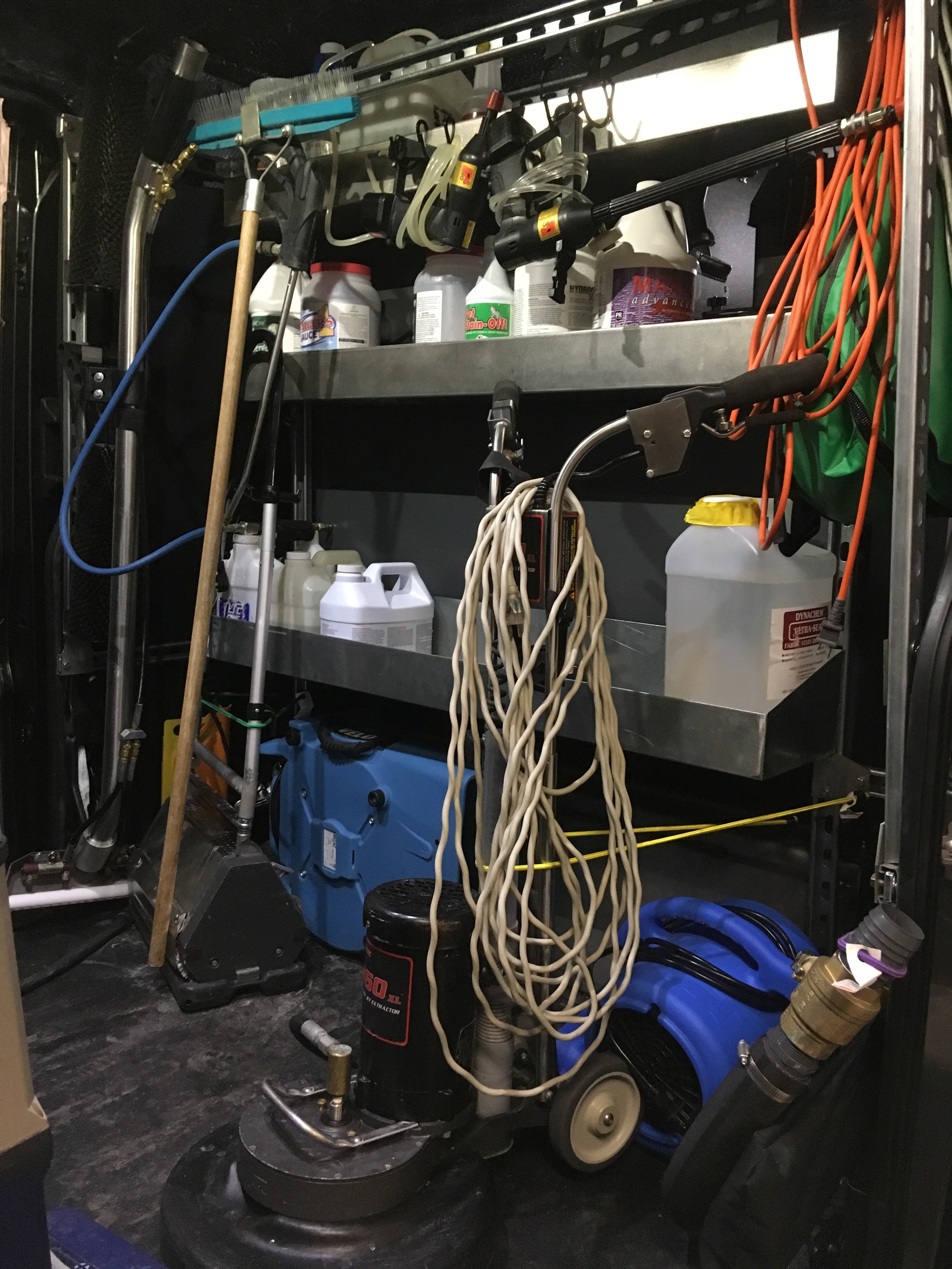

I really like the looks of everything. Are you going to build in storage in back for tools and products or just do shelving?
I'm tired of everything being in the floor and am wanting to do a custom storage bin/ shelf out of wood. Just looking for ideas.

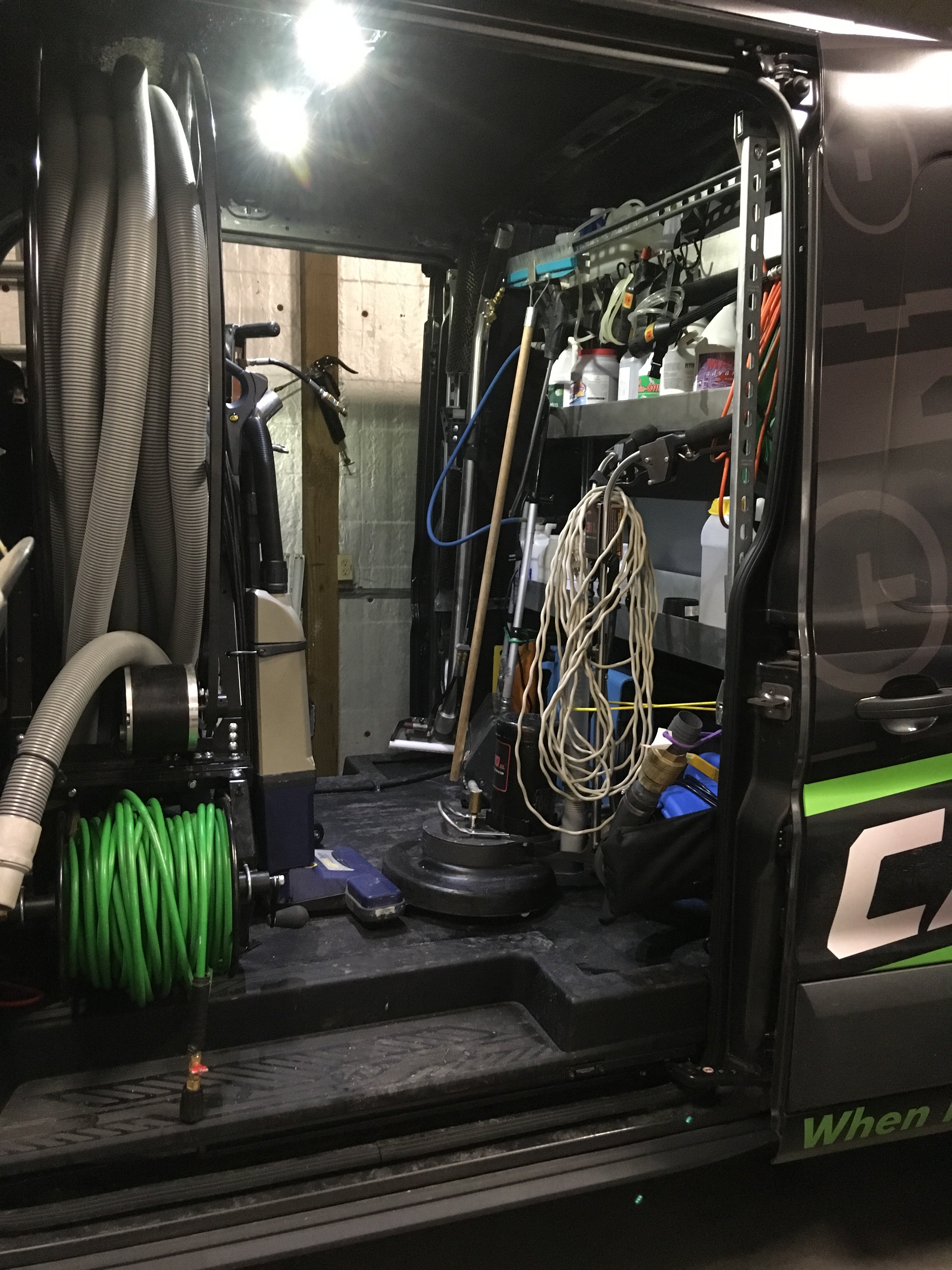

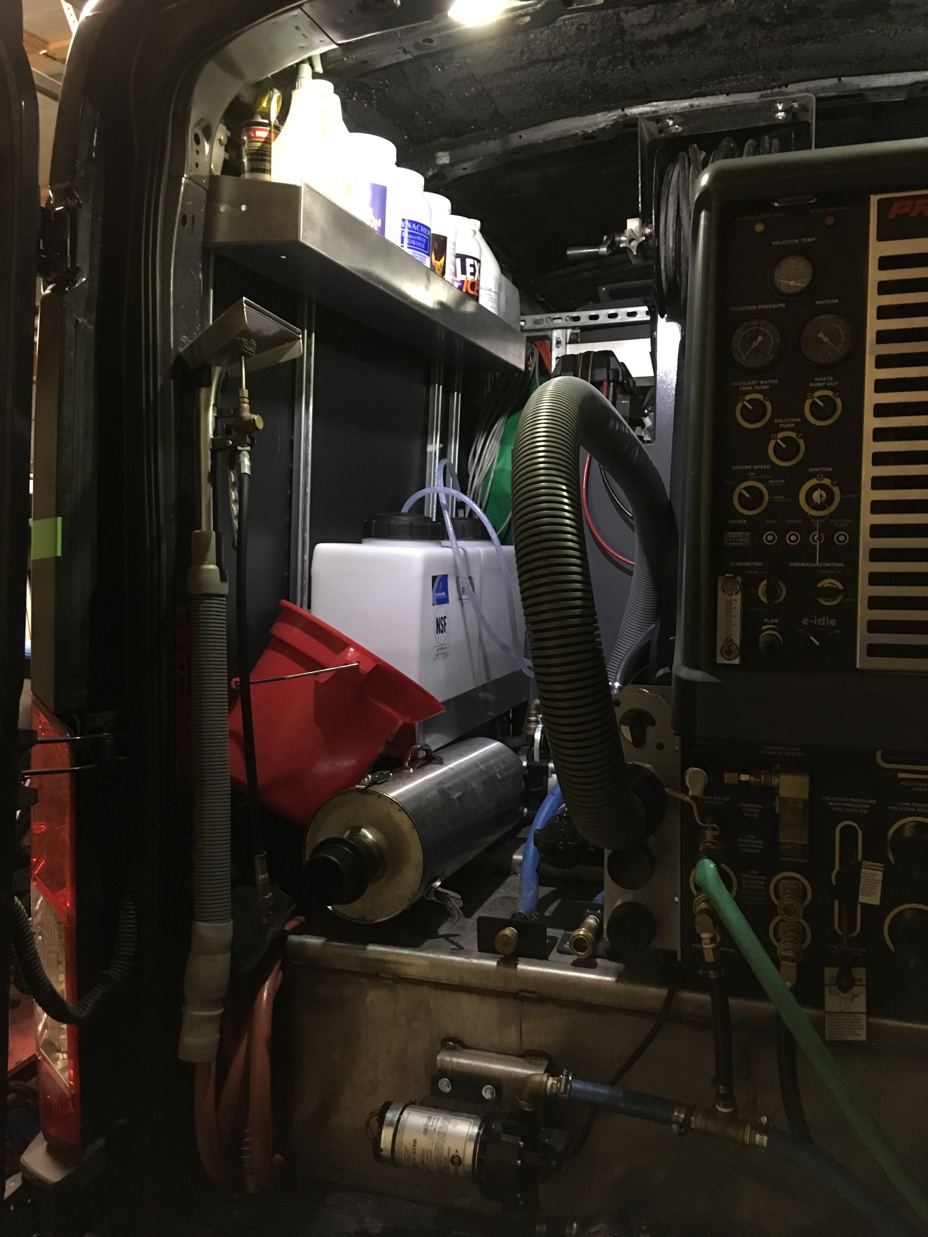

I've not seen it in a rear install. It will be nice to slide the doors open to keep that heat off the unit & you.
Any weight handling issues? Fish tails??
I havent driven it enough to find out yet but I definitely think I'm gonna put airbags under it. With a full water tank it sags about an inch or 2 in the rear.
Reactions: Desk Jockey
Rear install is what we ran in ext'd Fords
Pro outweighed the cons for me
Pros;
NO hot 'n stinky TM 8 inches behind your head on the way to next jobs
Side door hose set up/tear down is quicker/easier
Easier load/unload gear
Easier/more convenient to point TM exhaust away from home entrance
I believe the TM gets better cooling airflow too
cons;
You loose some floor space (the biggie)
You need Airlift air bladders to eliminate buttsag
driving/handling*
I noticed and had no problems with handling
No unusual or accelerated wear on tires **
No axle/rear end/suspension problems***
Notes;
* handling....all my vans have been/are the Ole School ext'd Fords.
I have no experience with the new Eurofag vans ...no clue if they're pussy trucks or stable like real body on solid frame trucks
**Tires
Max/heaviest rating 10 ply are needed
Because tires are the weak link weight hindrance in the set up (not suspension/frame/drive train)
*** suspension Air bladders
Even the most robust 1 tons will get sagazz eventually
I installed Airlift 5000 LBS bladders (2500 ea bag rating) from Summit Racing
20 to 90 PSI , never needed more than 60 psi
Smoother/more comfortable ride than adding steel leaf helper and just as stable
final benefit of rear set-up
Generally easier for a BD, in a home garage (or small shop without forklift) to pull TM if/when major or PITA to get to repairs are needed
With a come-a-long or chain hoist, and table built to height, you can drag it out onto the table partially or whole
solid I-bolt on van floor allows come-a-long to drag it back in
Spud bar for final bolt hole shifting/line up
(tip..bolt down angle iron rails to slide in for perfect drag in position every time)
also will slide in and out easier .....
I'll note, Powermatics are easy as hell, as only four easy to get to bolts were needed
Don't know where/how other TMs get bolted down
