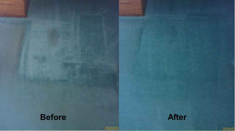

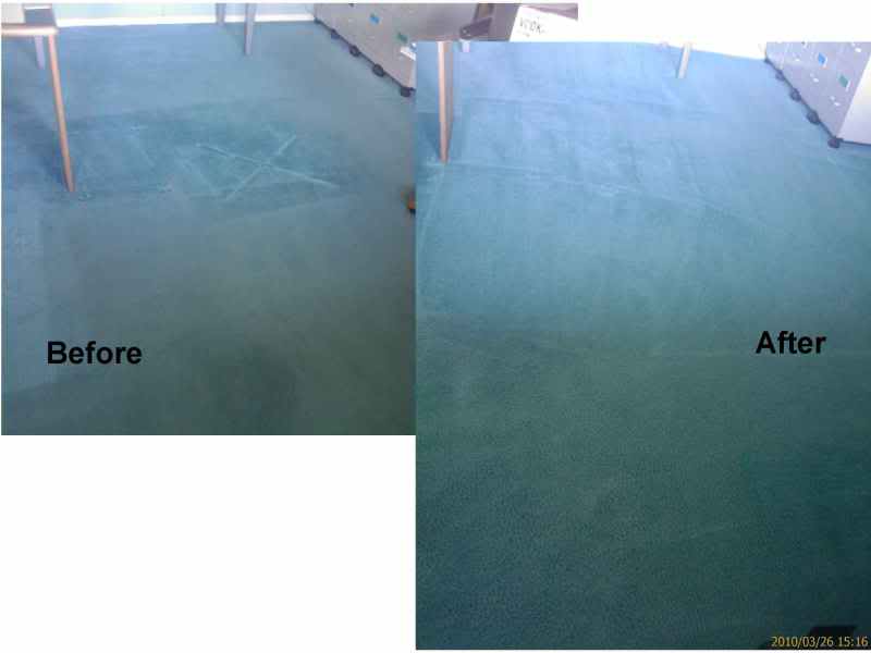

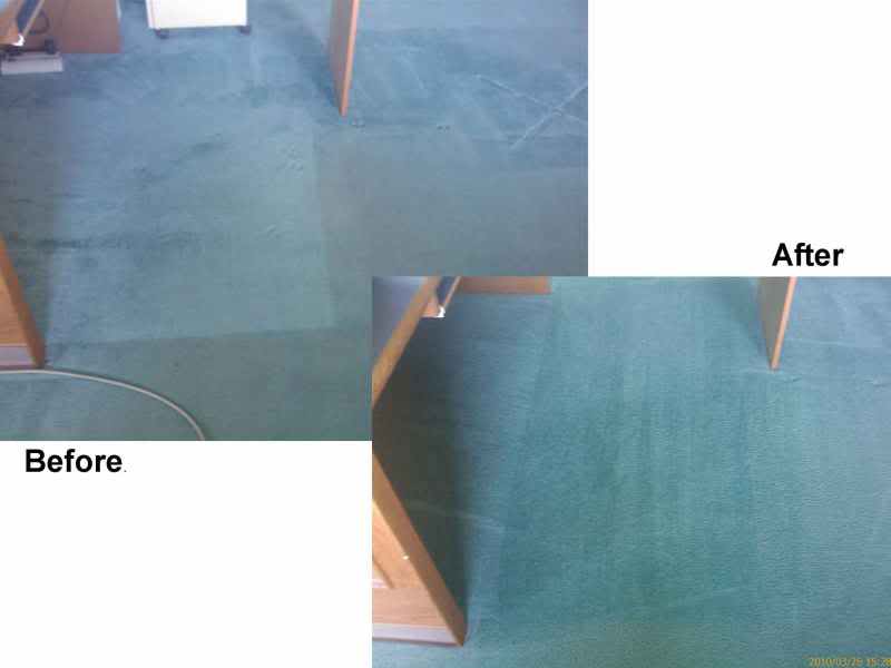

looks like a traffic pattern that probably isnt going to come out anyway...
the fibers are worn..
period plain and simple.....you can "clean" it, but it still "shadows" differently...

Its been 8YEARS this is its first cleaning. normal nylon carpet.
O2 with Hotsauce, scrubbed in and long dwell
I'm sure you would have done better. sorry to disappoint.

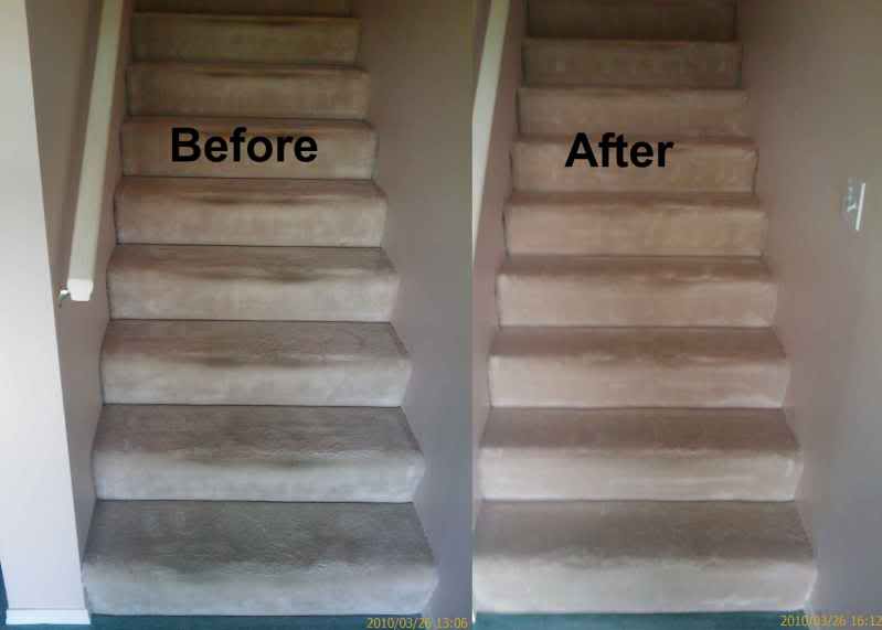

Been using it for a month or two now. Not as easy to use as the Sebo but does an excellent job of scrubbing up the carpet. it weighs about 40-50 lbs. I carry it in with one arm, have my HF in the other. I even use it to scrub stairs much the same as I used the Sebo.

other than the song it really sucks.
The pics don't show nearly enough difference to impress a would be client.
before and afters should be black and white or not at all.
Sorry Ron.
try again and groom the damn carpet.

It looks good to me, especially for being 8 years old. You won't get the shading and wear difference out 100% with a cleaning, IDGAS who says what, what chems you use, how much heat, pressure, or flow you have, etc. Like Doug said, the fibers are worn, and certainly the areas that were covered up will look differently (darker versus lighter). Some of you guys make it sound like carpet is not a wear item. If that were the case, the mills would have shut down a long time ago.

Damnit. I DID groom the carpets. Good grief.
This isn't enough diff for you???

Use lighter colored carpets for your before and afters.

No need to be that way. I never knocked your cleaning ability. Choose a dirty job with lighter color carpets so you can show the WOW factor that I know you give. It would stand out more is all.

Guess the pics don't do it justice.
Day and Night when I was there, esp by the desks.

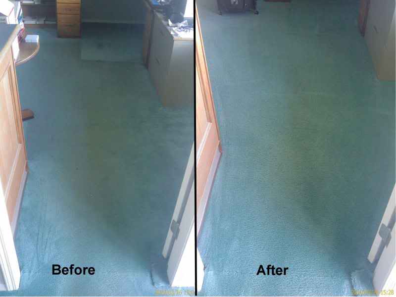

Ron, the first before and after.. is that actual yellowing or it is the angle of the camera, reflection of the furniture. everything looks great to me but the yellowing is the only problem I see.

good god thats a horrible job man.. kidding man I can tell you this much.. the yellowing is from the flash reflecting off the cabinets and this is every job I seem to always get. never been cleaned for 5 years I tell the custy tough shit have it cleaned often lets make an appointment. for 3 months? But most of the time it lightens up when it dries anyways.
