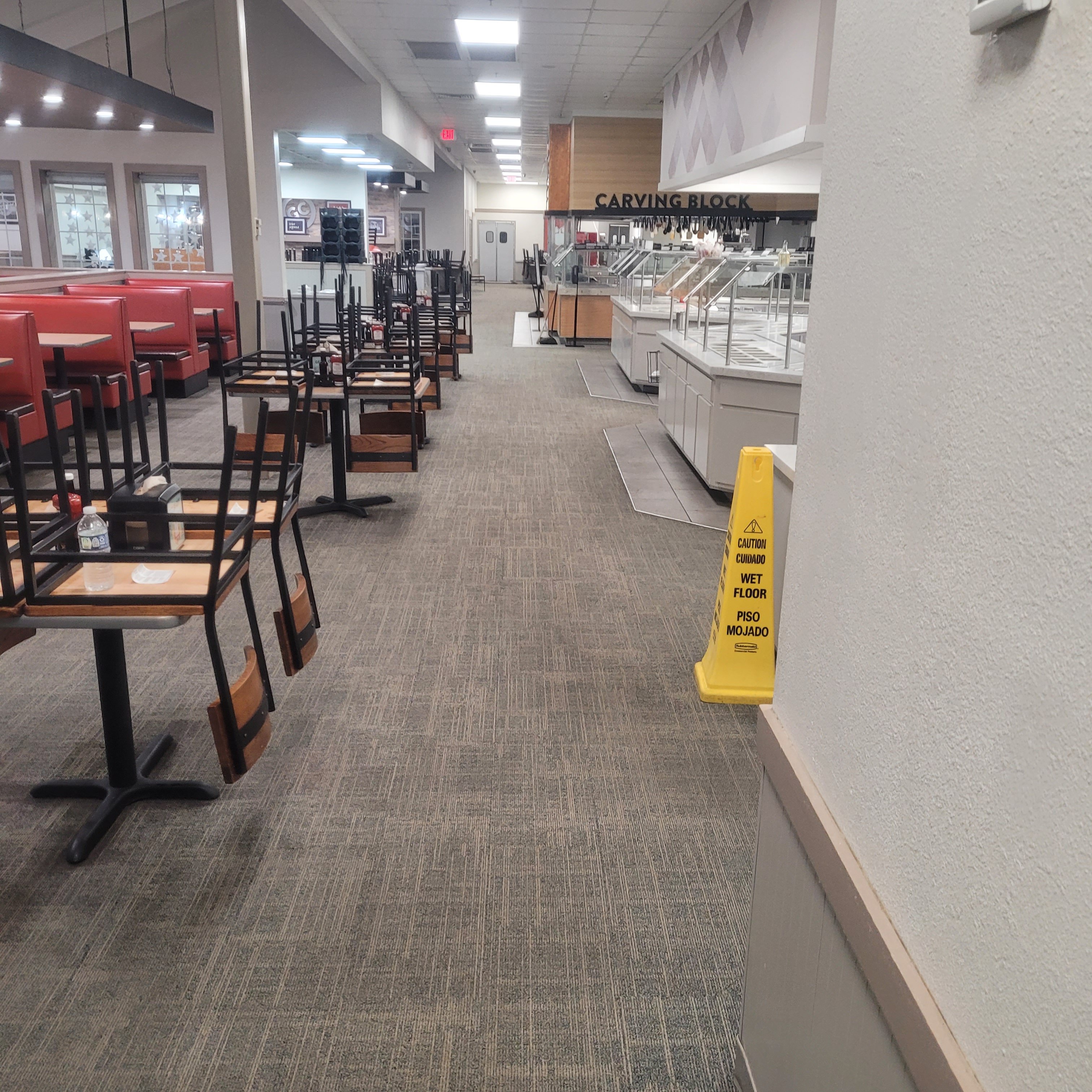

We're not proud of jobs like this, but #10 flow made it happen faster with less effort. I want to encourage you to stay away from jobs like this. If you're going to experiment, get yourself a 25-foot section of 3/8" pressure line and witness the power of rinse with less Psi.

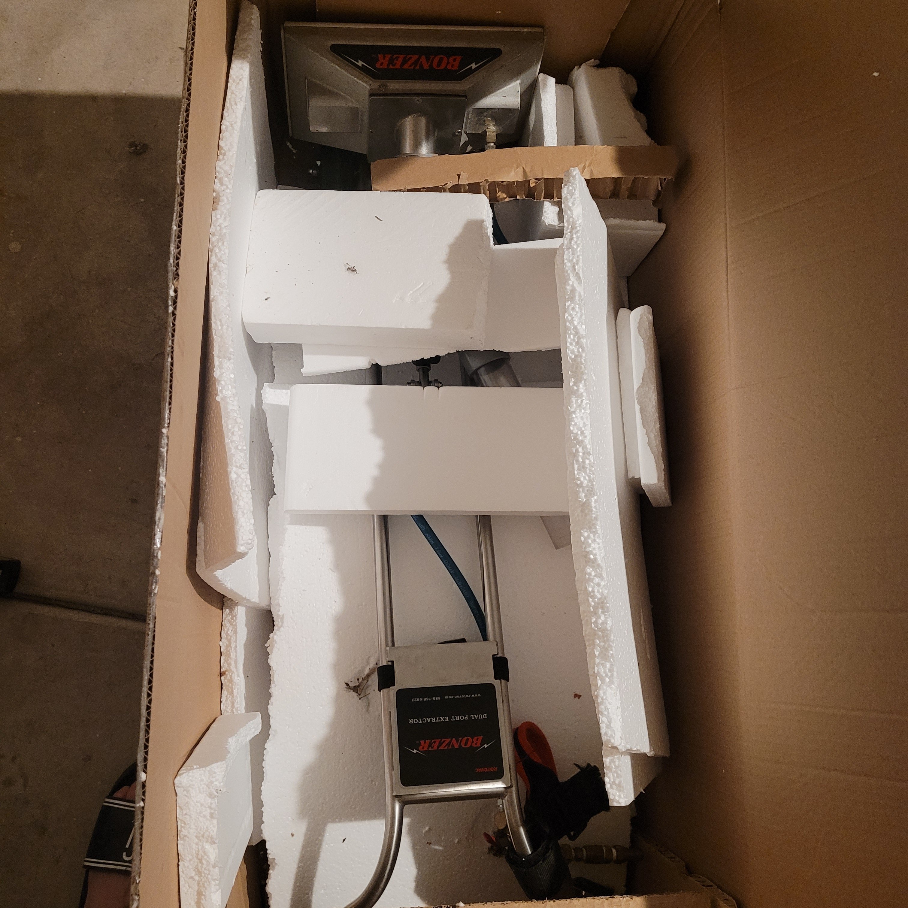

Here's a packed up Bonzer ready to ship to Canada or worldwide .
