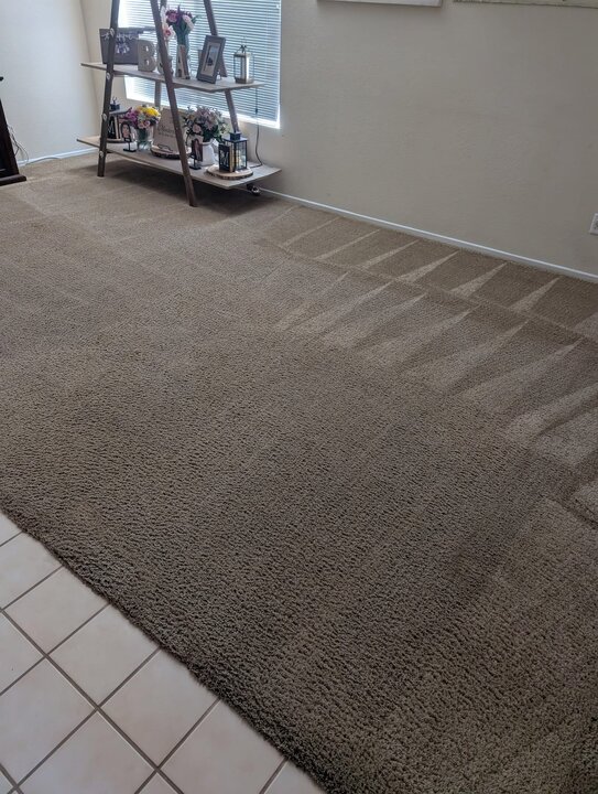

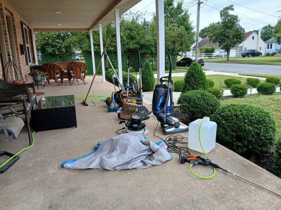

I had some time today so I decided to document my VLM process for the GROUP THINK
Yes I know nobody cares

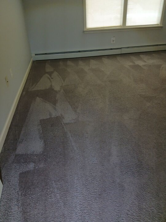

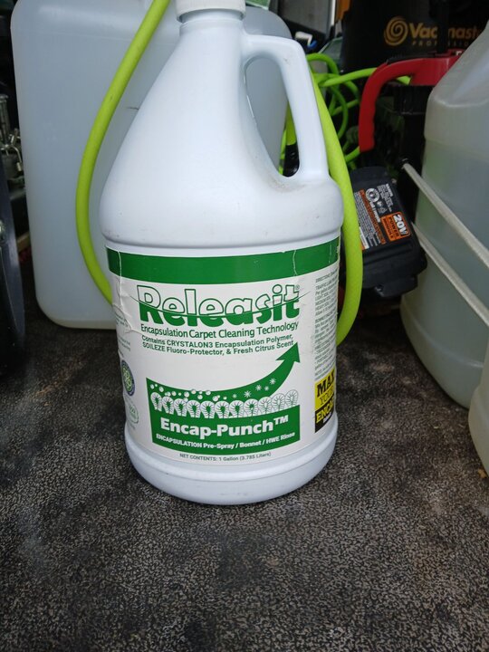

I decided to try Excellent Supply Releasit Encap-Punch for the first time on Residential Carpet. This is a long time customer with a Painting Business and 10 rentals. The results were fantastic. No customers around so I can take my time and experiment. Punch did a beautiful job with low odor. I expected a stronger odor for Punch but was very surprised. It just has a light clean fragrance
I used 4 gallons to clean 2 Bedrooms Living Room Hall Steps. Hall and steps were still damp when I left. Rooms were probably 95% dry

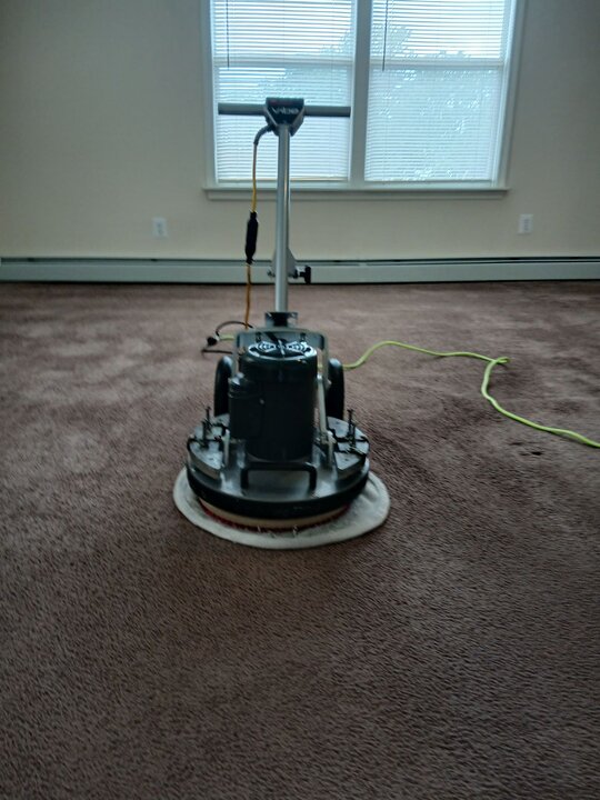

Using 2 weights on each side and with Malish Driver instead of the velcro Driver makes Vibe much more aggressive and a cleaning MONSTER. No weights and a velcro Driver makes Vibe a WIMP
Just Wondering ??? Are you really vacuuming if your not using a Kirby. No other vacuum compares
Kirby is a REAL Vacuum !!! Kirby is a Man's Vacuum !!!

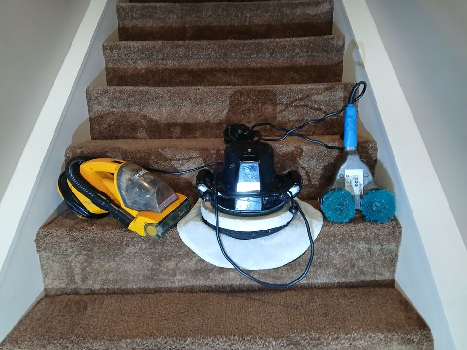

Steps
1 - Vacuum - Eureka Hand Held
2 - Encap - WORX Sprayer with 8002 teejet 8 oz Punch per gallon
3 - Scrub - Cyclo with Green Brushes
4 - Extract - Stepson with 14'' Challenger Bonnets
5 - Groom - Carpet Brush
Rooms/Hall
1 - Vacuum - Kirby Avalir
2 - Encap - WORX Sprayer with 8002 Teejet 8 oz Punch per gallon
3 - Scrub - 14'' Brush Master Pro 35 CRB with Grey Brushes
4 - Extract - Tankless Orbot Vibe with 2 weights on each side and SuperZorb Bonnets
5 - Groom - 10'' CRB with White Brushes

Steps
Rooms/Hall
1 - Vacuum - Kirby Avalir for Rooms/Hall - Eureka Hand Held for Steps

View attachment 131956View attachment 131957
View attachment 131958View attachment 131959View attachment 131962
