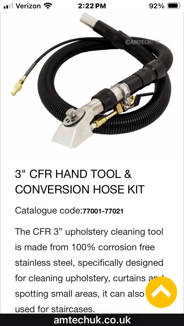

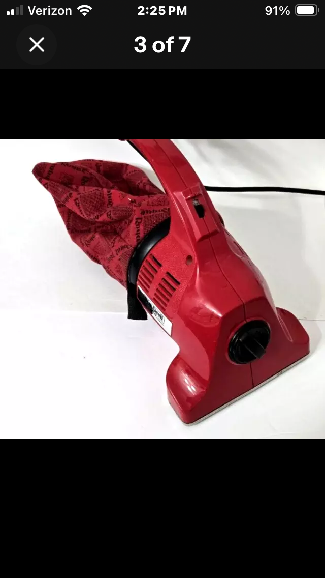

My method and Tools 1st step Hand Grandi Groom 2nd step vacuum with the older version of hand held dirt devil 3rd step Prespray agitate and use white towel to locate the dirt toweling away moisture 4th step is extract with acidic rinse using different sizes of the CFR tool extremely accurate ( I have sizes ranging 1.5 inches wide to 4 inches wide and also have formed a piece of plastic to adjust the opening of the tool to create the best vacuum so I am extracting not just wetting. The CFR tool extracts even if you’re not moving as long as you keep your vacuum bondI rarely rinse and extract the risers any more. Anytime I do try it just over-wets the bullnose and is really doing more of a disservice.

sounds like a lot of work. Im sore just from reading itMy method and Tools 1st step Hand Grandi Groom 2nd step vacuum with the older version of hand held dirt devil 3rd step Prespray agitate and use white towel to locate the dirt toweling away moisture 4th step is extract with acidic rinse using different sizes of the CFR tool extremely accurate ( I have sizes ranging 1.5 inches wide to 4 inches wide and also have formed a piece of plastic to adjust the opening of the tool to create the best vacuum so I am extracting not just wetting. The CFR tool extracts even if you’re not moving as long as you keep your vacuum bond
View attachment 129534 View attachment 129535
