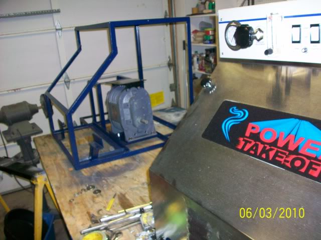

i'm taking pictures of the blower rebuild as well as a driveshaft rebuild too!
this one will be an econOgenie as there ARE used parts gonna be used!

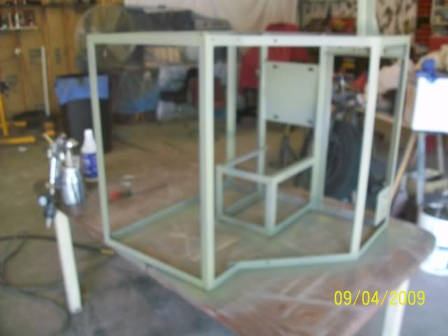

ya..i've had to build two or three frames so far........
these FOUR machines will be my LAST ONES i make......
me an' momma's gonna go an' has some fun...
before wez croak.............!
i THINK i made THIS frame...

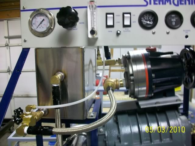

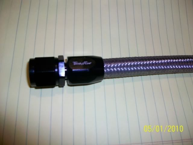

although in my opinion the DESIGN can NOT be improved on...
the components CAN...which is why i went wit the AN stainless aircraft quality hoses and fitting...non better than Trick Flow fittings...
and braided Stainless hoses..
show me ANOTHER machine that is aircraft quality????
The Genie uses Paraplate Pressure regulators
Paraplate is a major vender for NASA...and have many components in the space shuttle

Do you have those "Air Craft" hoses made for you, or do they come in a kit?
Sep 15, 2007
44,662
No...i make 'em mysef....it requires a chop saw..so's you don "frey" the ends...
perhaps i should show everbody how to put AN line together.......
much neater than a heater hose wit a clamp!

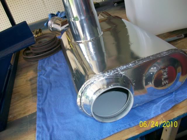

i got my ceramic parts back today....notice how the silencer is coated outside....
AND inside.....
