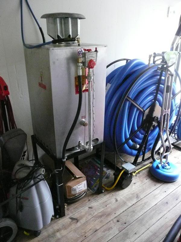

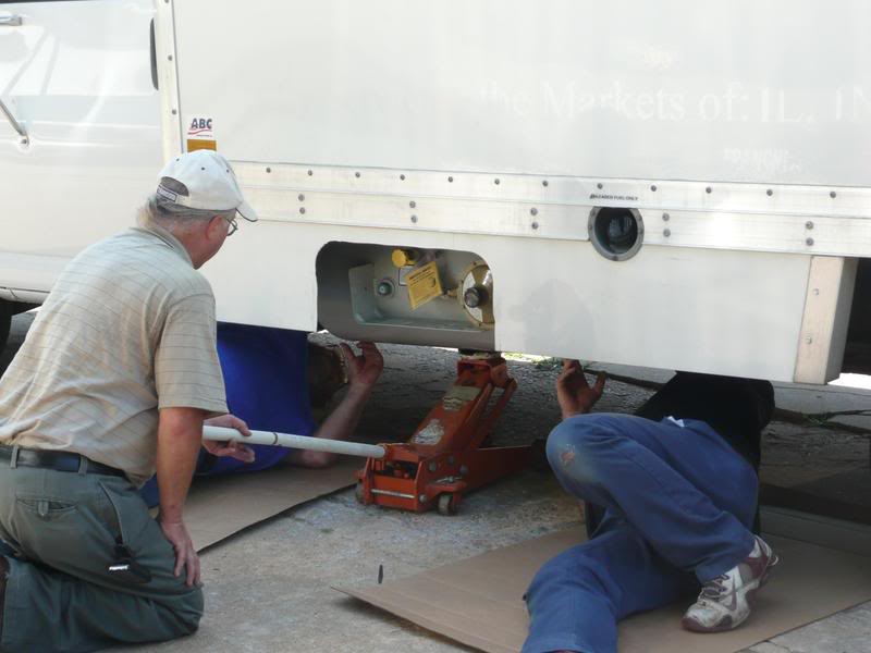

Remove the exhaust diverter, the Xentherm system, and the exhaust heat exchanger and resell these components to someone who has a Vortex for spare parts. I don’t know what these parts would be worth. What do you guys think they would be worth to someone for spare parts?
Install a large capacity propane tank. There is plenty of room for one on a box truck. A 40 gallon tank will give you more than 40 hours trigger time under commercial conditions. The price of the tank will probably be about $1,000.
I would leave the freshwater tank pre-heating system in tact but I would not leave it running at the 170 degrees as designed. I would install a lower temperature thermostat to limit its heating capacity to about 125 – 130. This will be a lot better for the life of the pressure pump. We also need to lower the temperature of the water entering the Little Giant heater so it doesn’t get too hot.
Then I would install a Little Giant #4 high pressure heater. The fuel consumption on this heater is .09 of one gallon of gas per hour under commercial carpet cleaning conditions and .05 under residential cleaning conditions. The cost of this heater is around $2,000.
Then there will probably be some miscellaneous costs of about $400 - $500 for brass and hoses. So the total conversion cost should be between about $3,000 - $3500. Then sell the Vortex parts you removed. Like I said, I’m not sure what they would bring, but I would guess probably $1,000 or more. After selling the parts the modification of the unit will probably cost between $2,000 and $2500.
