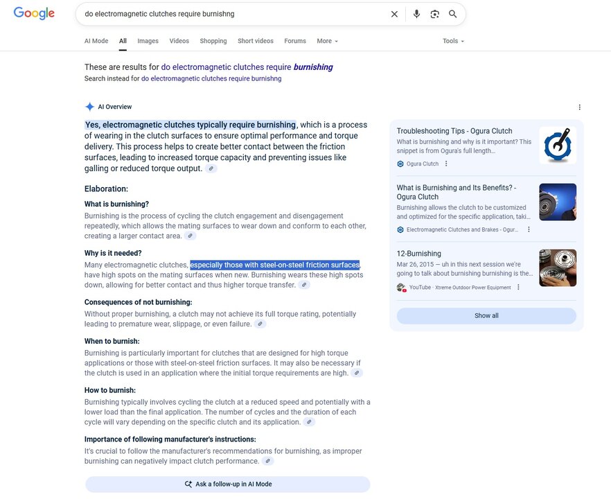

Getting ready to do my first clutch tomorrow. I'v researched everything I can find online. Engine off to burnish? Get it off with a bolt not a puller? Will I need to use a gauge or tape to set a clearance? Any helpful tips so I don't screw it up would be helpful. Got the clutch from Napa. Oh and someone said to turn on the pump clutch when burnishing the new clutch?
