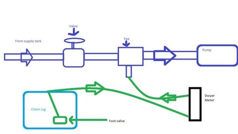

This is that solution
You slightly starve the pump by closing the valve a bit forcing the pump to draw from the chemical feed
You would be better off doing it the right way though

HOWEVER you don't need that proportioner valve.....and don't forget the footvalve that goes in the jug
Or it will back flow and overflow yor Chem jug...
OPPS....I jus blew up the pic and see
The foot valve.....
Very good Fred.....nice work......

Your pump will siphon the rinse from the tank..... there is no need for all the extra bs these companies add ...
Like Bob said , don't skimp on foot valves... northern tool has brass ones with a glass ball in them that we use...
Simple simple simple
You can buy a Dwyer with the flow meter (all one unit) so you don’t starve The pump as you limit the solution feed. It’s on “that side of the T fitting”. If that makes sense.
Yo
Meter is on the diagram. Starving the pump is what causes it to make up the needed water via the chem input. The pump isn't actually starved though.
Can you diagram what you mean?

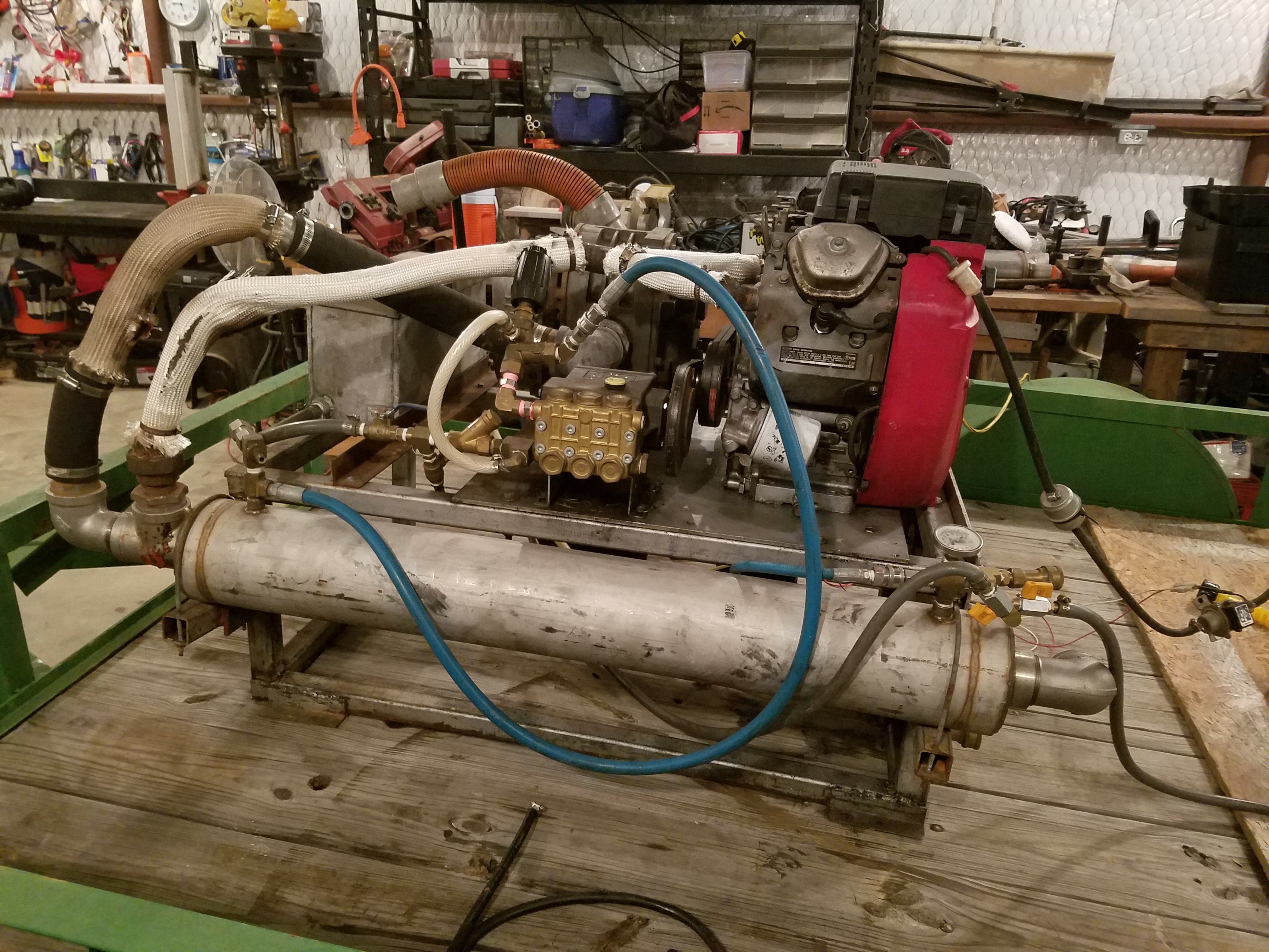

the previous pic shows the Y off the line going into the pump...this was the machine when I got it.
I hired Cobbs ex employee to build an new exhaust manifold ...move the pressure regulator to the front of the machine.
machine works good....I just want to add an injection system...i mean it pulling a # 4 blower and the same general pump cobb puts on his new machines
.....for $2,500....it works...not fancy like a butler...but...what areas it lacks in ...I make up for when I pull the T-Rex off the trailer.
